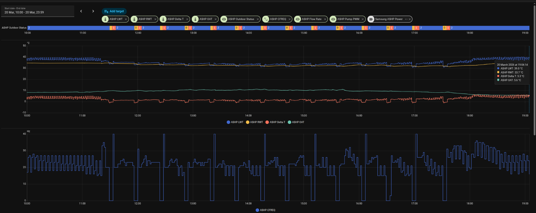

Enter Samsung TS. The guy wanted to revert the system to ‘standard’ settings on a WL of 15 30 with no uplift and pump PWM back to 100% #2093 4, he was not happy with my workaround and the comp oscillating, also not happy about the lower flow rates and wanted to ‘see it for himself’. Acccepted that my workaround manually modulating the pump had stabilised the system and put the workload onto the comp to regulate the LWT.
With the expected consequences. We left it running most of the day until I changed the pump limit to 70% because with the pump running pretty much at 100% it was noisy, can’t hear it at max 70% and then at 18:00 I added a couple of degrees uplift using the controller to get some heat in the house and hopefully stabilise it, time will tell. The Samsung guy was as baffled as I am about why the pump was not modulating 7mins 3 mins at thermo off as #2093 4 should do. It just stays on at full whack most of the time. By leaving the pump running at full whack, we get those cyclic fridge sessions where the DT is negative and the unit is taking heat out of the house. You can actually feel it happening, very weird. From 11:20 ish right through the afternoon, the pump never switches off. It does eventually ratchet down to 70% and then very quickly back up to 100%. He thinks there could be an issue with the PWM controller but nothing conclusive. Need to open it up and check all physical wiring etc. He has gone off to check firmware etc.
Pump should modulate on a 7 3 cycle at Thermo Off, which clearly never happens. So it’s ignoring #2093. I did a previous test of #2093 2, and it also did not stop the pump at thermo off. So maybe there is an issue somewhere. Hopefully with a 2 degree extra demand it should help to bring the system back up and stabilise it. Time will tell.
Anyway, I will continue, I am still trying to find the registers I can map for the Target LWT etc.

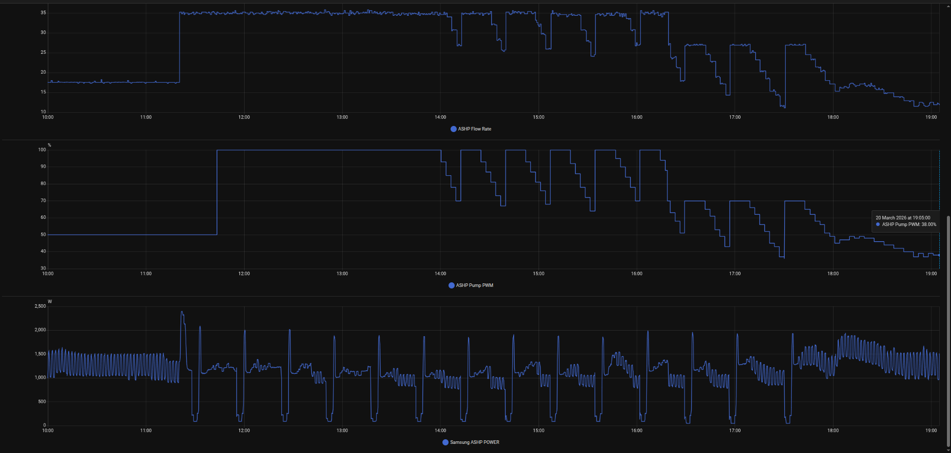

Yes via Modbus I mapped 8001 into the additional modbus address space registers 80+ along with things like Flow rate, Pump PWM Outside Air temp.
If anyone knows how I could map the WL Target Flow temp. The temp the Samsung is trying to get to based on the underlying WL settings. I cannot find this. It is one of the last pieces of the puzzle for me to write a more sophisticated automation to curb the antics.
Right now its pretty clunky but doing an amazing job. It looks at the moving averages for LWT RWT looking at the trend up or down etc. It then modulates the PWM up or down. Once the system is stabilised, DT ~5 it hands control back to Samsung. (All rads are balanced to DT 5).
I also have a couple of other automations that sets PWM to Maximum allowed during DHW cycle. Then after the short cycle switch to heating it caps the PWM at 40 for 30 mins. Stabilises the system and then hands control back to Samsung.
The other one looks for the cycle switch from 0 to 1 to 2, 3 mins later it modulates the pump to 40 for an hour then hands control back to Samsung. No more boom and bust cycles!
More importantly, the house is lovely and everyone is very, very happy. Samsung control not so much!

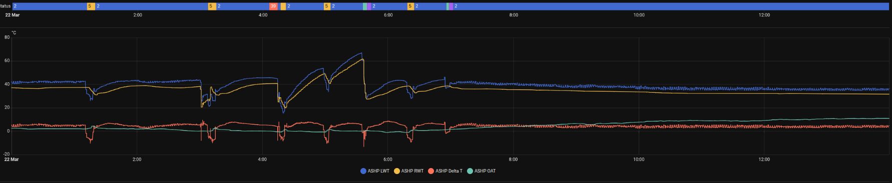

I just need to figure out why the DHW schedule did not happen. It was set for 3-4am but the system did not action it. I was up anyway and manually triggered it to ensure there was DHW for the house.
Samsung through the night, the DHW cycle and after. My automation following the last cycle off from around 7am.

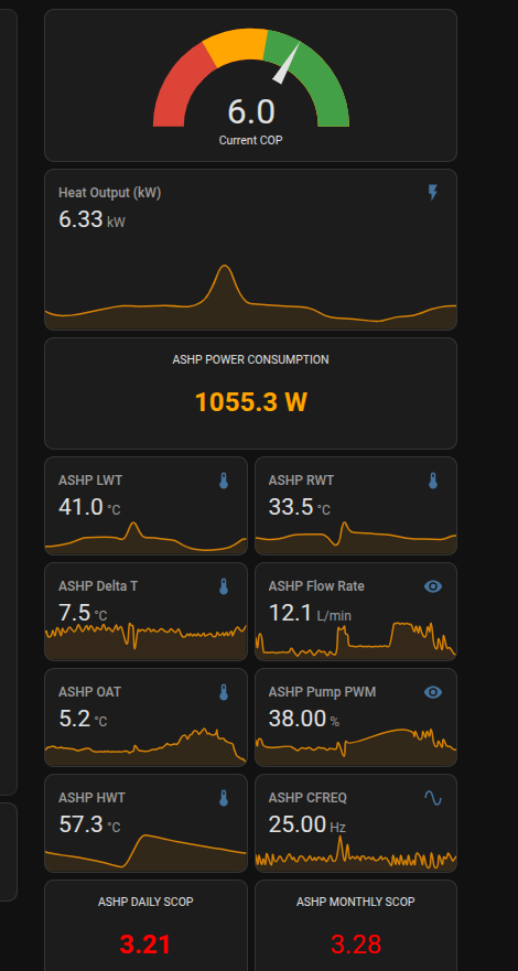

This is what I have in my Virtual sensor list: in case it helps anyone else just add this to your template sensor section:
