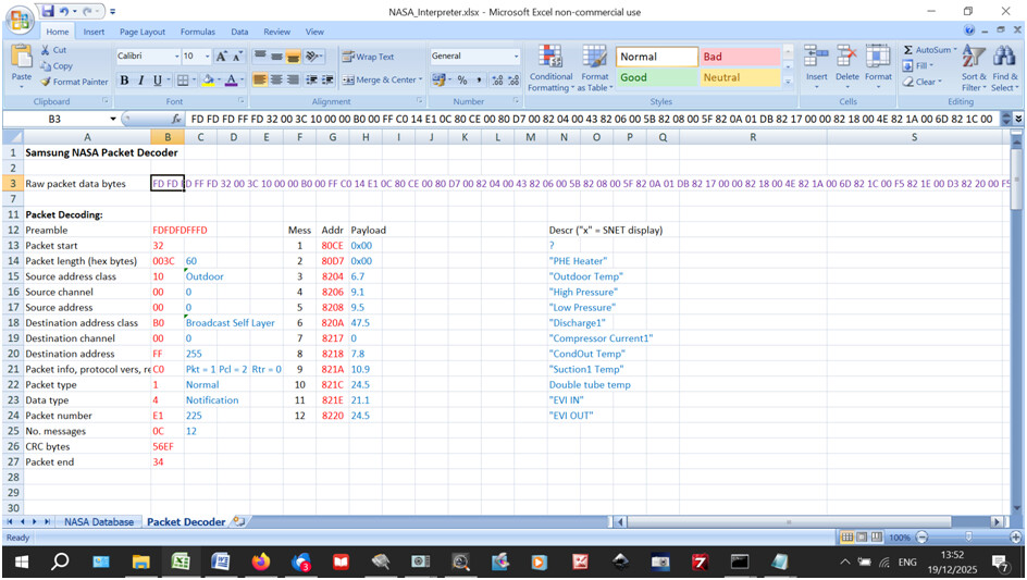

NASA Packet Decoder
I’ve added a simple worksheet to decode NASA packets and included this on a separate tab. This is based on the EHS Wiki NASA protocol disassembly document (posted elsewhere on this forum).
To use this decoder, simply paste a data packet into cell B3. The worksheet splits the packet into individual NASA messages and evaluates the payload for each.

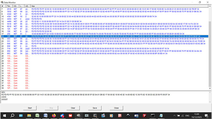

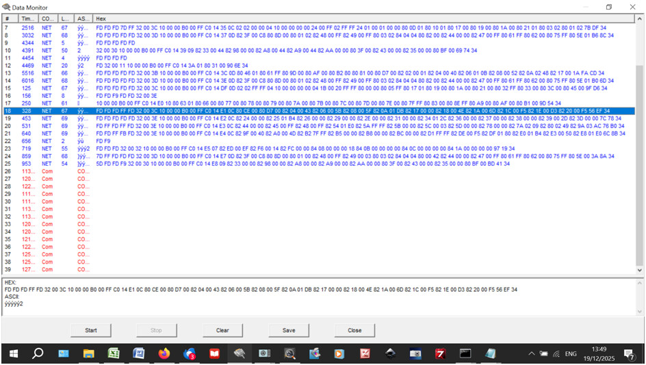

These packets can be copied from a VCOM monitor output. For example, copying Packet #18 from this VCOM output…
…and pasting it into cell B3 of the worksheet, results in this decoding:
(Obviously the compressor was not running when I took this screenshot – suction and discharge pressures are roughly the same, and the compressor current is zero.)
