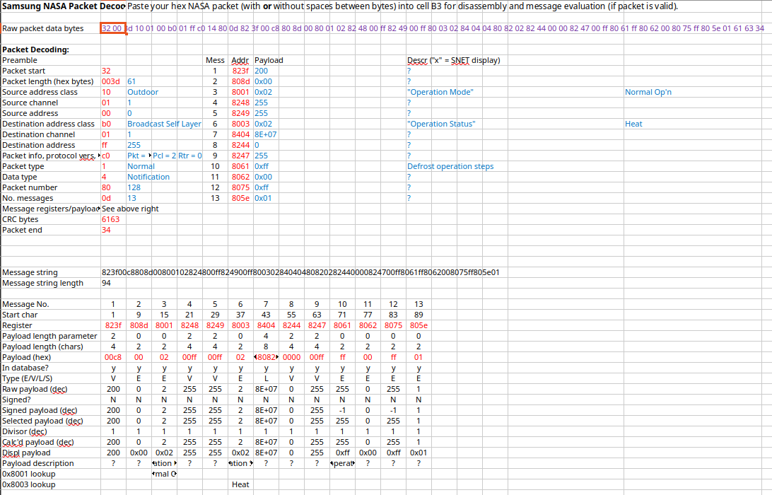

@pantherale0 Just to feedback I have a connection. Now to start the next learning curve and understand what I can do with it and HA.
I wrote a small test program to confirm I can see the message stream.
32 00 3d 10 01 00 b0 01 ff c0 14 80 0d 82 3f 00 c8 80 8d 00 80 01 02 82 48 00 ff 82 49 00 ff 80 03 02 84 04 04 80 82 02 82 44 00 00 82 47 00 ff 80 61 ff 80 62 00 80 75 ff 80 5e 01 61 63 34
Using Sarahs decoder I see this, so assume I have a clean connection.

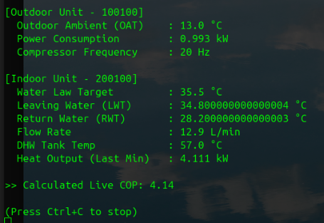

import asyncio
from pysamsungnasa import SamsungNasa
# Mapping discovered from your CLI 'device dump'
# Key: (Decimal_ID, Label, Unit)
INDOOR_MAP = {
    17023: ("Water Law Target", "°C"),
    16952: ("Leaving Water (LWT)", "°C"),
    16950: ("Return Water (RWT)", "°C"),
    17129: ("Flow Rate", "L/min"),
    16951: ("DHW Tank Temp", "°C"),
    17446: ("Heat Output (Last Min)", "kW"),
OUTDOOR_MAP = {
    33284: ("Outdoor Ambient (OAT)", "°C"),
    33811: ("Power Consumption", "kW"),
    33336: ("Compressor Frequency", "Hz"),
async def main():
    # Initialize connection to your Waveshare
    nasa = SamsungNasa("192.168.0.136", 8000, {"device_addresses": ["100100", "200100"]})
    await nasa.start()
    try:
        print("--- Samsung ASHP Live Monitor (3.6 Setup) ---")
        print("Waiting for data broadcast...")
        while True:
            await asyncio.sleep(10) # Update every 10 seconds
            output = []
            thermal_power = 0.0
            electric_power = 0.0
            # Process Outdoor Unit (100100)
            if "100100" in nasa.devices:
                out_dev = nasa.devices["100100"]
                output.append("\n[Outdoor Unit - 100100]")
                for mid, (label, unit) in OUTDOOR_MAP.items():
                    val = out_dev.attributes.get(mid)
                    val_text = f"{val.VALUE} {unit}" if val else "Waiting..."
                    output.append(f"  {label:<25}: {val_text}")
                    if mid == 33811 and val: electric_power = val.VALUE
            # Process Indoor Unit (200100)
            if "200100" in nasa.devices:
                in_dev = nasa.devices["200100"]
                output.append("\n[Indoor Unit - 200100]")
                for mid, (label, unit) in INDOOR_MAP.items():
                    val = in_dev.attributes.get(mid)
                    if mid == 17446 and val: thermal_power = val.VALUE
            # Calculate Live COP
            if thermal_power > 0 and electric_power > 0:
                cop = thermal_power / electric_power
                output.append(f"\n>> Calculated Live COP: {cop:.2f}")
            # Clear screen (optional) and print
            print("\033c", end="") # Clears terminal for a clean dashboard look
            print("\n".join(output))
            print("\n(Press Ctrl+C to stop)")
    except KeyboardInterrupt:
        print("\nStopping monitor...")
    finally:
        await nasa.stop()
if __name__ == "__main__":
    asyncio.run(main())

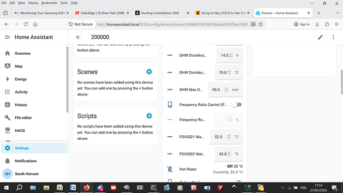

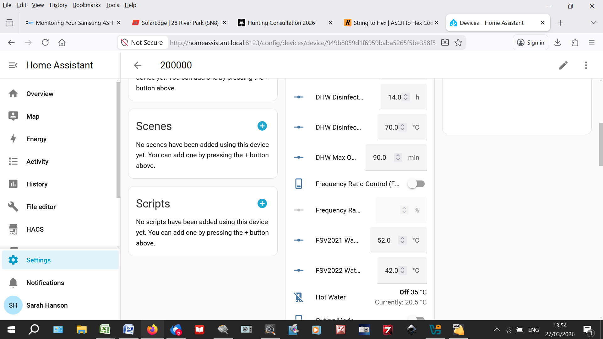

@pantherale0’s HA integration specifically provides (at my request) the capability to change FSV#2021/2 (just so I can run different WL settings at night, just like you are trying to do):
Have you actually tried them yet? They work fine on my HTQ :slightly_smiling_face:.
[Edit: Interestingly, changing FSV#2021 from 52degC to 50degC using the HA Integration shows up on my proxy as an Incoming packet (see above) but with no associated Outgoing packet:
