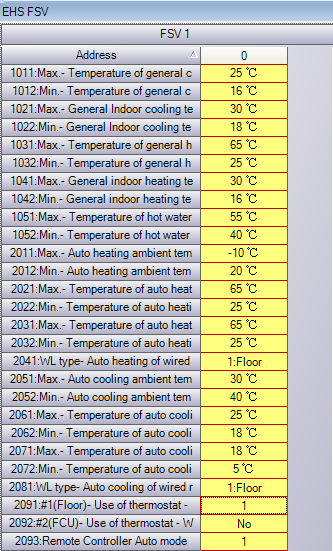

  • The Home screen shows current values of several controller inputs (mainly instruments) and outputs (e.g. inverter frequency, EEV/SOV positions) updated every few seconds.
  • The tabs near the bottom allow access to Outdoor Unit variables (mainly refrigerant-side) and Indoor Unit variables (mainly water side).
  • The Trend/Graph tab allows you monitor selected parameters against time (though I have not used this yet).
  • As soon as you start SNET, it starts populating an Excel spreadsheet at the frequency you set on the Options button. If you have the default frequency set (10s), this can quickly result in a very large file. If you want to suspend this logging, hit the stop/start button at the top of the screen.
  • The spreadsheets are named by the time of start of monitoring, and are stored on your computer under Documents/SNET-pro2/RecordData with separate folders for each date that SNET has been used. This spreadsheet capability is very powerful:
    • It allows you to trend one variable against another using Excel’s graph building tools (as opposed to trending only against time, as most OEM tools do). For example, you may wish to see how inverter frequency (i.e. compressor speed) affects compressor current (thus power consumed) in order to inform your decision on running in Quiet Mode (which runs the compressor at about 60% of normal).
    • It allows you to add your own calculations based on the measurements. For example you could use LWT and RWT (reported on the Outdoor tab) and water flow (reported on the Indoor tab) to calculate the ASHP heat output at the time interval you have set in Options.
    • It allows you to analyse various controller algorithms with a little reverse engineering. For example, you may see that the compressor recycle valve opens immediately the compressor stops (to equalise refrigerant pressures in the circuit, so preventing reverse flow through the compressor), allowing you to surmise that the temporary DT reversal in LWT and RWT seen following compressor shutdown may be due to flash cooling of liquid refrigerant in the condenser.
  • The main downside of SNET is that it doesn’t show Outdoor Unit energy consumption, so CoP cannot be calculated.
When you examine the recorded Excel data, you will be presented with a screen like this (the data extends well beyond the screen – this is just the top-left corner):

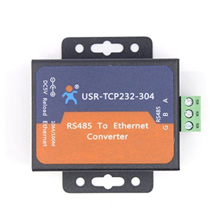

Hi,
There is also possibility to connect you heat pump through your private network, here is a tutorial and settings using a serial-to-ethernet adapter (USR-TCP232-304) that worked for me (using SNET pro 2)
It allow to read all parameters inside the software and also to perform maintenance operations.
It involves the following steps:
1) Plugging the adapter to F1/F2, power supply, and PC
2) Setting up adapter IP address
3) Creating a Virtual communication port (VCOM)
  1. Plugging the adapter
  • Adapter has two ports A → F1 and B->F2
  • Connect power supply
  • Connect ethernet to your computer

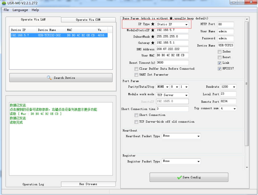

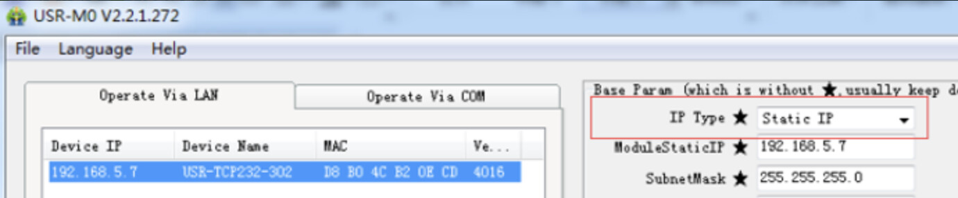

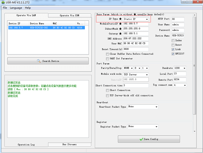

  1. Setting up adapter IP address
    The unit has a default static ip (192.168.0.7), if you want to connect it to your home network you need first to switch it to DHCP mode (or keep “Static IP” but choose an ip suitable for your network operation)
  • Install USR-MO ([Setup Software] USR-M0 V2.2.6.1.exe and open it
  • Change ip config of your computer to a static IP address 192.168.0.X (192.168.0.1 for example)
  • After clicking “Search device”, change from “Static IP” to “DHCP” or choose an IP suitable for your network.
  • Save config
  • Put you computer IP config computer back
  • Plug the adapter to you home network, power off-on adapter, after restart it should be reachable on your brower, on the ip address you chose (or the IP your router DHCP attributed)

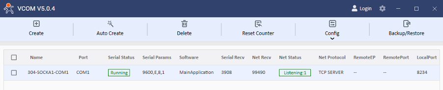

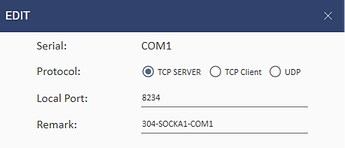

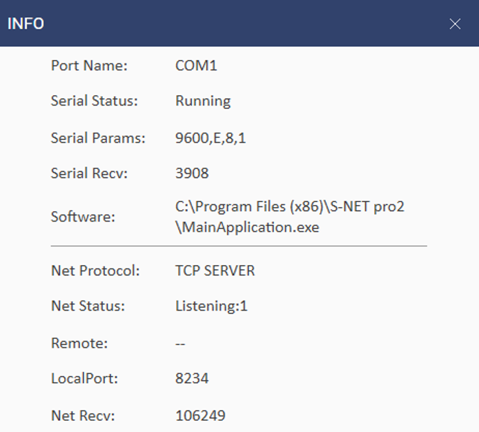

  1. Creating a Virtual communication port (VCOM)
    You need to create a virtual COM port on your computer (VCOM) for SNet Pro 2. This virtual port will create a connection between your computer and USR-TCP232-304 adapter through your network. SNET will “see it” as a physical COM port (as if it was connected to a USB adapter)
  • Install [ Virtual COM Software]USR-VCOM_V5.0.4_Setup and open it
  • Using “auto create” it should find the adapter on the network and configure it automatically

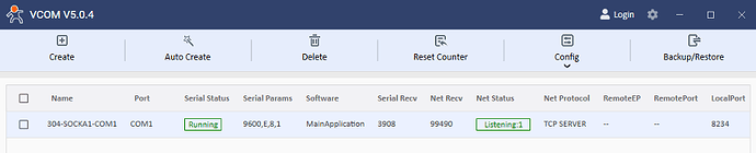

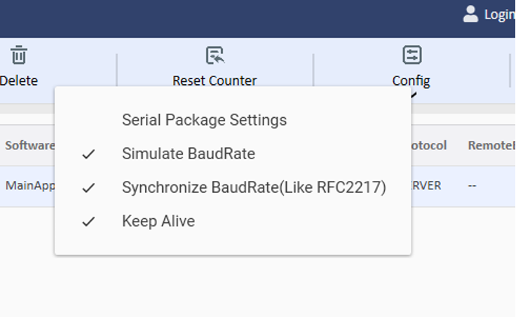

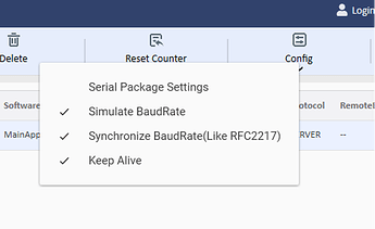

    If not I added some screenshots of my current configuration
    By default, it will use the TCP server mode which works well for me.
    You will need maybe to check the port parameter

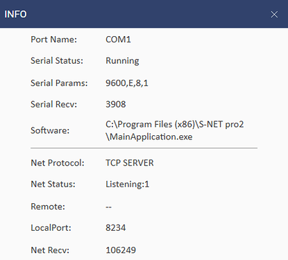

Baudrate should be 9600 but there are some features to auto detect it

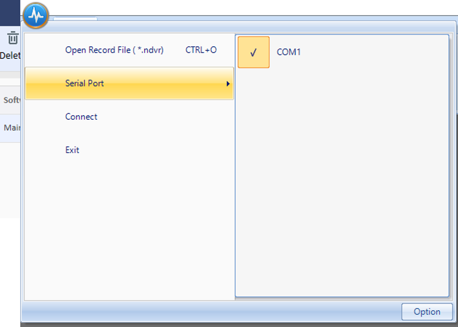

Open SNET pro 2 , COM port should appear
After clicking “Connect” you should have a flashing Green/Yellow light means it’s communicating
Helpful post @NielsM, though…
…might baffle readers unfamiliar with some of the terms.
Can you tell us how to switch the unit to DHCP (and why you might want to, rather than selecting a static IP), and how to go about the latter. (I found - by accident - that selecting 192.168.1.7 worked OK for my USR-TCP232-304, but assumed that this was because the third octet of my broadband router - to which I was connecting it - was also 1.)
IP address allocation is a mystery to many - is there an idiot’s guide to this?
Of course !
If you select dhcp, the adapter will get an IP from you router dhcp ip range, you’ll then have to find the IP (go on your router’s webpage for example)
The router may change this IP address in the future.
If you decide to assign a static IP, then it all depends if the devices are on the same sub network or not.
Let’s say your router (192.168.1.1) has a network mask of 255.255.255.0
This network mask means the router considers that only the IP’s with 192.168.1.X can talk to each other (the “hosts” part)
The adapter (192.168.0.7) is considered on another sub network (noted 192.168.0.0/24 that means all addressed from 192.168.0.1 à 192.168.0.254) so it won’t be able to communicate with any device on your network
It would work if for example you change your network mask to 255.255.0.0, in this case all addresses from 192.168.0.1 to 192.168.255.254 would be able to communicate.
By default subnet mask 255.255.255.0 is configured to keep the “hosts” part small for a lot of reasons (performance, security…)
Without changing the subnet mask, choosing 192.168.1.2-254 would work.
To switch the unit to DHCP you need to select it on the drop down list

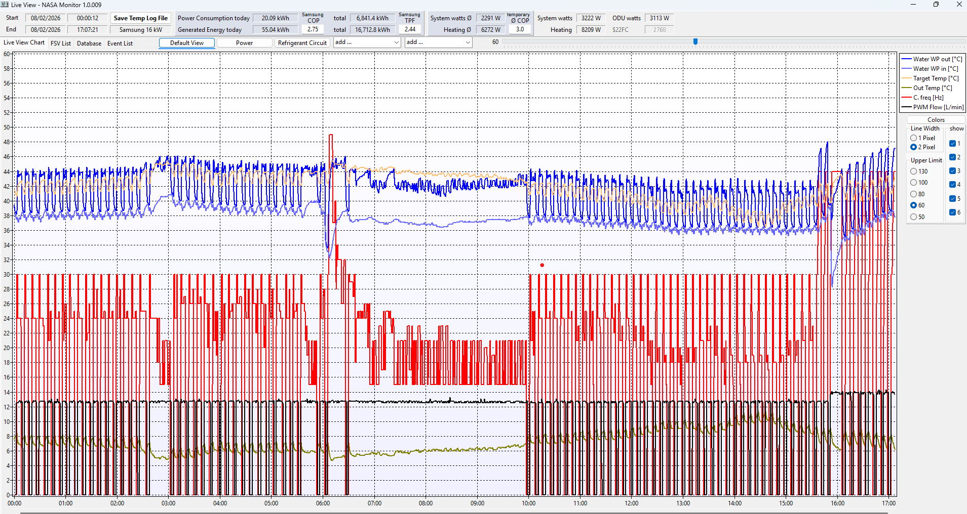

Wecome to the forum, @hank31980, and glad to hear that you found something useful in this thread.
May I suggest that as a first step you try out NASAmonitor, using it to just watch what’s going on in real time. You can run it in place of SNET (just configure it to the same COM port that you use for SNET), or at the same time as SNET if you set up separate COM ports for each. See Samsung ASHPs: Review of NASAmonitor – an Alternative to SNET-Pro2 for setting it up.
The software has its limitations, but I find that by flipping between the default view and the energy view I can get a good feel for cause-and-effects, and the CoP data displayed is also useful (you get currect - i.e. last half hour or so - and over the whole display period and over the HP’s lifetime).
Beyond minimising your LWT (consistent with comfort of course) there aren’t many operating parameters that are universally agreed to be ideal, because individual requirements vary. Don’t lose sleep over getting perfection immediately - just watch the data come in for a week or two and you’ll soon get a feel for which (preferably minor) FSV adjustments work for you and which don’t.
Ok, thanks for the reply, good to know that there isn’t just a known set of parameters I should be using to achieve good ASHP performance. Sounds like Im at the beginning of process to try and optimise my own setup. However as you suggest, I will now check out this NASA monitor to see what that gives me. It has certainly been a revelation so far to just be able to see some of the workings of the ASHP using the S-Net software. Thanks for your valuable input so far, your explanations were very clear and gave me the confidence to give it a go.
Wow, I have just downloaded/installed NASA monitor and it is next level info………..thanks for the heads up. At least I can see current performance and try and understand what tweaks to the system might bring some improvements.
Complete gamechanger, first of all getting access to my Samsung ASHP using S-Net, so that I can easily access and change/download system parameters and secondly using NASA Monitor.
I have now hooked up the PWM output of the controller to my Main ASHP circulating pump (Grunfos ALPHA2).
Now because I can monitor pretty much everything that is going on I have now decided to run the system 24hrs a day. With the small tweaks Ive done already Ive improved COP from 2.4 to 3.1.
I use the inbuilt Weather Compensation, and use Water Outlet Temp as control element.
Im just so happy the system is doing something I want, which is delivering steady room temps throughout the house.
The system seems to tick over at the moment at around 1.5kW of input power and is outputting around 5kW of output heating power.
Outside temp is around 6degC but house is toasty with Water output of around 44 degC.
I’m amazed as this slow steady heat, even with radiators seems to be so much better than my previous boiler and now so much better than my original setup with the ASHP.
I set my TRVs downstairs to have permanent setpoint of 22 degC and upstairs I scheduled daytime of 22 degC but night-time of 19 degC so far this works well.
That’s good progress, @hank31980 :slightly_smiling_face:.
As long as your HP doesn’t cycle more than about 2-3 times per hour, you’re well on track.
There is a general consensus that opening TRVs wide (and simply :face_with_diagonal_mouth: balancing your radiators’ heat output using the LS valves at the other end), allows you to reduce LWT still further and reap the extra CoP rewards that this brings through reduced cycling and minimised compressor speed (thus energy consumed).
But things may not be quite that simple. Most refrig circuits are actually more efficient when running at full output than when trundling along at half speed or whatever. (Chat GPT reckons 20-30% difference typically).
So (counterintuitively) it may be more economic to run flat out for half an hour and stop for half an hour, than running continuously at 50% speed. (This assumes that your house doesn’t cool down too much for comfort during the “off” period.)
By all means play around with different strategies, but my advice would simply be to keep an eye on the electricity meter - a little cycling may actually be saving you money, no matter what the CoP meter is displaying, because each “on” period starts with the compressor running at a higher efficiency.
Nobody said that this path was easy…
Yeah it’s early day in my quest for a steady, reliable working system that in future requires less tinkering.
I’ve not engaged Quite mode at the moment , so it’s got full power available, but not sure how I could drive the ASHP harder to bring on some occasional cycling?
This is critically dependent on your FSV#209* settings, as they effectively define which devices play a part in starting and stopping the compressor and thus cycle frequency/severity. (See elsewhere on this forum for setting details if you need them.)
If you elect roomstat-only compressor switching (#209* = 1), the “on” and “off” durations depend only on the roomstat hysteresis (if you have it) or the TPI cycle rate (if you don’t). These in turn depend on the ratio of heat emitted from your radiators (which depends on your LWT) to the heat loss from your house (which is essentially fixed for any given room temperature and OAT). Changing the hysteresis or TPI cycle rate will directly change the compressor cycle frequency, which allows you to decide how often/hard you want to run your compressor to get the lowest running cost.
But if #209* if set to 2-4, either your roomstat or attainment of LWT target may start/stop the compressor (whichever happens first), so Water Law may also start/stop the compressor. The User Manual describes the WL setting details, but in summary the compressor will also stop if it can’t keep LWT on (or more exactly, about 2degC above) target even at minimum speed (which itself appears to depend on factors like OAT), and starts again once LWT has dropped below target (the default hysteresis is about 2degC but this can be reset to other values if your PCB allows access to FSV#106*). There are also timers involved to ensure that rapid restarts are prevented. You will have seen on SNET/NASAmonitor that the controller applies a Safety Start algorithm for the first 5 minutes or so after start-up, with compressor speeds following a pre-programmed pattern. Once the Normal Operation algorithm kicks in, inverter frequency is set according to the approach of LWT to target. This typically results in compressor speed reducing to minimum where it sits until the ~2degC target overshoot occurs, when the compressor stops.
To summarise: The main knobs you might want to twiddle are the #209* settings and (if set to 2-4) #2021/2 to adjust the WL effects. The optimum depends on your exact set-up, but you now have all the tools you need to experiment :slightly_smiling_face:!
Having monitored my system today it looks like it is cycling around 6 or 7 times per hour, not sure if that is a good or bad thing.
So as you suggest I will have to do some homework around my existing FSV#209* settings and where I may then tweak things to see the results.
…a very bad thing, @hank31980 (if you value your heat pump).
At first glance you are putting far more energy into the water than your emitters are taking out, so you are contunually bumping up against your WL target.
I suggest you immediately set your #2091 (if 3rd party roomstat) or #2093 (if WRC roomstat) to 1, and see if that improves things.
We can take a closer look tomorrow…
Sarah
Hi Sarah,
Thanks for your reply and “heads up”…I definitely need some help/advice here as I’m struggling a little bit with the system settings.
My main goal is to have the system running 24/7, but just gently delivering heat so the rooms just gradually warm up and maintain something like 21 degC.
By the way, I don’t currently use the Indoor unit as a thermostat because I use a 3rd party Thermostat connected to B22 (Zone1: Heating) on the Main controller card, so because of this configuration, I believe that 2091 is the parameter that I should change to 1?
And if I understand you correctly, with this 2091 set to 1, the compressor should not shut down via Water Law Temp control, but instead it should run constantly, regulating the Water Outlet Temperature around the WL Setpoint and the only way the compressor will shut off is when my 3rd party thermostat switches Off.
I have switched the ASHP off tonight and will restart it all in the morning.
