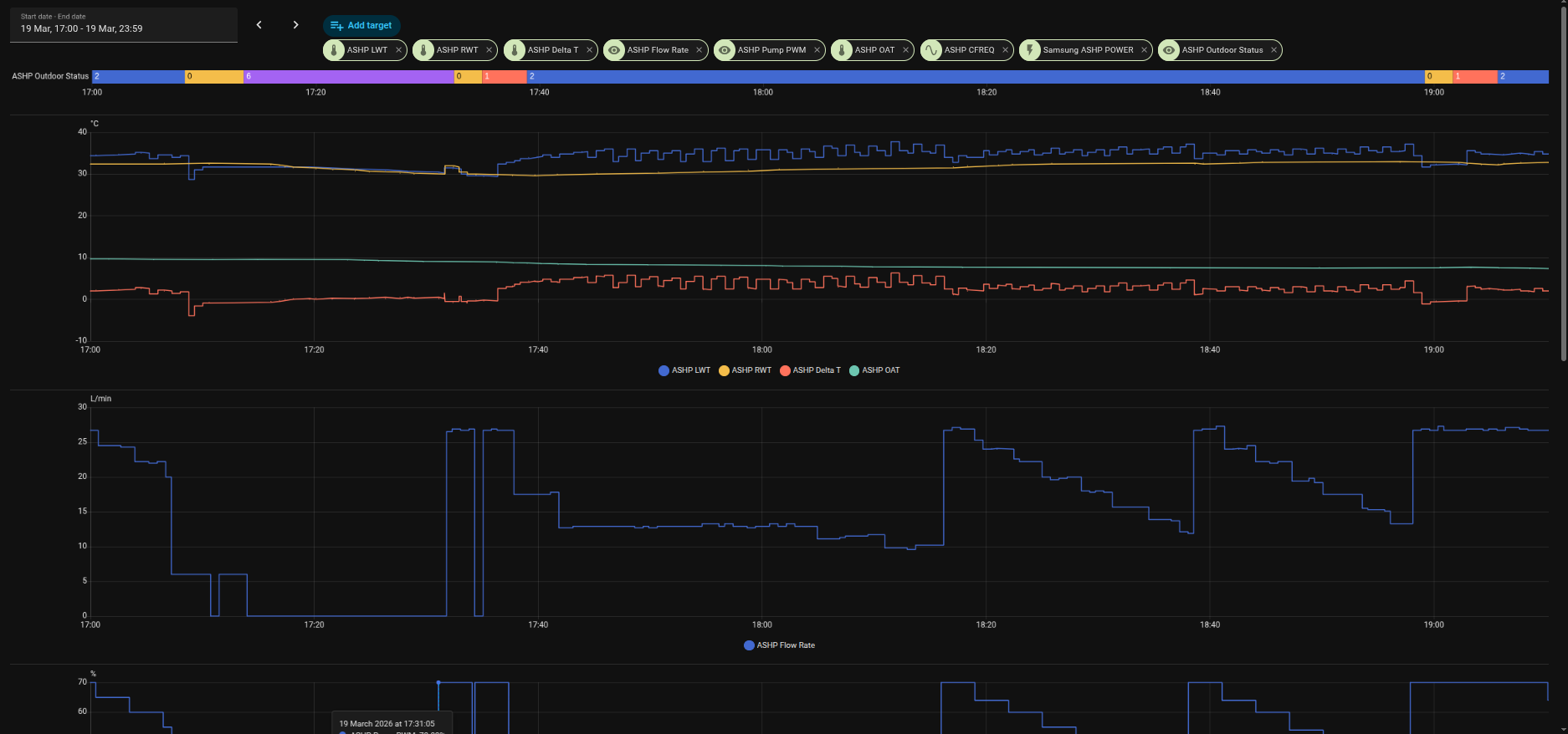

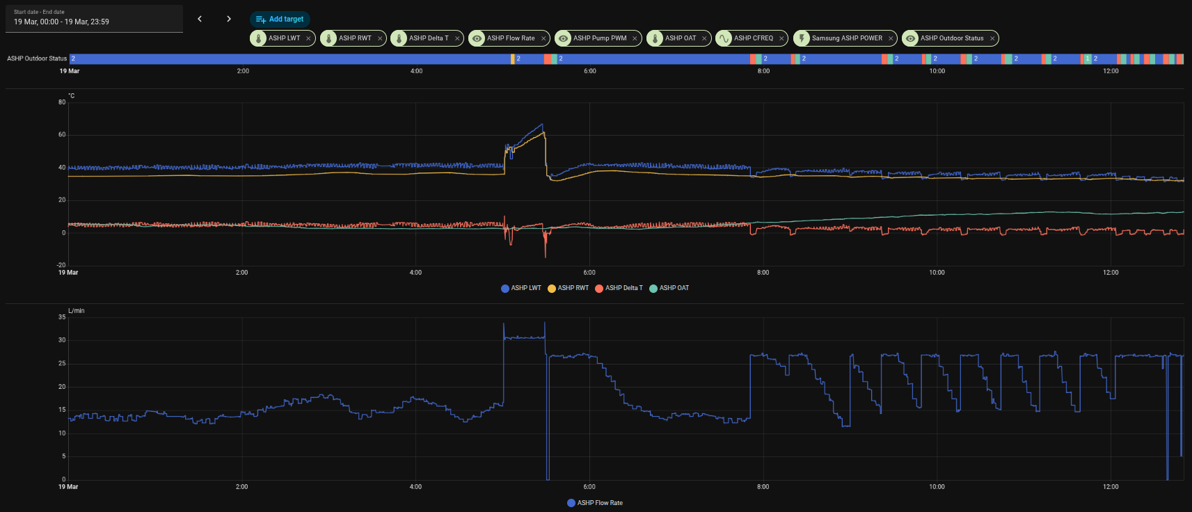

Today we have much the sme nonsense with the Samsung logic creating a degenerative cycle. I ran the system overnight and till 12:00 on the same -7 50 15 35 just to see if it did the same thing. It did! this whole cycle is created by the samsung flawed logic. On the graphs you can clearly see that at 07:50 the system started acting weird. The trigger a tiny change in OAT form 5.9 - 6.1 Degrees. The Comp went to Zero but catastrophically the pump went immediately to max output which then created a situation when the DT collapsed to negative 1.6 and then the cycle of boom and bust started. Had the pump just stayed bumbling along in the mid teens as it had done all night wiht a lovely DT of around 5 the rads would have had time to keep a healthy DT going.

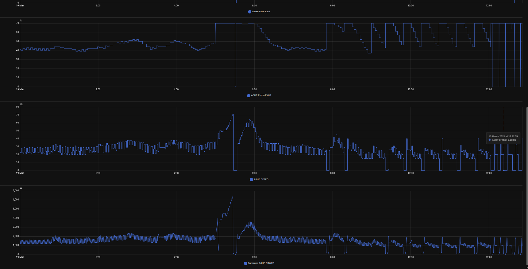

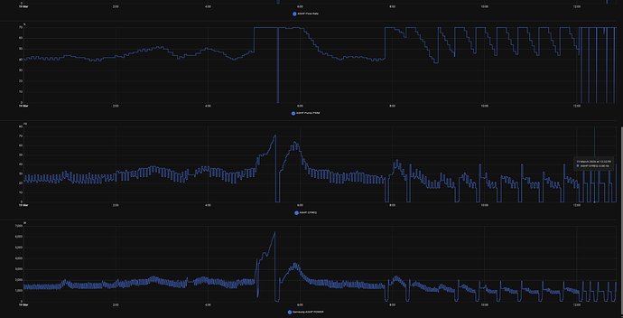

Here is a technical analysis and the graphs. The pattern is very clear. The pump is racing the water around not giving the system time to shed the heat and returning almost as hot as it left or even hotter collaping the DT. Then the system realising it needs to reagain the DT fires up the comp again it panicks and pumps energy into the sytem it doesn’t by firing up the comp again using a lot of totally unnecessary energy into the system making the situation worse due to the overshoot. Now we have even more thermal energy in the system we have to get rid of. The RWT comes back high the DT collapses again. And around and around.
The root cause the Comp going to Zero on a very small OAT change and the pump going to max triggering a cascade and tanking the system COP for hours.
I changed the WL to lower the tail from 15 35 to 15 30 at 12:00 to try and stabilise the system for operation in a higher OAT. Here is a very graphic representation of the issue.
We are at Thermo off because the target LWT is reached. BUT the pump is still raging around!
I have included the raw data FYI and my analysis.

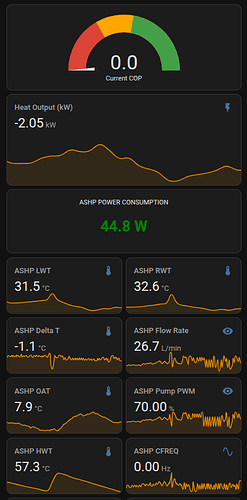

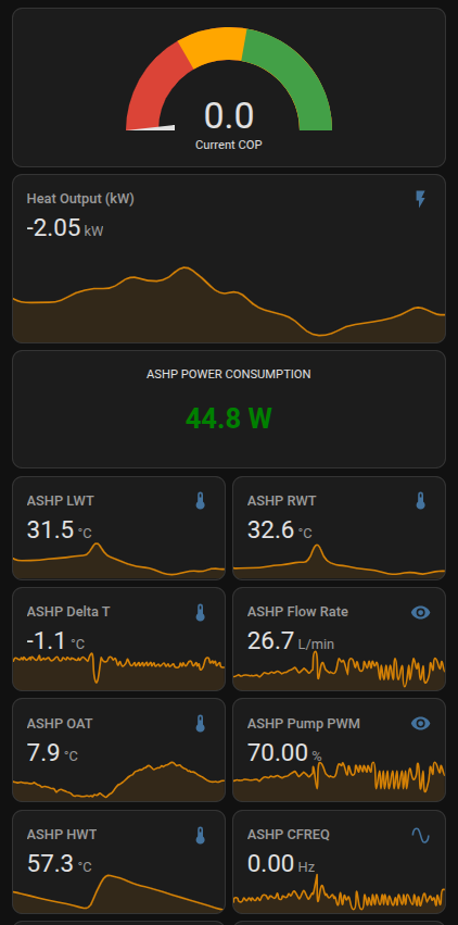

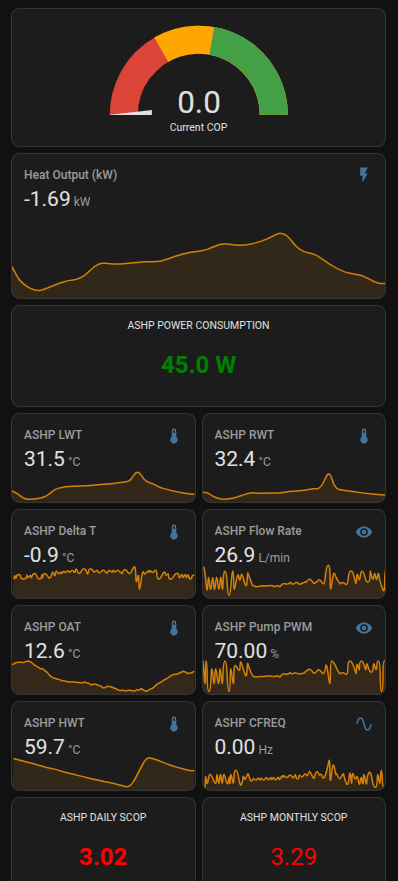

Heres a picture of me vs Samsung. Stabilised then Samsung slowly crippled the system and triggered a cycle. It’s still trying to stabilise it but with the pump at 100% it has no chance. My other option is to give it some more headroom by lifting the curve up 1-2 degrees.
Here’s a perfect illustration of the issue. Pump running at max and RWT higher than LWT etc.

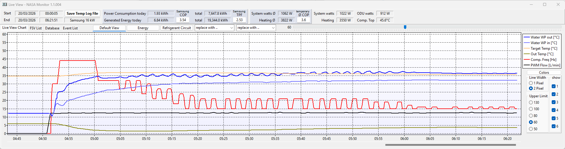

I have Silent Mode enabled between 22:00 & 06:00 just to limit the Compressor frequency (therefore noise level) in the middle of the night, in case my system kicks in.
I too have selected PWM of 70% via one f the FSV’s and this seems to work well, I run with a Primary ASHP flow of around 12.5 l/min. I think I should probably try and improve this, but Im more interested in the system just working for now.
This is my system starting at around 04:50 this morning, RED line is Compressor frequency, so you see it initially spike for about 10 minutes then gradually start to drop back. It has some oscillations, but the general trend is going down.
You can see that the LWT & RWT “BLUE lines” are doing and you can see that about an hour from cold startup, I’m operating a little above the WL setpoint “YELLOW line”.
However the system is happy and just keeps chugging along, but if you notice, the Compressor frequency keep dropping back as does the Fan speed and I know will eventually become a flat line sitting at 15Hz, same as the Fan speed sitting at 390rpm.
Because of my poor system design (ASHP oversized & Emitters undersized) then during the day, the LWT keeps gradually rising and will most likely end up about 4 or 5 C above setpoint, but my Internal Thermostat will eventually exceed Room setpoint and switch everything Off, allowing LWT & RWT to dissipate heat and maybe 3 or 4 hours later, the Room stat will call for heat and the whole process repeats.
Its not perfect, but for now, its stable and I have time to think about improvements.

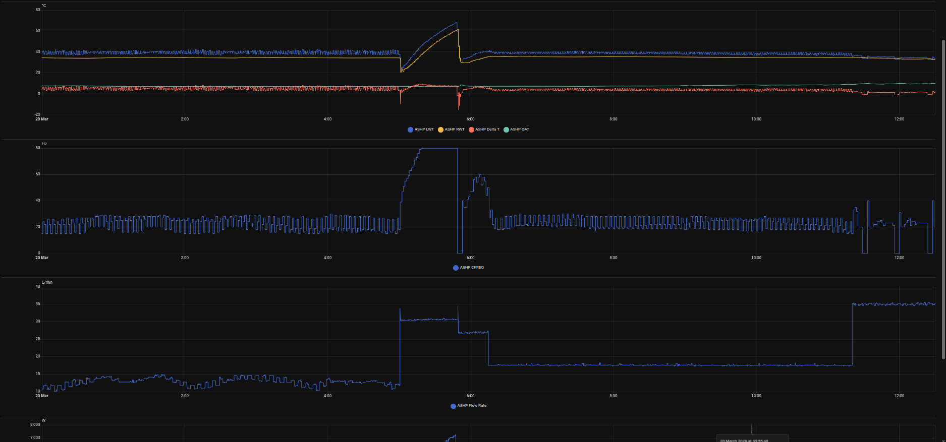

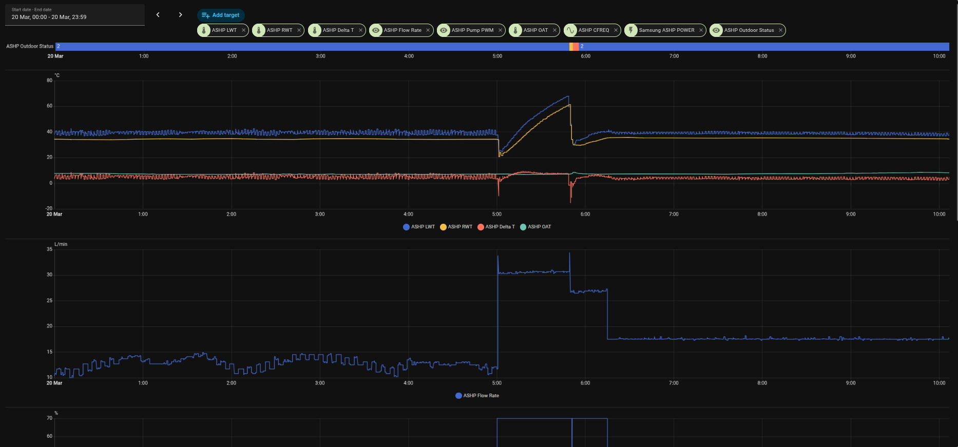

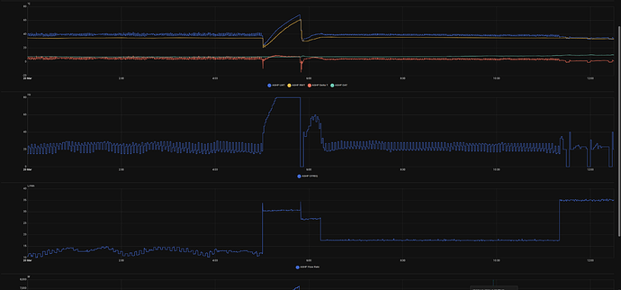

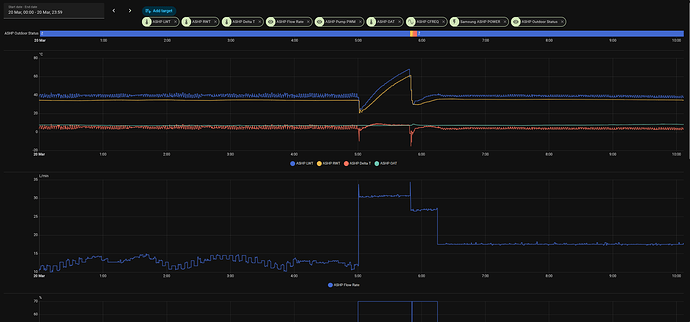

I wrote an automation last night to modulate the pump down after a restart to avoid yesterdays nonsense.
Here is the result! My automation took over at 06:14 following the DHW cycle and what would have turned into exactly the same behaviour as yesterday. By modulating the pump down the system was stabilised within a few minutes and a healthy DT established and comfortable property. I manually added 4 degrees last night to get the property comfortable then left it to see what would happen. The underlying WL is -7 50 15 30 +4 Deg on the controller. I deliberately set the DHW cycle for 05:00 - 06:00 just to see the recovery as the OAT are rising. It is back to 03:00 - 04:00 from tomorrow.
The data doesn’t lie. Its a picture of health. I am sure I can tweak it further but right now I can’t find the Modbus register for setting the Water Outlet Temp for a Gen 7 Integrated unit. So if anyone knows what it is and any other hidden or changed registers I would appreciate it.

@SarahH to your points I understand the principles. However the empirical evidence from this exercise is that on our system; maybe someone else’s is different, what happens in reality is the Samsung keeps the pump at ~max and that leads to a rise in RWT that collapses the DT the Samsung panics because it has a target DT and pumps in a load more energy to create a positive delta. Then the pump keeps running at max and the cycle repeats getting gradually worse raising the system temp and to your point making the problem unsolvable unless the system is given head room to recreate stable running.
I watched it happen in realtime. We had already set the pump to 70% max rate overall last week. It was better but not by enough to create stability except when really cold outside then it was somewhere in the vicinity of stable with a lower amplitude of change.
Modulating the pump down immediately gave the system time to do its job and radiate the heat. Radiators are not magic then need time for the thermal flow to offload the heat if you are speeding through them they do not have enough time to do that the RWT returns high and the Samsung then reacts to try and maintain a positive DT. How do I know this? The RWT stopped climbing and the DT was restored quickly LWT was also stabilised ~set point Reaching a balance point quickly. Right now its a pretty dumb automation that once stabilised gives control back to the Samsung to manage the pump, it does but on the high side with RWT rising, but a lot more slowly.
That is the reality of our system, it is what we see in the data and feel in the environment.
