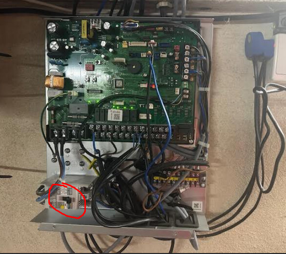

I can give a little information, including a DONāT DO THIS warning, based on very recent harrowing experience.
As you know, I use SNET-Pro2 to monitor my AE080BXYDEG/EU (the EHS Mono Low Temp aka HTQ). The downloadable version of SNET is 1.13.9, but UK Helpdesk recently sent me an updated version 1.14.3. SNET displays all the available FSVs which you can modify from your laptop, and I noticed that the new version now included (for example) #1061/2/3/4 (hysteresis settings for LWT and roomstat), but SNET wouldnāt let me change them as my firmware did not support them.
The Helpdesk advised that my firmware could be updated to suit the new SNET, either using a MIM-C02N (which costs about Ā£200) or by direct file upload of a hex file they sent me, using an SNET option (though the latter would be at my own risk). As I didnāt own a MIM-C02N I decided to risk the file upload. MISTAKE! It irretrievably jammed my controller and (maybe a coincidence) clobbered the controller in my water circulation pump.
Helpdesk then told me that I would need to replace the whole MIM-E03EN circuit board and gave me the required Part No. (DB92-05469A, MIM version 01 ā my old MIM was apparently version 00 ā obtainable from Heron Hill for about Ā£135 + Ā£15 shipping + VAT, around Ā£180 total). They also advised that I would need to transfer the EEPROM from my old PCB to the new one in order to retain my system settings. (Apparently the FSV setup resides in the Micom, which is also on the PCB.)
Luckily my original installer was able to fit the new PCB just hours after it arrived from Heron Hill, including the EEPROM transfer, though he also had to replace the circulating pump which had gone short circuit, and he mis-wired the comms connection between the Outdoor Unit and the controller, which resulted in an E202 error moments after he left (this is 5PM on a Friday so no CH or DHW for the weekend).
Fortunately (for my familyās sake) I was able to diagnose the wiring problem and fix it, so as of a couple of hours ago I once again have a fully working heat pump, AND I have all the new FSVs to play with
. Unfortunately, the User Manual for version 01 is not readily available, though some kind soul on this forum found it somewhere, so if you go down this route I can get a copy to you.
Lessons (re)learned: 1. If it aināt broke donāt fix it, 2. Donāt dabble if you value your warranty, 3. If youāre not sure how to do it, pay an expert.

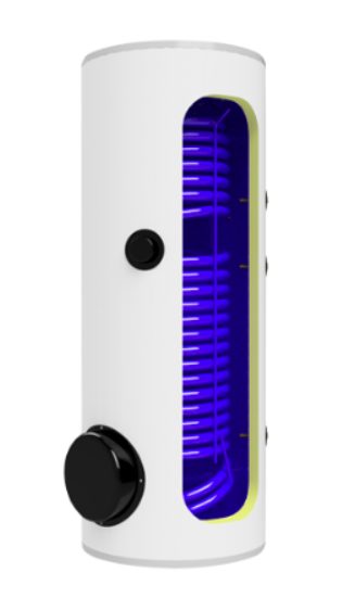

Also what is your opinion on stratification pump for DHW ? I was thinking to add a small pump which would mix the water when DHW heating is active taking hot water from outlet and pump it at bottom of the tank. This way it could heat whole tank to target 50C temperature. I have a tank where the coil is running from the very top to very bottom of the tank. The surface area is 3m2 (itās 300L tank) but because of heat goes up the coil in 1/3 is inefficient.

On DHW stratification, I personally think that it is a good thing, at least for my requirements. It keeps the top bit of the tank warm for a day or two after a DHW heating run. If I did want some really hot water, I think it would be cheaper to boil the kettle occasionally than to install a circulation pump on my DHW tank. But if your tank coil is too far up, and you really need the full 300l of hot water every day, then a new pump may be cheaper than a new tank

Regarding stratification - of course itās a good think but I mean mixing only when pump is heating the water. Not when DHW heating is off. I have this kind of tank. You see coil at the top is pretty inefficient with HP.

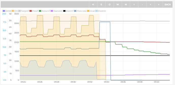

This is right but problem is that it is doing it in a nasty way
Itās not like it slowly continues on 22Hz but it starts to shifts compressor frequency every minute from 22Hz to 14Hz causing this zig-zag pattern. Yes, it holds target temp more or less but usually the LWT is lower than target by one or two degrees and of course efficiency is not the best. And ofc is pain to watch. If you are near the pump you can hear how compressor changing speed every minute⦠I donāt know if this is healthy for the compressor in a long run. Out of curiosity maybe you could ask Nick what he thinks about it next time you will be in contact with him.
Now I know maybe more what 2093 is doing but not sure 100% what 2 - 4 are doing exactlyā¦.
Question - when exactly the pump send the command thermo off ? I know itās either because thermostat is satisfied or WLT reached target temperature ? Itās immediately or when pump exactly stops the compressor in case of water law ? I donāt believe itās immediate because outside temperature can change every few minutes right ? It is like it has to be running at target flow temperature for some time ? Or what triggers the stop exactly in weather compensation mode ? This is not clear to me
When the pump decides to stop because of WL then when the compressor starts again ? What triggers it ? I mean if you have 2093-2 - pump status Off (1min delay) - what does it mean ? Does it mean that after the compressor shut down the water pump is running for a minute and then it stops ? And how the pump knows it should start compressor again ? if the pump stops how does it know itās time to start heating again ? I simply canāt get it. In case of 2093-3 - does it mean after compressor shut off then the pump is running constantly ? Here the system has overview of LWT and RWT but when does it know it should start the pump ? When LWT drops by 2C or how does it work ? Or RWT drops by 2C ? Problem with radiators is when you switch off the pump these temperatures decreases fast right ? At least in my system
And then we have 2093-4 - 3 minutes on / 7 minutes off / 3 minutes on etc⦠But again what is the trigger the heatpump starts heat again ?

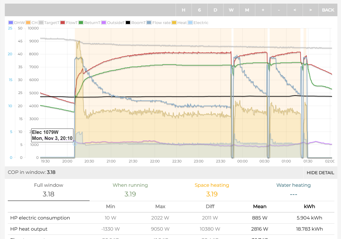

Here you are talking about hysteresis when remote controller thermostat shut off the pump or about WL ? So e.g when target is 40C and I have 2093-4 for example and if I have hysteresis set to 2 then pump starts again when WLT drops from 40C to 38C ? And if I have hysteresis 7C then from 40C to 33C ?

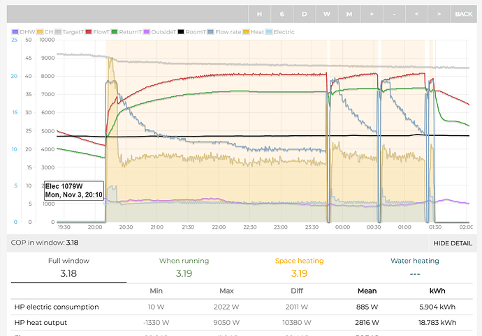

From this chart you can see that when the pump stopped I had 38C flow temp and return 34C. But at the time the pump stopped temperatures were equal 34C and when the water pump stopped flow temp stayed constant at 34C but return dropped to 25C in 5 minutes.
This was turned off by thermostat so I donāt know what WL mode would do here if I set 2093 to 2 or 3 or 4.
I believe when the water pump is off then the heatpump canāt have information about if it should start heat again or not and this is biggest mystery for me which Iām pretty sure you can clear up
I believe in UFH systems with big water volume this could work but how this can work for radiators.

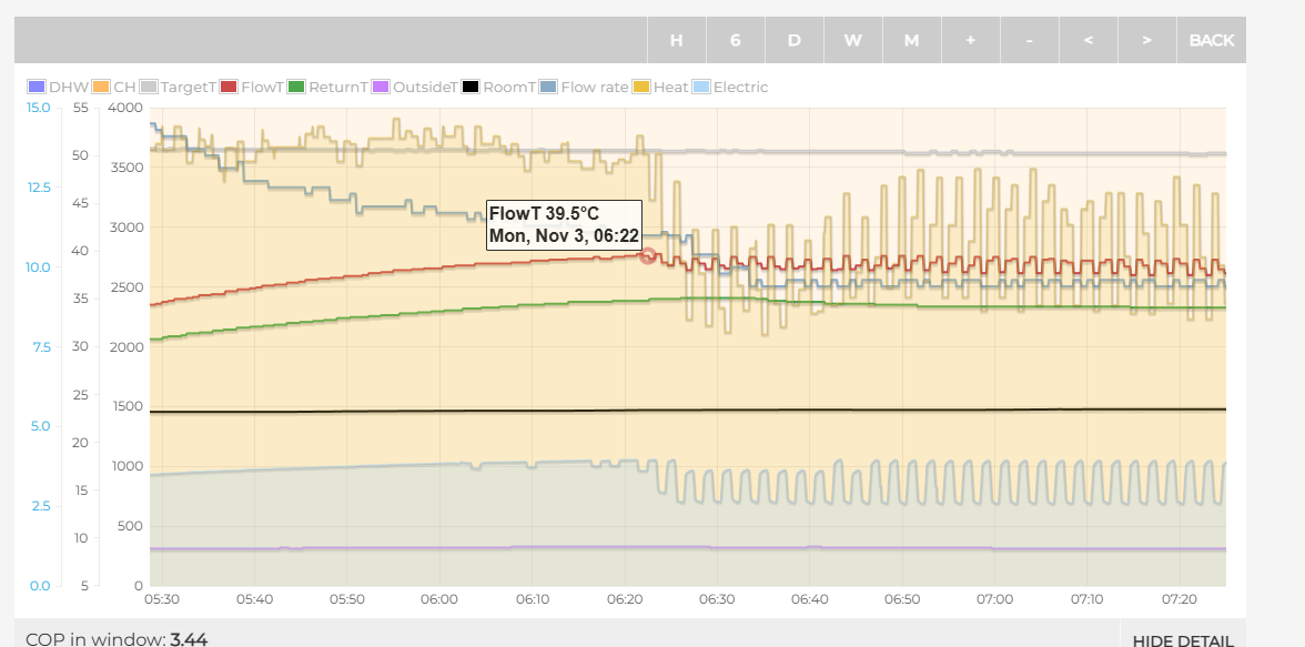

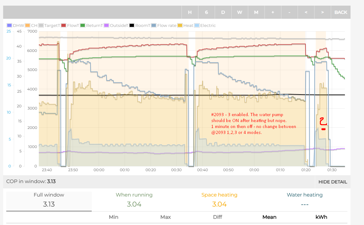

Hey @SarahH I think Iāve understood the logic of WL and #2093 but Iām either stupid or something is broken. I found few interesting things and something I canāt explain.
Thing is this is the chart from yesterday run when Iāve enabled #2093 mode 4 this means after compressor off the pump is running for 3 minutes, then 7 minutes off, 3 minutes on and so on⦠But this didnāt happen! After compressor went off the water pump was running for exactly 1 minute and then it stopped! But why ? This must be wrong. So it happened that when pump was running the LWT and RWT equaled and both sit at 36C. Fine, but then the pump stopped and RWT started to drop of course so 1 minute and 30 second after the water pump stopped HP started compressor again.
I ask why itās working like that and not according #2093 setting ? Then for the cycle from 0:36 to 1:19 Iāve enabled #2093 - 3 so the water pump should be ON all the time after thermo off but again it is ignored. This is killing me because I guess because of this behavior of water pump the pump starts cycle way to fast. There is 2m:30s because it starts to re-heat againā¦.
Do you have an idea why #2093 is ignored? Iām using terminals 1 and 6 for the water pump with PWM regulation but canāt believe this could be an issue. But I believe if the pump would stay on according #2093 the pump would not start that fast. I donāt know the exact logic when pump start to reheat again.
What is also interesting that if WL mode is used (#2093 other than 1) the HP does not modulate to 14Hz! It never goes below 20Hz and tries to keep target temp as long as possible. But from the chart logic is not clear. You can see that first run was very long over 3h:30m until the HP decided to stop. It was oscillating around 40.5 LWT. But the next cycle was much shorter only 45 minutes until it stopped it for 2m:30s and started again and that cycle was 43 minutes. Whatās the logic behind, why the first cycle was that long and other that short. Then Iāve turned the pump off overnight and it started at 5:00 a.m. and that cycle was again long 3 hours and then again shorter one.
I donāt understand this pump at all ![]()

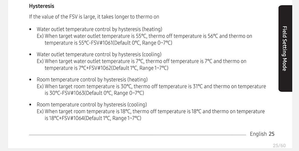

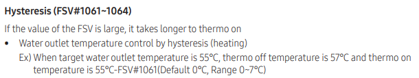

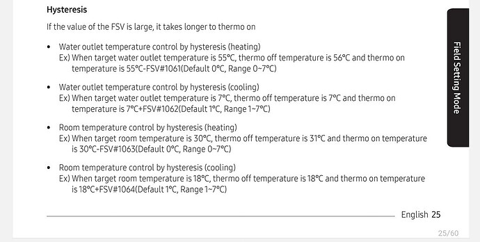

Regarding hysteresis, the Remote Controller thermo switches off at setpoint, and back on when the LWT has dropped ~2deg below this (unless you have #1061 available)
Iām not sure this is correct, I believe the default hysteresis (without #1061) is target ā target +1/2C.
I have different values for this from different manuals (see images below) which may determine whether it is 1 or 2.
So if your target water temp is 30, thermo will turn off at 31/32, then turn back on again at 30.
#1061 adds a lower hysteresis. I have mine set to 3.5. So if the target LWT is 30, thermo turns off at 32 (which is have validated with monitoring), and it turns back on when LWT drops to 26.5 (which I have also validated). This gives me a total hysteresis of 5.5C which seems to work quite nicely for eliminating cycling. The wider your dt, the higher you will need to set #1061, as LWT drops to RWT (and a little lower thanks to flash cooling

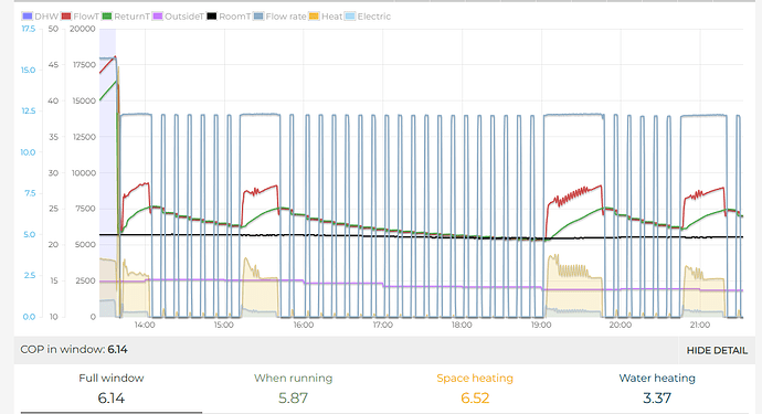

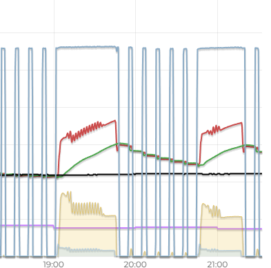

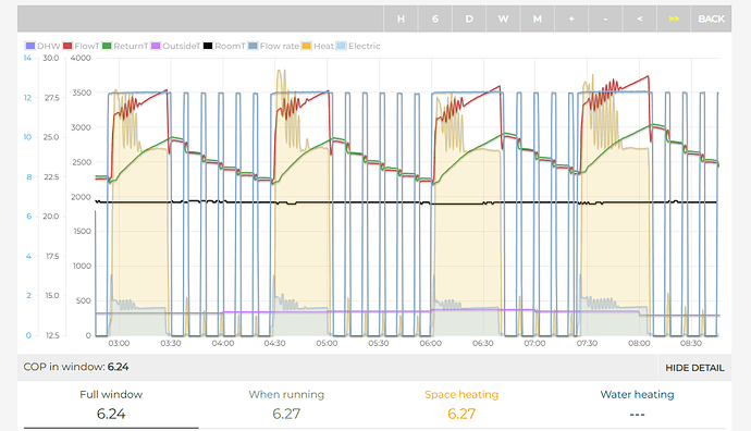

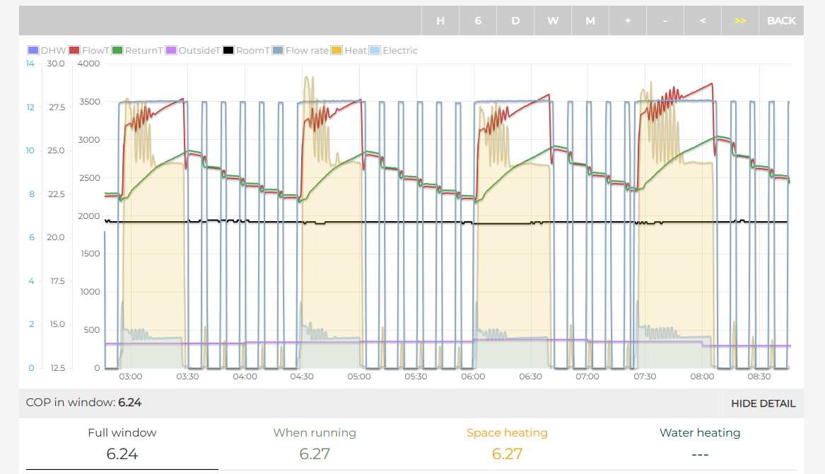

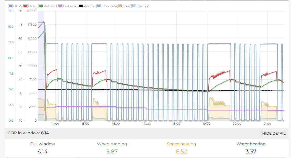

Iāve tried this out for the last few days. At the start of the peak time, 16:00, Iāve scheduled Heat with LWT set to 15. Then at 17:00 I schedule Auto to turn back on.
Here is a graph of this working:
The pump runs for 3 mins every 10 mins, to keep warmer water from the house flowing through the outdoor unit. It hasnāt dropped cool enough for the heat pump to need to run an AF cycle, but I canāt see how this isnāt going to prevent it from happening. After 3 hours, RWT drops from 25.2C to 20.5C.
Even if it drops below freezing outside, I canāt see LWT dropping to 15C, as the indoor temp isnāt going to drop that low, and thatās what is keeping the water warm.
Problem solved? Partially Iād say. A good solution that doesnāt require any external hardware or monitoring.

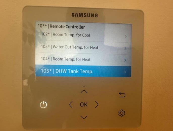

Btw, you can see here I canāt see #106x at all on my pump. What exactly do i need to enable it ? #105x is the last item there.
If I have donāt have that setting whatās the default hysteresis ? I can see itās roughly 0.5 - 1C above target when compressor shut down compressor but then immediately my flow drops to 36C and after a minute or so it starts again. I think this is wrong why ? On your chart here I can see your flow temp is around 28C, then it stops a pump kick where LWT? temp drops to like 22C ? So there is around 5-6C hysteresis on yours ?
