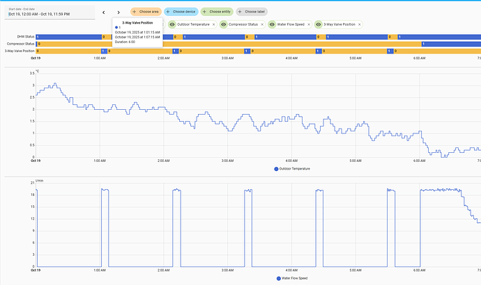

Hi all, so this night the outside temperature was below 5C so I could test DHW deactivation and sadly I have to say IT DOES NOT WORK.
From the chart you can see there were 5 anti-freeze cycles during night when space heating was turned off. The first AF cycle was executed at 1:01:15. At 1:02:00 the automation detected it’s an AF cycle and disabled DHW completely but sadly, 3-way valve didn’t return to a space heating circuit and stayed on DHW heating circuit for the complete AF cycle which lasts 6 minutes and finished at 1:07:15. For 5 AF cycles the heat pump would steal more than 10C from the water tank during this night
So this solution is not feasible unfortunately. The only way to make it working in my opinion is to have DHW cycle disabled before AF cycle starts. This is of course hard to automatize because you never know when it starts. So it seems still the best solution is to use a relay to bypass it.

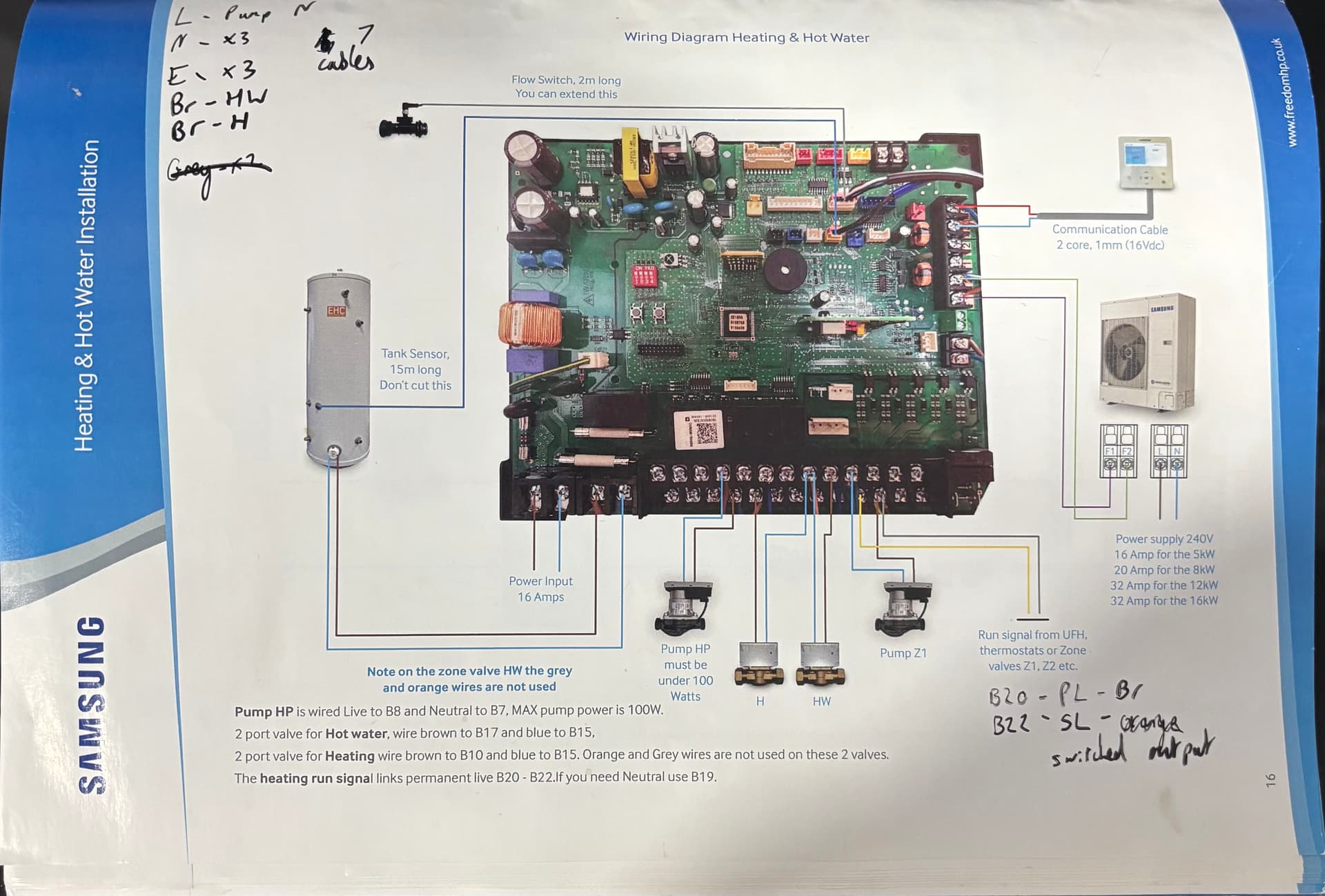

I don’t have a 3-position valve, I have (I’m not a plumber so forgive me) on/off valves on both the heating and DHW circuits.
I checked data from last year and from what I can see it doesn’t change the position of these valves when doing a defrost.

Freedom Heat Pumps installation instructions.
2 port valve for hot water, wire brown to B17 and blue to B15.
2 port valve for heating, brown to B10 and blue to B15. Orange and grey wires are not used on these valves.
As far as I can tell, this configuration it will use the currently open valve’s heat source for defrost. That kind of makes sense as it is most likely to have usable heat within it.

My system, a Joule pre-plumbed cylinder, is plumbed and wired differently. I think I have a 3-way valve for selecting Heating/DHW and a separate 2-way valve(s) (open/shut) for the heating circuit(s) (there are actually 2 heating zones available, each with a 2-way valve).
The 3-way valve has four wires (B17-20), 3 live and one neutral. B19 (neutral) and B20 (live) appear to be power, and then B17/B18 are switched lives to control the position of the valve (B17 ON, B18 OFF = DHW; B17 OFF, B18 ON = Heating). B17/18 operation are reversed if FSV #3071 is reversed from default.
I need to look more closely at the physical plumbing, as I think there may actually be 4 of those 2-way valves on a manifold, so the ‘3-way’ valve may actually be implemented via 2 x 2-way valves which each open or shut heating or DHW, respectively (which would be consistent with the wiring described above).
