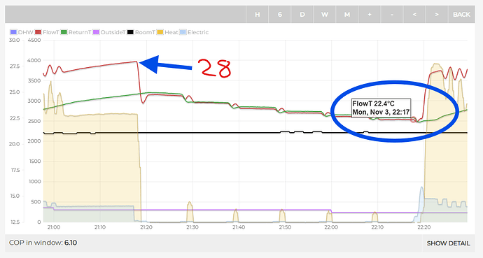

It sounds like your default hysteresis is only 1 degree. Which is why it keeps starting immediately after stopping. LWT drops a few degrees when the compressor turns off, and it then starts back right back up.
Correct, my hysteresis is 5.5. My default is +2, and I have set 1063 to 3.5, so 5.5 in total. Target LWT was 26 (which is my low WL setting) compressor turns off when LWT reaches 28 (+2), and turns back on again at when LWT reaches 23.5 (-3.5).

Yeah, seems it’s really 1 degree - in total ? so above +0.5 and below 0.5C to start or it’s 1C above and 1C below target to start ? How did they think it was a good idea ? when you stop the compressor everyone’s flow temp will drop by few degrees. I can’t understand this logic to be honest. Even yours - I believe you have UFH and as you stop the compressor then the flow temp drops instantly by 4 - 5C.
I wonder what settings @SarahH exactly do you use for this #2091 @2092 and #2093. You have external thermostat I remember but then what settings do you use 1, 2, 3 or 4 for the pump behavior ?
So you’ve set #1063 to 3.5C. Your target was 26C and it stopped at +2C so 28C and started again at 23.5C but this is 2.5C from target temperature, not 3.5C or ? Also why it stops 2C above and then 3.5C below ? Why this asymmetry and where it is configured ?

I see what you are saying now. Then yes. I believe you are correct.

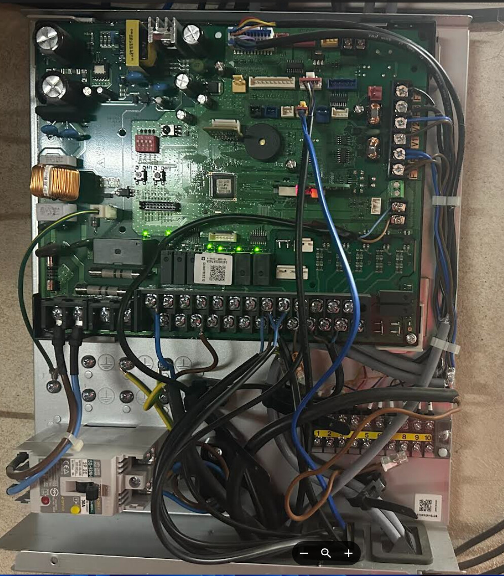

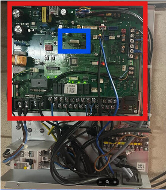

Just the MIM controller.
She said around £180 in total.
It is just this PCB (red square).
I did it myself when Samsung sent me a new PCB under warranty as my PWM wasn’t working. Power it off, unplug and unscrew all the wires, then it is held on with 2 screws to the casing. The Eeprom (which is the little PCB sticking out in the middle - blue square) just pulls out and will need plugging into your new PCB, as this isn’t included with a new PCB. I still have the old PCB, but this won’t help you as it didn’t have the 106* settings either.

I have #1061 set to 3.5. #1063 controls indoor temp hysteresis, not LWT hysteresis.
apologies, this must have been a typo. I meant it starts again at 22.5 But also, these are not reading from the Samsung unit itself, they are using the Open Energy Monitor kit which is around 10m downstream of outdoor unit.
The +2 cannot be changed, the only thing I can change is how far below target LWT it drops before starting again, which is #1061. I used 3.5 as it gives a total hysteresis (5.5) that is higher than the 4 degree drop when the compressor turns off, and also gives it enough time to drop even further so that when it starts again, it does not immediately go above the target LWT.

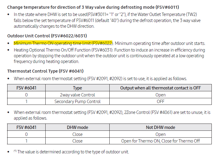

With the MIM update, you also get a minimum thermo on, FSV #6022, which I currently have set to 20 mins. So even if it did go above the +2 hysteresis in under 20 mins, it would stay running until the 20 mins have elapsed. Although, because I let it drop to -3.5, it rarely reaches target in less than 20mins.
Do not read too much into #6011, this is for defrosts only. Not AF cycles. I tried this already :wink: though I might double check.
I do not understand #6041 at all.
Can you tell me when exactly it is ? I can’t see any red squares or blue squares here.

This looks interesting. Wish I can set min thermo off time, can’t believe it’s not there. But min compressor run time is also not that bad especially when used with thermostat.
#6041 - no idea but guess SaraH would know :slight_smile:
Apologies, i must have forgotten to paste the image before.

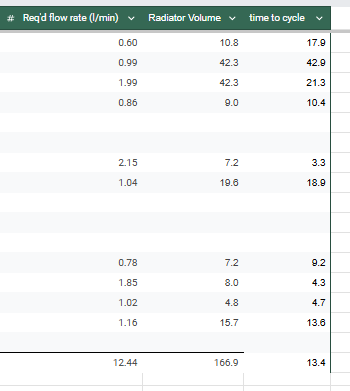

I specifically went for large radiators to be able to have low flow temps. My WL high setting is currently set to 38C at -3C outside. But I think this is a bit high and I might be able to get away with around 36 or 37C.
I have 2 large triple column vertical radiators that have a 3kW output at dt50, and they have a volume of 42L each. I have 2 other smaller column rads and the rest are T22. 10 rads in total.
1 of the large column rads was put in purely for looks, it is way too big for the room (in terms of output) and so only has a flow rate of 1lpm, so takes over 40min to completely cycle the water in it. 1 of the T22 rads in my kitchen takes only 3 mins to cycle all of the water in it as I run it at a high flow rate to get a low dt and marginally increased output.

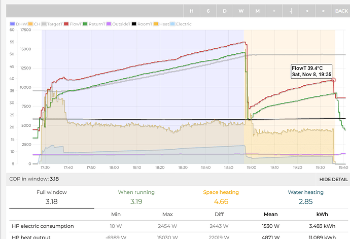

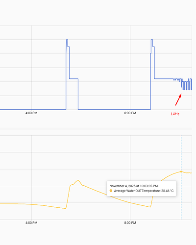

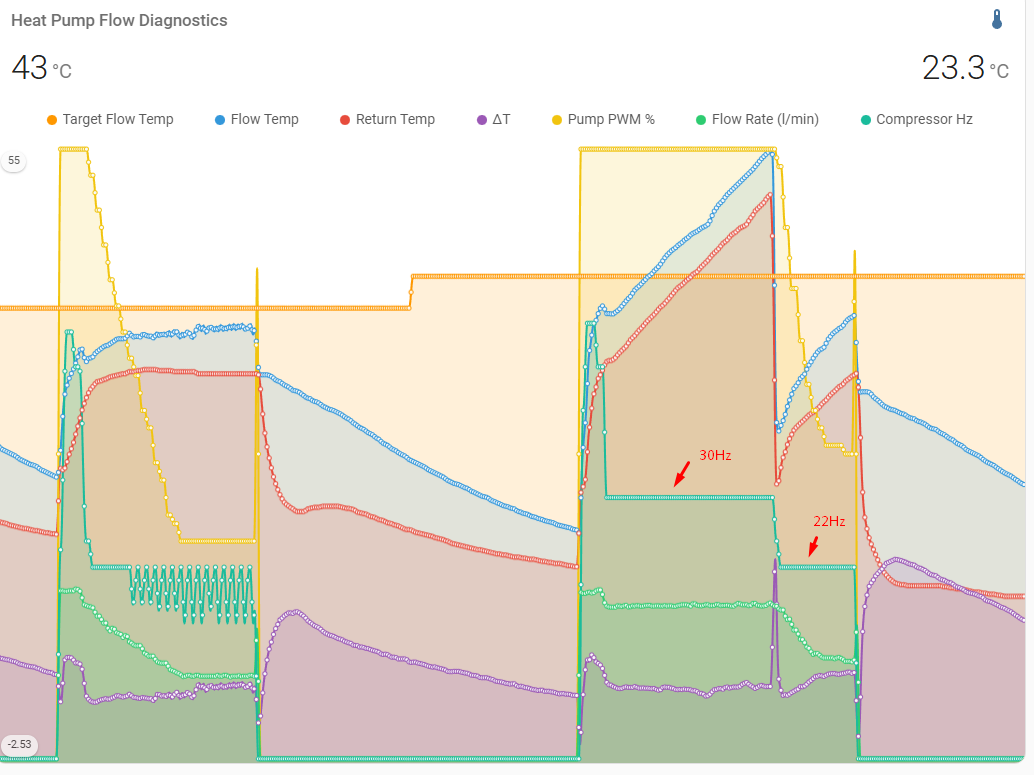

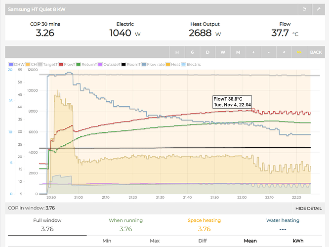

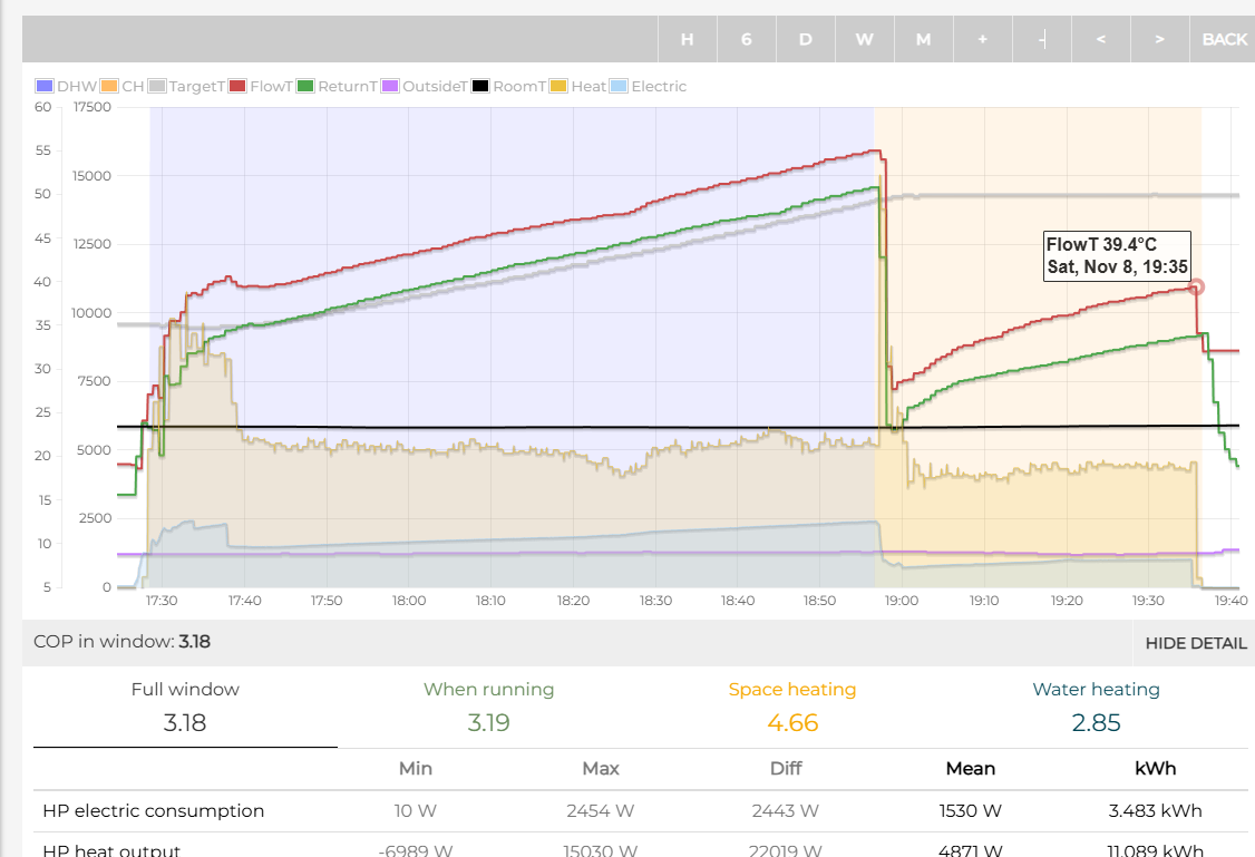

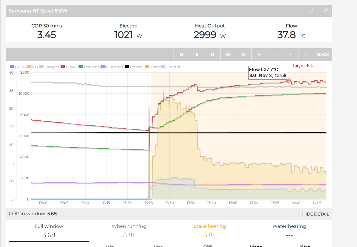

To ALL: So I can’t get it. #2093 is set to 3 - why the pump is still heating ? It obviously struggle to reach target temperature 39C. I’ve set it to 39C for test. It is going fine until 38.5 and the it starts to decrease compressor speed instead to turn the heat off by WL. Can anybody explain it ?

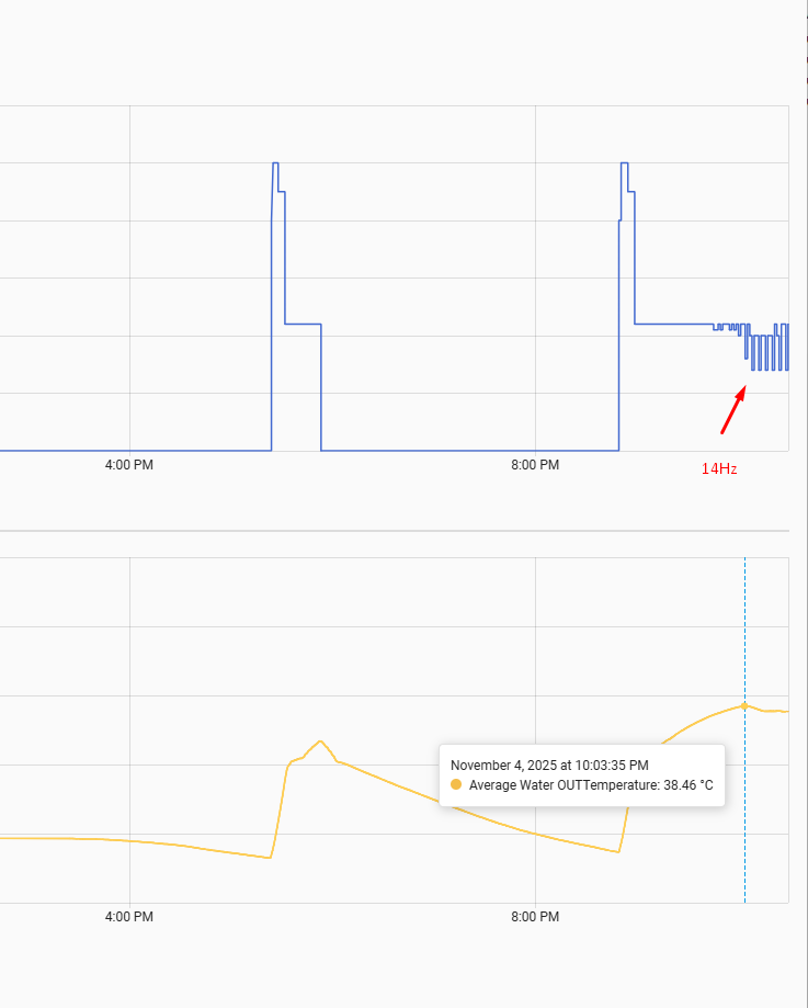

You can see that it reach 38.5C and then because it started oscillations to 14Hz it decreased on average to 37.7C which is 1.3C below target. I will never understand this pump… never.

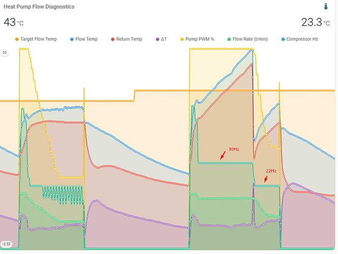

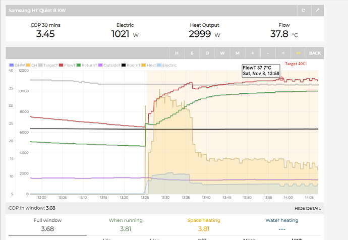

BTW, do you thing something is broken in my controlling software I really can’t understand why the pump start to slow down then compressor when I’m still far away from target… My target is 40C and it starts to oscillate at 37.7C. Can’t get it I thought it’s only like 1C below target or so. Sometimes it’s just 0.5C.. Can’t get it, wish I can set a minimum compressor frequency for this thing.
Are you in quiet mode? This sometimes keep the flow temp just under the target flow temp in my experience.
Nope, but I do have frequency ratio control enabled. I don’t know how exactly this works because on controller you can’t set percentage so I would say it is set to 0 meaning compressor is using 50% of max power ? I don’t know but hour ago it was doing DHW and immediately after it was doing space heating and this was pretty good run :slight_smile: But I’ve increased target temp to 43 so the pump has no reason to lower compressor frequency and it was running steady at 22Hz… Water was heating at 30Hz.
So this (last run) is exactly I would like to see all the time but seems most of the time the pump behaves erratic changing compressor frequency like crazy once approaching the target temp. Look at the previous run. The erratic behavior started at 37C while target was 40C. I have some suspicion that’s because of low water level in my system. It’s around 40 - 50l so I would say pump is panicking somehow since the flow temperature is raising too fast and drastically changing the speed instead of smoother modulation. Or it’s simply stupid PID controller I don’t know. I’ve also set target deltaT to 6C. I’m thinking about buying 50L buffer tank to double the system volume which could help with this. Or maybe not, I don’t know.
What issue do you think the changing (up&down) frequency is causing?
