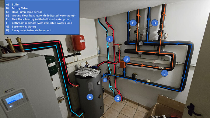

Ciao everyone, I’m new to the forum and this thread is just great: so many insights!
i need some help, and would love to hear from you folks!
I have WL and Mixing valve installed.
Mixing valve is separating the floor heating, from the basement with raidators (which anyway i only turn seldomly, so we can assume it is always off).
what i am experiencing is that:
if i set the #2091 to 2-4 (so having also WL to be able to switch off the compressor and not just the room thermostats) what happens is that when temp raise too much, the compressor shutdown and it reset the mixing valve all of a sudden.
This closure causes that suddenly only cold water start to flow into the floor circuit: this is because the room thermostats are still ON, keeping the water pumps in the floor circuits active. So the temperature drops immediately, not benefitting from the buffer (as the mixing valve is closed) and causing the temp sensor to turn on the compressor after a couple of minutes.
the valve then slowly reopen, making hot water flowing in and triggering the same loop over and over.
my expectations would be that when WL stop the compressor, the valve should maintain the same position (or adjust slightly) so it could consume the hot water from the buffer until temp slowly drops and compressor could be turned on again.
do you know if this mixing valve behaviour is intended? and why?
If however i set #2091 to 1, then the mixing valve works fine as it never reset.
But then also the compressor never stops (unless both my room thermostats go off). and that leads to a slow but steady increase in water temp (up to 55C) which then forces the mixing valve to start mixing and it just feel very inefficient. it is warming water up to only mix it with cold water when it should just present water as per WL…
i called assistance several times but they never managed to set it up properly.
any guess?
