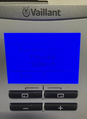

That article from @Zarch is really good and definitely highlights that my fixed flow rate calc is too low. Really interesting that flow rate on Aerotherm ASHPs is fixed and the DeltaT varies. Whilst my algorithm did have a fixed value at 18L/min it’s well below 33L/min that Vaillant aroTHERM | DT5 | Mass Flow Rate Triangle suggests for my 10kw Aerotherm+.

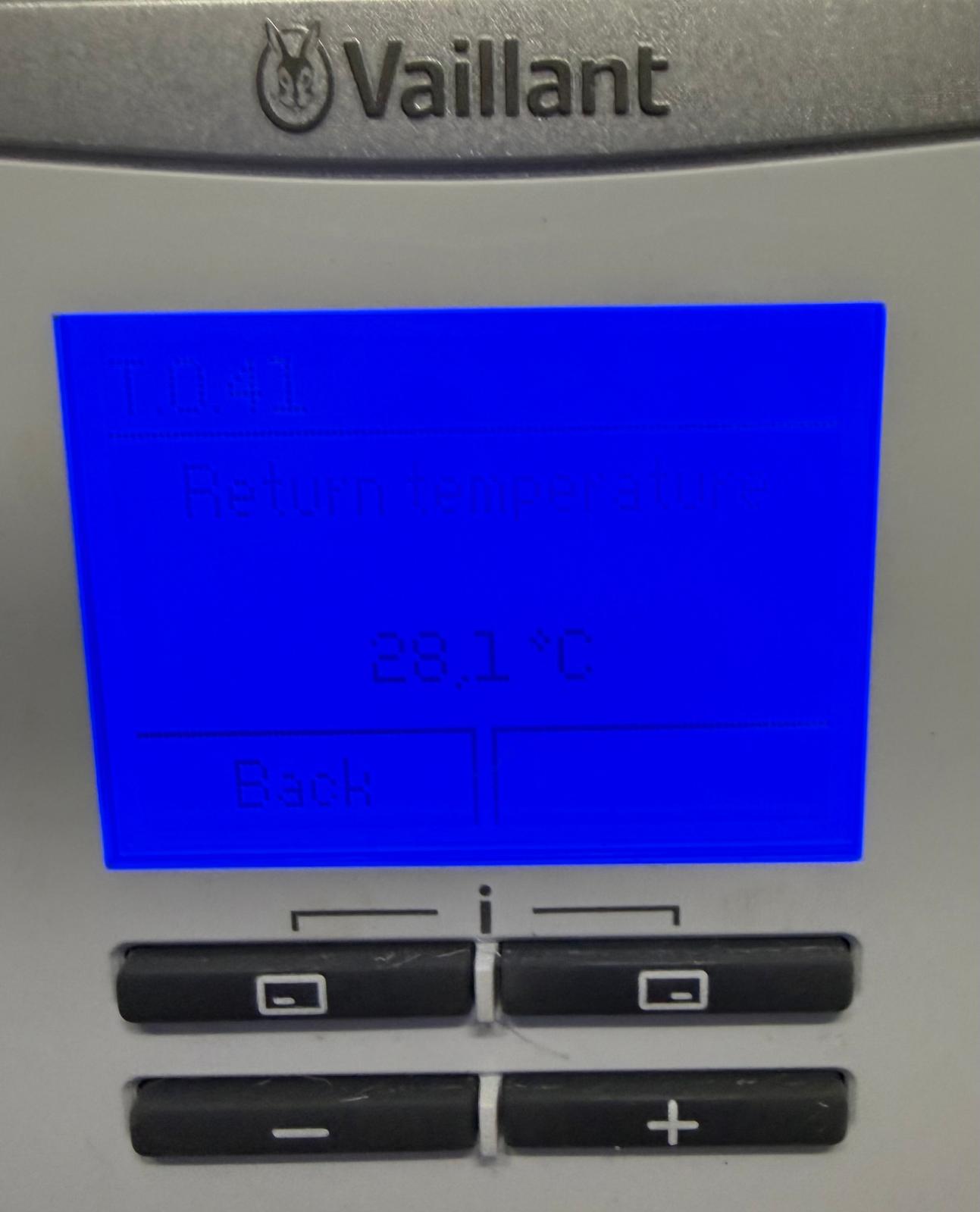

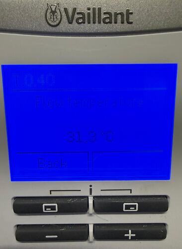

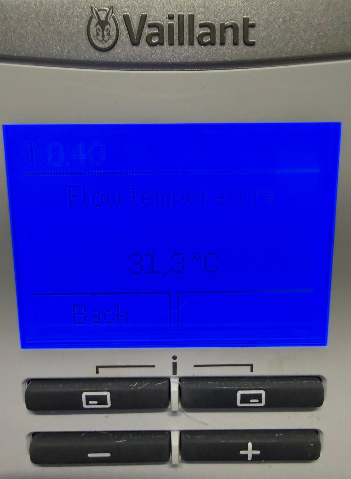

On a related note, today I followed your advice and took 3 different readings throughout the day from the controller. They’re pretty much been the same throughout the day, here’s the latest
Flow Rate: 1496 L/hr (24.9 L/Min)
Flow Temp: 31.3C
Return Temp: 28.1C
Looking at Vaillant aroTHERM | DT5 | Mass Flow Rate Triangle , the Flow Rate for a 10kW should be fixed at 33L/min, mine seems to be fixed more around 24.9L/min, I’m thinking the installer must have set it lower than 33L/min, or the console is showing an average and this is taking into account the fluctuation you referred to in your chart. Would be interesting to know your thoughts. Thanks for all the input so far, I’ve learnt more in this thread than I have myself over the last two months
That flow rate reading is real-time.
Use the ‘Installer level → Test menu → Sensor/actuator test → Conf. heat. build. pump’ setting (code: 17) to check if your pump speed has been manually set; unless there’s a specific reason to do so, it should not be set to anything other than ‘Auto’, which then uses PWM to target a steady ~2000l/h when the compressor is running and the unit is in space-heating mode.
If this value is set to ‘Auto’, then you have a flow rate issue, usually caused by a blocked strainer/filter. Get these checked and cleaned. Very rarely, this may be caused by flow restrictions due to poor design; this becomes drastically more disruptive and expensive to fix.
Thanks, I checked my config : heat.pump.build.pump setting and can confirm it’s set to auto. I only took three readings today but they call came out at around 1490l/h for my system. Interestingly I made a Google sheet showing the flow rates of all 10kw Vaillant Aerotherm+ systems on Openheatmonitor.org Whilst it’s a small sample there’s still quite a lot of variance although nothing quite a low as mine: Average Flow Rate for 10kw Vaillant Aerotherm+ ASHPs - Google Sheets
I guess my other question, is how accurate is the Vaillant Flow measurement compared to the Heat Meters from Open Energy Monitor.
BTW: I opened up the strainer, there was a load of crap in there. I gave it a good rinse out and popped it back in. As this install is only 4 months old, I was surprised how much crap was actually in there. I’m not sure there was enough crap to make a difference to the flow rate, even so I’ll check the numbers tomorrow.
