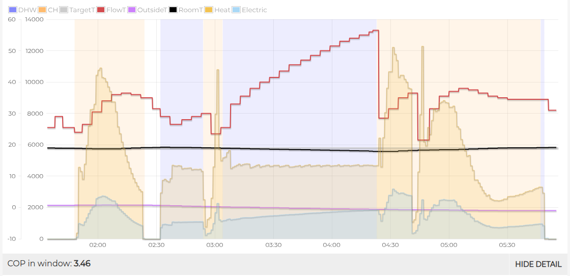

I collect metrics from the MyVaillant integration with Home Assistant and store that in a local emoncms. I’ve included a graph of Jan 4th from my local emoncms install. I don’t want to confuse people with the graph as only flow_temp, outside temp, room temp and electrical consumption are reliable. Ignore the COP value in the emoncms graph as the flow rate and return temp are extrapolated. When I refer to COP I’m referring the Electrical Efficiency value I’m getting from the myVailant app not the COP from this graph.

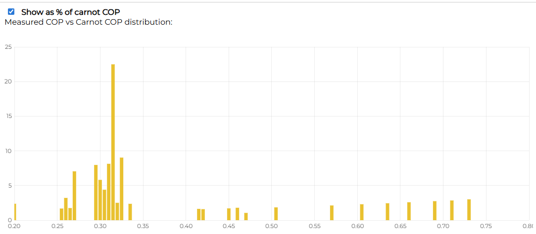

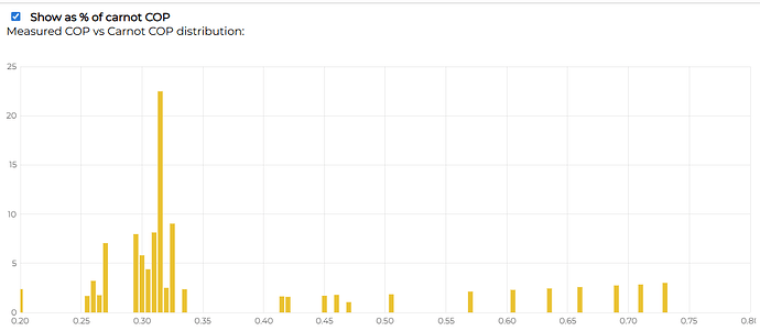

I’d be interested to see what your chart looks like when you enable the “Show simulated carnot heat output” - I suspect that poor temperature sensor accuracy is making the heat estimates to be way lower than they should be. Probably worth checking that the sensors are correctly fitted.
hi Andre,
Thanks for the response, my data isn’t up on heatpumpmonitor.org, it’s on a local emoncms install running inside my Home Assistant. I didn’t want to post it as I’m extrapolating the flow_rate and return_temp as I can’t get those values from the HA MyVaillant integration. Only the electric power, flow temp, outdoor temp and indoor temp are accurate in my local emoncms.
Appreciate that doesn’t help, but I’ve never wanted to degrade the heatpumpmonitor.org data with my extrapolated data. I’ve read so many posts on getting data from the HA myVaillant integration, but I’ve always assumed anyone doing it that way, doesn’t post it to heatpumpmonitor.org. My comparisons are purely from the MyVaillant app to heatpumpmonitor.org

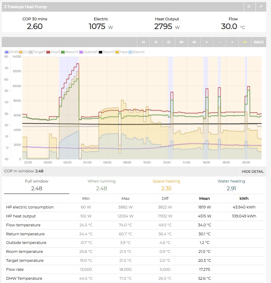

I must admit I don’t know what this graph is showing but here it is. I should say that there was a legionella cycle in this window
COP in window: 2.48 (33.9% of Carnot)

How are you extrapolating these numbers?
There isn’t enough information here to calculate heat energy produced, and therefore COP. I monitor a Vaillant system this way and opted to use the Carnot COP equation to estimate how much heat is produced using only the reported temperatures.
Basics — OpenEnergyMonitor 0.0.1 documentation
Majority of heat pumps operate with a Carnot factor of 0.5 - your chart shows much lower at 0.33, which seems unlikely for a Vaillant.
I think if you’re running at 35°C you’re probably actually getting good performance.
My apologies - I missed this point in your original post. No idea how myVailant calculates this, but I doubt it’s accurate.

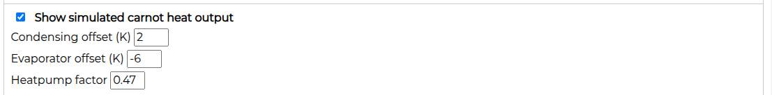

Here’s the formula I use for estimating the heating power with Carnot (python, so you’ll need to translate it)
    # Carnot heat calculation
    condensing = data["flowT"] + 2 + 273
    evaporating = data["outdoorT"] - 6 + 273
    carnot_cop = condensing / (condensing - evaporating) * 0.5
    carnot_heat = carnot_cop * max(0, data["elec"] - 60) # ignore standby and pump
Which looks something like this (for 7kW unit), and may be closer to reality:
(edit: does not account for defrosts, so may be over optimistic at times)

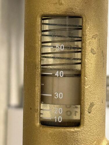

You might be better off reading the flow rate from the controller directly. See if this video helps: https://www.youtube.com/watch?v=yAr6PYFCELM
More detail can be found on Zarch’s blog post: Vaillant aroTHERM | DT5 | Mass Flow Rate Triangle - can also find out the true return temperature to fine tune your formulas (with the caveat that one or both temps may be wrong).

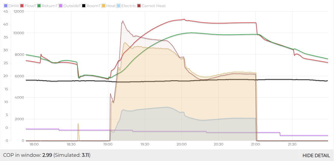

FYI: This is what you would see if you let My Heat Pump app calculate the Carnot heat (dark red):
It’s not always an exact match, and you sometimes need to fiddle with the heatpump factor to get it to fit better. It can be a useful diagnostic tool to check if the heatpump (or metering) is within expected parameters.
