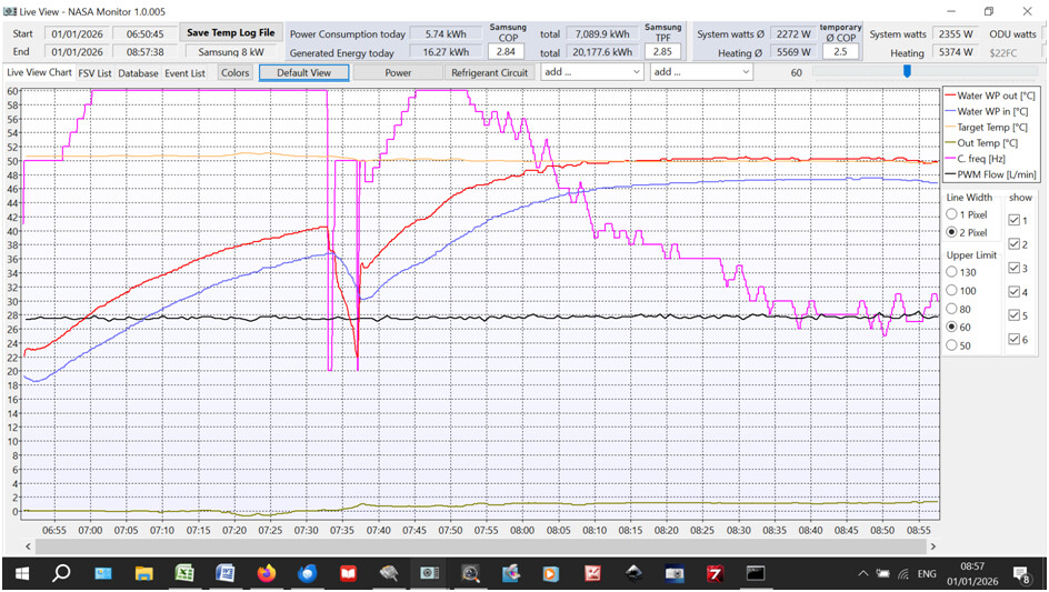

A propos a different discussion, I had cause to look at this very matter on my Samsung when the compressor was running at constant speed one day recently:
QED…
Hey that’s brilliant. Can you share the outdoor temperature as well, because then I could directly use this model for my optimum flow rate calculator.
Hi Andre,
On this time trend you can see that during the period 07:00 - 07:30 (which I used to generate the above graph), ambient temperature (brown line) remained within a whisker of 0degC throughout.

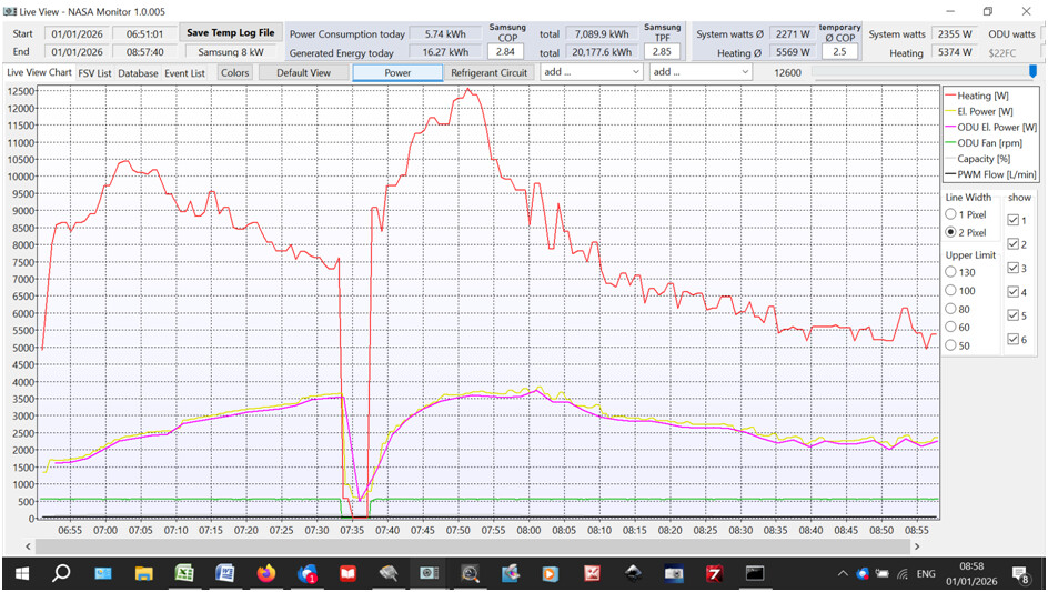

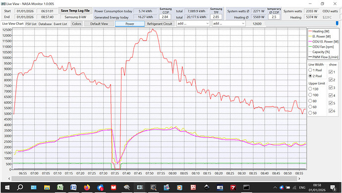

For interest, I’ll toss in the energy plot for the same time period:
I would be wary of reading too much into the absolute CoP figures in the graph:
  • The power input data (the yellow line in the second plot) arrive on the data highway some time later than the temperature data, skewing the CoP calc a bit
  • I believe that my LWT and RWT sensors are not that accurate - there’s a difference of about 0.6degC when the heat pump has stopped for a few hours
  • The heat pump was flat out during this post-setback period - not where it normally operates - and the energy values (in and out) may not be too representative
You won’t be surprised to see that the compressor speed (magenta line) reduces as LWT (red line) approaches weather compensated target (orange line). If you want to see what happened to CoP during this period (and have half an hour to waste) have a look at the log I took covering the whole morning
06H-52M-03S-EHS MONO LOWTEMP-Trend.xlsx (681.0 KB)
The black headings are what the Samsung logging software provided; the red headings are my own calculations (phys prop regressions, energy and CoP calcs etc.).
I haven’t been able to draw many conclusions on CoP variation with temperature from the rest of the data (too noisy) but, once LWT was on target (apound 08:00) it seems to remain fairly constant (to be expected) and rubbish (also to be expected at ~50degC LWT). Maybe you can squeeze out some further insights…
Sarah
PS that dip at 07:35 is a defrost as I expect you will have guessed…

0°C outdoor is perfect. Even with all the uncertainties in your measurements, let’s compare against what I crudely fitted from a Vaillant arotherm plus 10 kW datasheet at min compressor speed. I got COP = -0.144\cdot \Delta T + 9.4 whereas your experiment yields COP = -0.223\cdot \Delta T + 11.09. Completely different systems and approches to get to the fit, but the numbers are in a similar ballpark. Around COP 10 as baseline and a drop on order of 0.1 - 0.2 per K of temperature difference. I’d love to see models like this for all heatpumps we have in the system.
