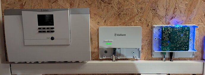

Hi, new Vaillant 7kWh ASHP recently installed through HeatGeek generally happy with the install apart from unreasonably high COP, presumably temp probe related but looking to get more data. Adapter shield C6 arriving shortly. I have HA and the myVaillant integration running but may look to Node Red or maybe n8n to get the data somewhere visual.
The first of I expect many questions, here’s the current electronics:
Any issues in just extending the ebus by connecting to the gateway on the right or should I make the connection further to the left?
Really does not matter - I’d suggest to connect where most convenient (as long as you’re not running tens of meters of cable).
Thanks. Far right is easiest, shortest and nearest to a power socket.

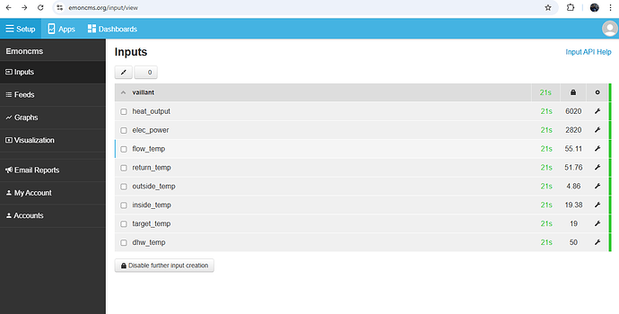

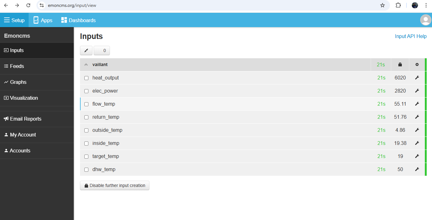

I don’t think I’ve done the emoncms .org bit right though. I have a screen that looks like this, with live numbers that look right (although I don’t trust that heat output as the number from ebusd is in kilowatts and only to 1 d.p.), and I’m not sure what to do next.
Ah, OK. So now you’ve got inputs (momentary values) which you have to store into feeds (data over time, potentially with transforms). Then the feeds can be used in a MyHeatpump app in emoncms which takes the feeds and visualizes your heatpump performance.

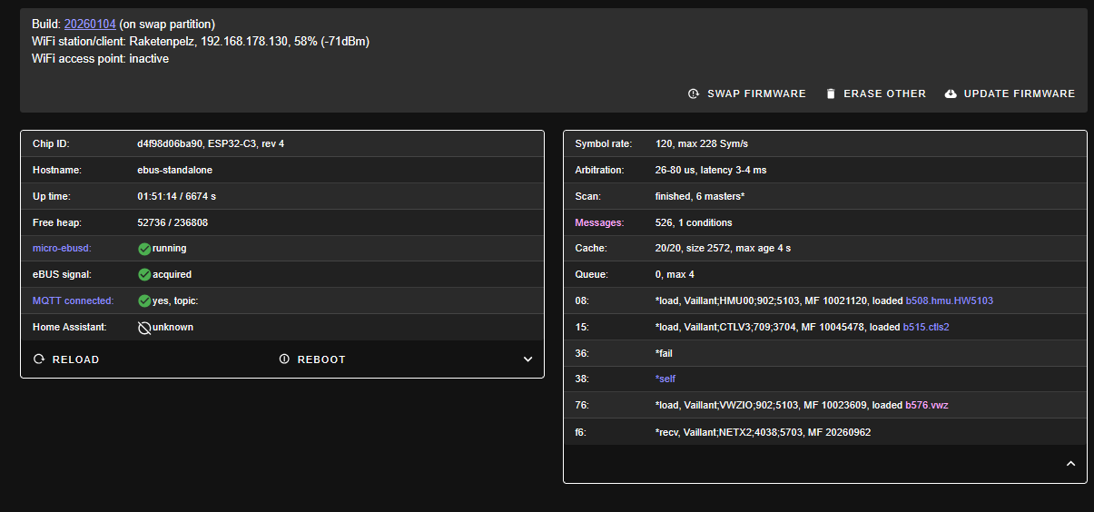

I just hooked up my spare ebus shield to the heatpump and have it running in micro-ebusd (standalone) mode, which does not require a separate RPi to parse the messages. Here are my first impressions. You need a license to access the features - I activated my trial license today and hence can test things out until Feb. 10. I’m taking requests :).

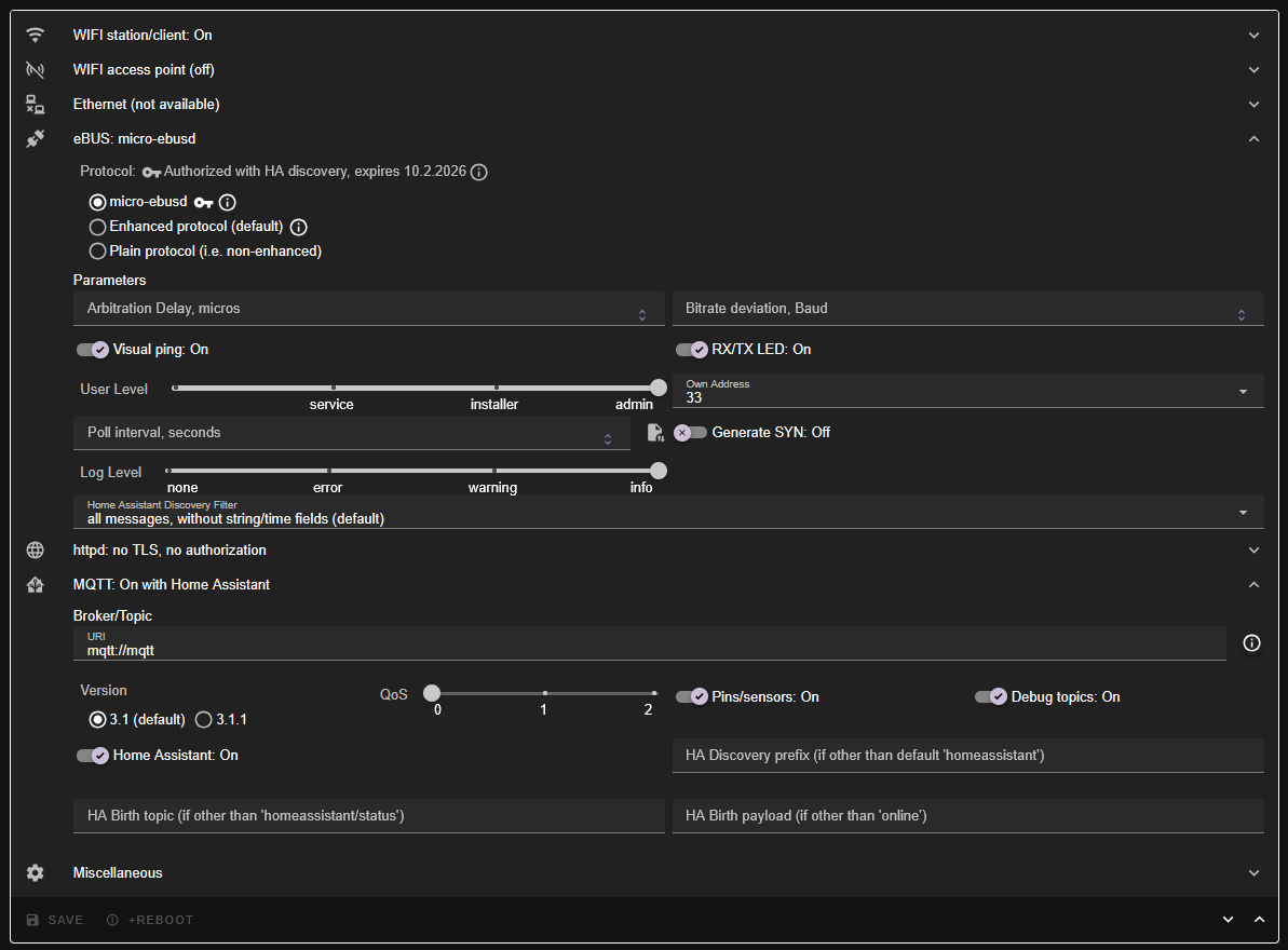

Installation was super easy - connect to the shield’s WiFi, put in details of my home Wifi and then update to the latest firmware.
I then picked micro-ebusd as protocol and put in my MQTT broker details (fresh broker instance on Proxmox to not mess anything up in prod)
You can see detected devices in the web UI and also configs that are loaded:
There is now a “Messages” tab in the shield’s web UI where you can see everything that the loaded config supports and can tick whether to poll for this message (poll interval can be globally configured, default 60s)
Here’s everything that got detected on my system (warning, long table):

There is definitely less info than I get with my local setup. Most importantly - I don’t see return temperature anywhere. This setup seems to fetch all its configs from a central CDN so it appears there is no way to manually add entries or point this to a different source of information.
I like the general standalong approach, but being completely dependent on a cloud CDN for configuration files is a showstopper for me. I don’t want to wait for random strangers to fight over a pull request just to see my return temperature. Message definitions are compiled into the firmware as of release but new definitions require internet access.
Here’s more info on the approach:
The token to access micro-ebusd costs some money, depending on how long after payment you want to get updates:
- F: free trial token for 1 month with all features: €0 plus tax
- XS: token with updates for 1 month: €10 plus tax
- S: token with updates for 1 year: €30 plus tax
- M: token with updates for 2 years: €40 plus tax
- HA: Home Assistant MQTT Discovery for eBUS messages (add-on option for a token): €10 plus tax
Supported messages for each the supported devices can be read on Github in the src folder:
Once this supports all required datasets we need to inspect our heat pumps, this will be a nice setup for anyone wanting to run without an extra Pi. I for my part have the shield plugged into a Pi running emoncms anyways and thus am going to continuerelying on my setup.
@Zarch @ectoplasmosis - this might be of interest.
Excellent, thank you for being a guinea pig!
Once return temp and flow rate etc are supported with this method, this would indeed be one step closer to a ‘plug and play’ ebusd monitoring solution.
Wonder how long it’ll take for the above to happen…?
Replying to my own post .. What I did was either really stupid or understandable, take your pick .. I hadn’t realised that there are TWO different ebus interface cards - the “eBUS Adapter Shield C6” and the “eBus to WiFi adapter module v6.3”, very similar names, both available from Elecrow, both based on the same technology, similar in appearance but not the same. What I had done was flash the C6 firmware on to the v6.3, which it accepted and would offer status and configuration screens but would not talk to the eBus. Worse, I can’t now get rid of it! I have erased it and flashed the v6.3 back on but it keeps offering the C6 config menu and won’t launch an AP. I’ll try Expressif’s last-ditch erase to factory app but it may be permanently goosed.
As you’ll see from other posts, though the C6 has more coverage it requires a separate power supply whereas the 6.3 doesn’t. This may or may not be a good thing.
Not exactly user-friendly
but thank you for taking a look!
I had thought I was going to go down the micro-ebusd route, but tbh I couldn’t quite get my head around MQTT, and when Google Gemini suggested a method that didn’t need it, I jumped at it. While I do like learning about things, usually my desire for things to “just work” wins out.
FWIW I really do like Docker now. I have a few things running as Docker instances, including ebusd, on the same 1 GB Pi 4B and it seems to work very well.
I find it more user friendly than the “classical” ebus way, and since emoncms comes with an MQTT broker already that you can point it at, this could very well become a plug and play solution at some point. The only missing part besides the missing measurements like return temperature is a sort of router to direct the desired MQTT messages to the emoncms topic so that it can be picked up automatically. If you look at the documentation of micro-ebusd there is also an http api you could leverage similar to the shell scripts you have running now, so MQTT isn’t even necessary.
It won’t be the solution for me either since I’ve got the hardware already, but could very well be a good option for newcomers down the line.
