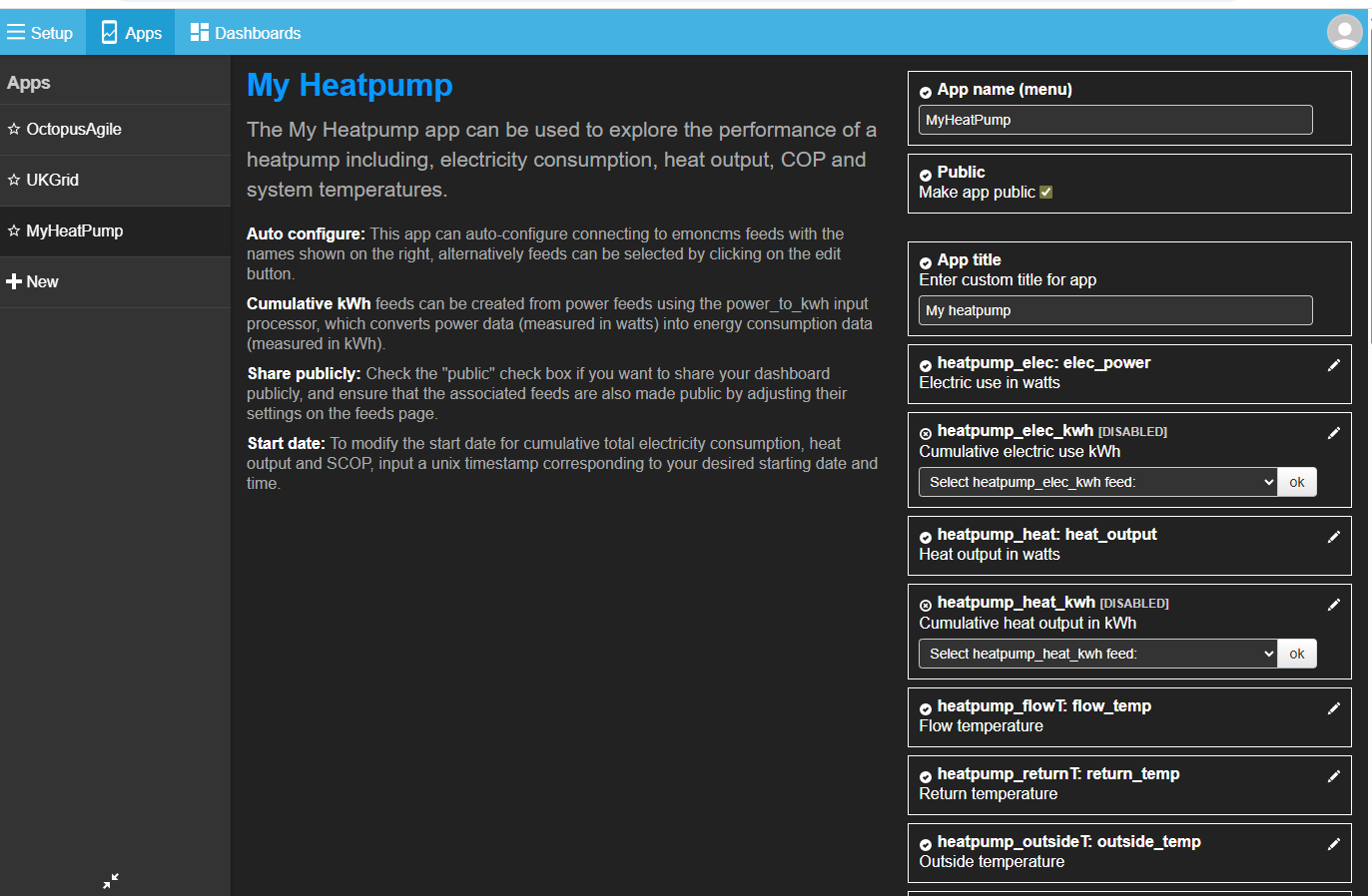

So I think I’ve set up the app – see screenshot below. What happens now? When I click on OctopusAgile or UKGrid (which I also added) a chart opens, but when I click Myheatpump I always see this screen, no charts.

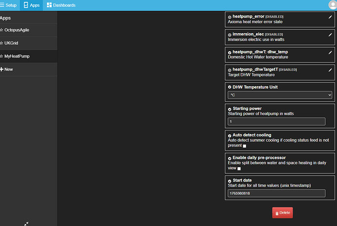

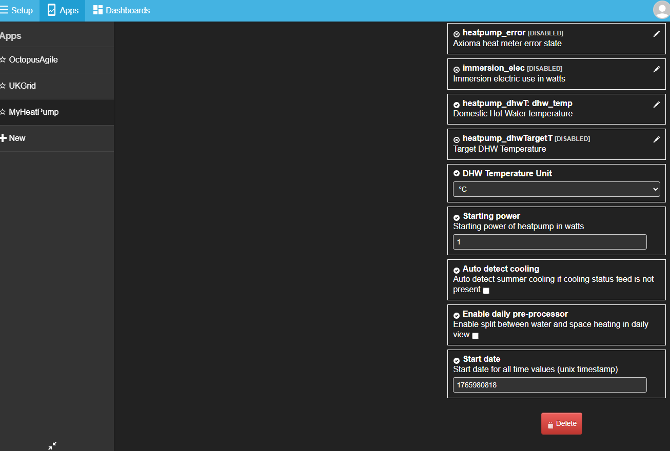

I’ve tried selecting “disable” and pressing ok for each of the boxes I don’t have a feed for, but still nothing happens. The bottom of the page looks like :backhand_index_pointing_down:. I mention that as the other two apps have a spanner icon top right which opens a config screen with the same layout, and at the bottom of the screen is a “launch app” button. Not so in Myheatpump.
Hmmm. I get the “Launch App” button for the MyHeatpump app too - which is how you get to see the graphs…
I wonder if it’s not happy about some of the entries you’ve specified (or disabled). Someone who understands the app better than me will need to advise if there are ‘mandatory’ fields that would prevent the “Launch App” button from showing.
OK so I deleted that first attempt at setting up the myheatpump app and created a new one. Again no joy – until I selected a random feed for ‘heatpump_elec_kwh’, not having the right feed for it. Then the launch app button appeared. So I think to get real data to heatpump_elec_kwh I need to use the ‘power_to_kwh input processor’. I found and followed the instructions here although they’re not quite correct. Launch app and… no data. However a few minutes the graph started populating.
I’ve also added a heatpump_heat_kwh using the same processor. Maybe maybe it’s working?!
(I also bought credits for emoncms .org from the store and added them to my account – felt good to finally give OEM some money!)
Went back to HPM and deleted my old attempt at adding a system. Added a new system again, and it seems to be working! :bottle_with_popping_cork:
Excellent. So it seems that ‘heatpump_elec_kwh’ is a mandatory input and you did exactly the right thing using the input processor to derive that from your real-time power values.

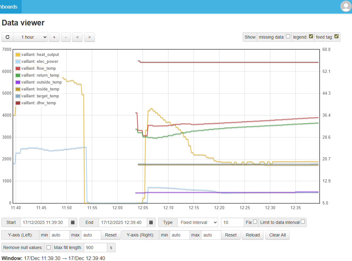

I next need to create feeds for each parameter, so historical data can be stored. To do that I need to click the spanner icon at the right of each parameter row, then beneath the ‘add process’ header leave everything as it is except change the ‘10s’ in the last box to 30s to match the upload interval of main.py. Then I press ‘add’ at the end of the row, then ‘changed, press to save’ at bottom right, then ‘close’.
Additionally I need to add second feeds for elec_power and heat_output. This time, I need to change the first dropdown under the ‘add process’ header to ‘power to kWh’, add _kWh to the end of the feed name (third box after ‘Feed’), change the 10s to 30s again, and press ‘add’ then ‘changed, press to save’. (The are ‘input processors’ but I don’t need to know that.)
At that point I should go to ‘My account’ in emoncms.org and scroll down to ‘Emoncms.org billing’, and follow the instructions to buy the appropriate number of credits from the OEM online store.
I now need to add an ‘app’, the MyHeatpump app. I go to Apps, +New, select MyHeatpump. On the right I need to select the dropdown in each little box and choose the appropriate feed for the title of the box e.g. for ‘heatpump_elec’ and choose ‘elec_power’. After filling in as many as I can, a ‘launch app’ button should have appeared beneath the column of boxes. Click that, and I should – after a minute or two – see a lovely emoncms chart of the parameters my heat pump is reporting.

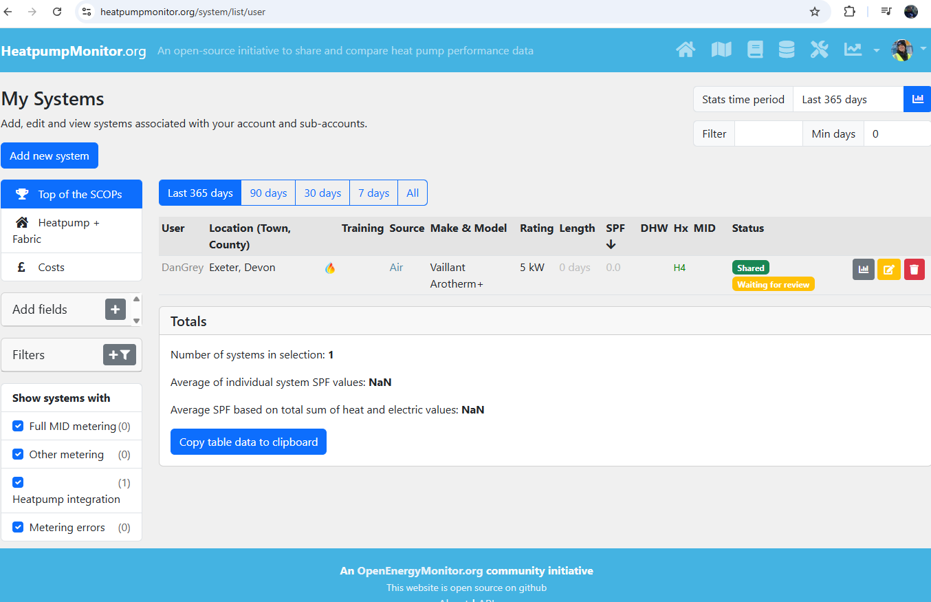

Next, I go the heatpumpmonitor.org. I log in with my emoncms.org username and password, click my profile pic, then My systems. I click the ‘Add new system’ button and under the ‘Select Emoncms.org dashboard’ header I choose ‘[my username]:[the name of the app I just made]’. I go down the page filling in all the details I can, including the read-only API key from emoncms. If the page won’t let me save I better just add some best guesses into the fields it’s not letting me leave blank. Then, when I press save, I should have a heat pump system system listed as a row on the screen, with the label ‘awaiting review’. If I click the graph icon I can see the emoncms chart and stats on heatpumpmonitor.org but no-one else can until the nice Mr. Hudson approves my system :slight_smile: .
And with that, all should be working!
