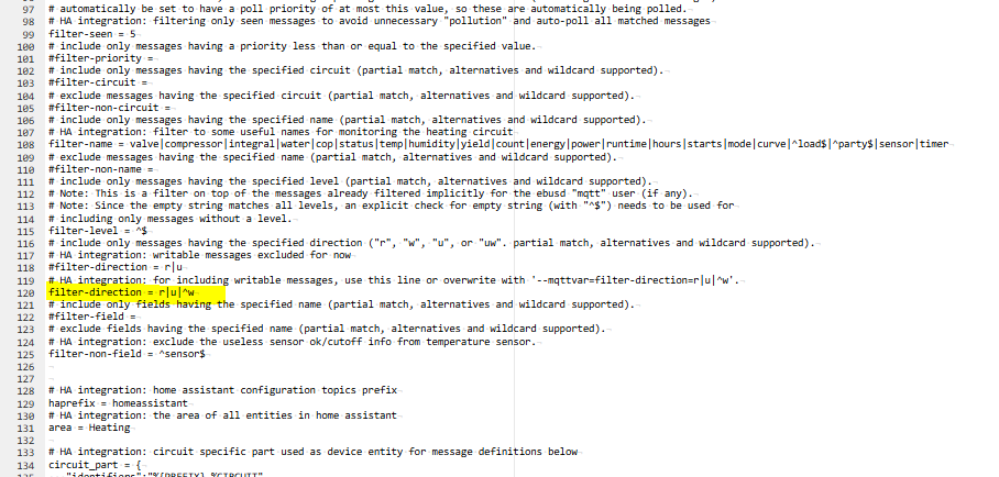

Hello everyone, can somebody help me? I have ebus adapter shield c6, home assistant running as haos on minipc, installed mqtt in HA, but I am not getting all the data that I can see on my wvzio live data monitor. I have also installed ebusd add on in HA, and in addon configuratiom tab, a config path is set to: https://ebus.github.io/; acces level: *; mqtt integration config file: etc/ebusd/mqtt-hassio.cfg.

so I have to change something in config file (maybe change to other repo, john30?) and/or mqtt integration config file to pull more fields? can anybody help me?
I would try with John30 repo indeed
I havent changed config file yet, I have installed mqtt explorer and when I publish ebusd/hmu/livemonitorcurrentsupplytemp/get, in the mqtt explorer I can see the value, but that is not presented in mqtt integration in home assistant, so my conclusion would be that I have to download mqtt-hassio.cfg, change (filter-name:? maybe) something in that file but I am not exactly sure what.
So you can see it on the broker but can’t see it in the HA integration?
There is no such thing (directly) as an MQTT Integration in HA (other than below). Do you mean this value doesn’t appear in this eBUS integration? In which case, it isn’t defined for it to decode it.
Try using a template sensor in HA and reference the MQTT topic/key/value pair directly. MQTT Sensor - Home Assistant
Be careful of teminology -
I think you men that using MQTT Explorer, when you Subscribe to the topic ebusd/hmu/livemonitorcurrentsupplytemp/get you can see it has a value of xx and this updates (is Published to the MQTT Broker by the ebusd) every x seconds?
yes it’s sometimes needed. I did to activate the Writing
Also there’s this issue : B511 message not yet decoded? · Issue #249 · john30/ebusd-configuration · GitHub that helped me somehow
