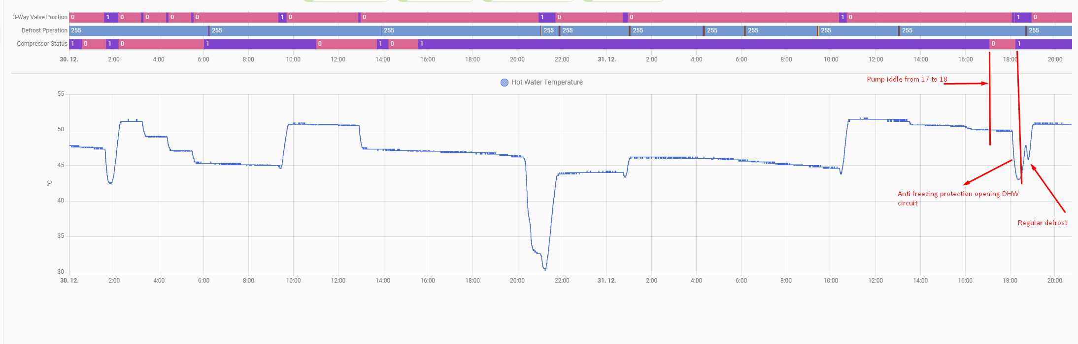

At 10:00 I’ve re-heated the tank to 50C and then barely used the hot water. But then at 17:00 thermostat turned off heat spacing and exactly after an ONE hour (just before I wanted to heat space again) this STUPID anti freezing cycle started, opened 3-way valve to DHW and took 5C from my HDW tank which dropped below 45C and immediately triggered the re-heat of tank again to 50C. As this is not enough, there was defrost cycle triggered as well. Now tell me this is not frustrating, basically I’ve lost all the energy I’ve put into a tank at 10:00! How a stupid circulation pump running for 6 minutes can steal 5C from 280L tank ??? Nonsense…
The pump should circulate the water over the CH circuit and not touch DHW but no, I can’t achieve that. Extremely frustrating.
When the pump is idle the flow and return temperatures are decreasing. Pump registers is but only at input and output of the pump. The water within pipes inside your house is still warm. So it thinks it needs to reheat so it start circulate the pump. This would be OK if not that stupid pump open DHW circuit to steal heat from it. A week ago I did not have a tank so of course it has no other possibility only to run the pump through CH circuit but it was absolutely OK. I even didn’t notice it but now I hell notice the DHW temperature DROP.

Just looked at the graph more closely - your defrost takes an HOUR ??? No wonder you see it as a problem!
Wow, this is really a big house and crazy heat loses. So good you have switched to the heat pump :slight_smile:
Nono, the system was in idle for 1 hours because there was no need for space heating or DHW. But this is some stupid Samsung implementation that after an hour if the outside temperature is below 5C it will run the circulation pump for 5 minutes and opens DHW circuit. So the heat is taken from the DHW tank.
Defrost takes only 3 - 5 minutes (second line in chart) and this is done with source which is active at that time. Defrost is not an issue. Anti freezing protection is because this one is running every hour if pump is not active. Before I had DHW tank it simply run the pump for 6 minutes and water circulated in CH circuit and no issues. Now it explicitly opens DHW circuit (look at the 3rd line chart) and takes heat from that. It there is -5C it can take 5C per single antifreeze run. Once antifreeze is completed in 6 minutes then it again close DHW circuit like nothing happen. Ridiculous implementation.

Exactly this is the issue. NO matter what if you have DHW enabled in field settings it will take heat from there during anti-freezing cycles which happens always when outside temp is below 5C and pump idle for more than hour and then they repeat in every hour interval. Pathetic…
This picture is form when I had no DHW. Circuit temperature drop is totally negligible during night. With DHW it is doing every hour taking heat from tank and causing unnecessary load on heat pump and components, noise, etc…,
