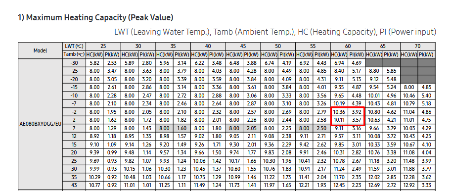

A bit simplistic maybe but the critical pressure & temperature of R32 is, (I think), 57.83 Bar.a & 78C, the properties I’ve had a look at don’t seem to go beyond 44.437 Bar.a & 65.6C, this means theoretically, that a 17:1 PR compressor discharge temperature would reach this 65.6C (at 100% compressor efficiency??) from ~ -30C & 2.61 Bar.a so around a outside air temp as low as ~ 15C. This Samsung PR of 17:1 seems massive, I thought around 5:1 would be more the norm which might mean that 65C discharge temperature might only be achievable at a outside unit evaporating temperature of ~ +3C and a ~ OAT of maybe 5/10C?. The compressor efficiencies will be a big factor in this though and a PR of even 3:1 might still achieve ~ 50C discharge temperature at a compressor efficiency of 80%, from a evaporating temperature of 3C
Welcome to the community :wink: These are indeed some nice numbers. The highest flow temp I’ve seen for a short time so far was 60.5C which is close to your theoretical maximum. Not sure if it can go a bit higher but at this flow temp the pump consumed 5.8KW of electricity which could be the max. of this pump. The temperature here was around 0 so wonder if in higher temps it could go higher. With 60 flow temp I guess max. DHW temperature could reach around 55C. But I guess it still could go higher since Samsung declared 70C of flow temperature. I’m yet to test it.
This is still not enough for disinfection cycle though so seems heater booster is really the only option.

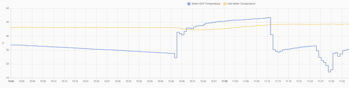

That’s right. Seems this requires lot of time to find it’s maximum and everyone’s system is different so it has to be fine tuned case by case. I have coil with surface area 2.9m2 so I would say kind of average.

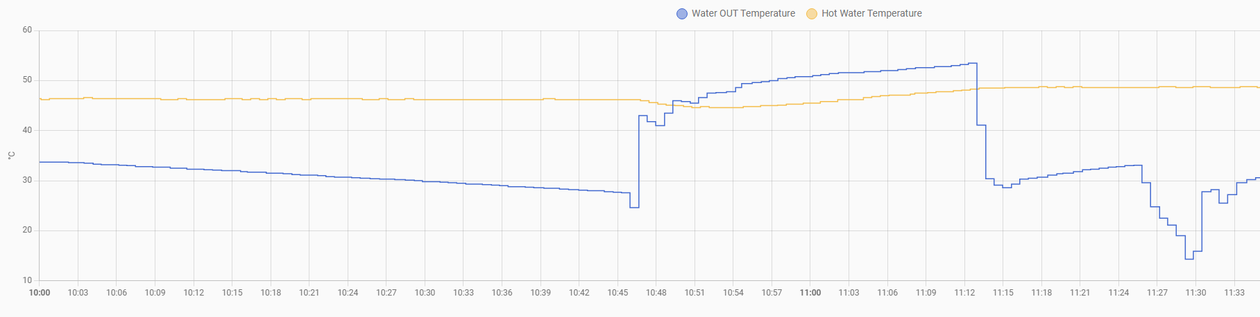

From my last run it was heating 280L from 45C to 48.5 (middle of tank) in 27 minutes reaching flow temperature of 53.5. so dT = ~5C which is not so bad. That time it’s not great though I would say.
In any case I would say it’s not good to torture pump like this and is better to buy a cheap 3KW immersion heater to do sanitation cycle once per week and keep the tank temperature at 48C.

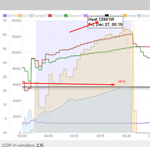

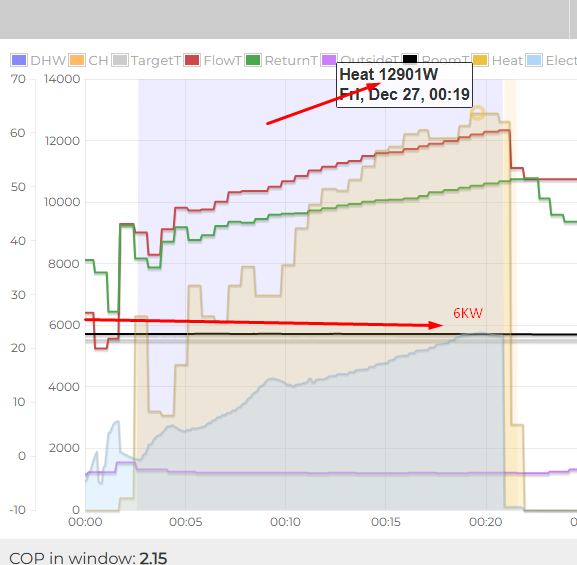

Yeah, but any idea how this is possible with my 8KW unit ??? Not that I’m complaining but looks strange.
This was not even a peak… According charts 6KW is consumed at -25C@65C flow temp. Something is fishy here.
It only requires 2.53kw (power) to heat 280L from 45.0C to 48.5C in 27 minutes, the trend shows a temp rise (between 1051&112hrs) from ~ 45C to 48C, say dt 3C in 27 minutes = 2.79kw, the water out temp/HW temp dT is ~ 6C so why does a 2.9m2 coil only emit apparently ~ 2.5kw?
Can you elaborate this more ? So is this good or bad ? What do you mean coil emits only 2.5KW ? Thx

The energy required to raise 280L of water from 45C to 48.5C is, 280*(48.5-45)/860, 1.14kwh, this took 27 minutes so the coil power required is 1.14*60/27, 2.5kw, the coil dT would be 7.25C at a flowrate of 5.0LPM, 3.63C at 10.0LPM & 2.42C at 15LPM. I would expect a 2.9m2 coil to emit well over 5kw even at that coil temp/Hw dT temp of 6C.
Have you a trend of the HP data for those periods, assuming cylinder heating only?

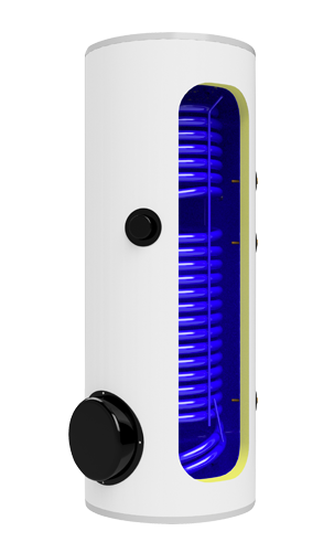

What if 2/3 of the coil is above the tank sensor?
What if the temperature in center of the tank while heating is not the same at at the edge where the sensor is?

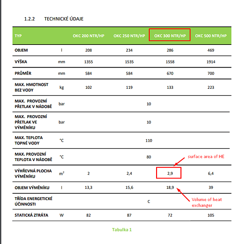

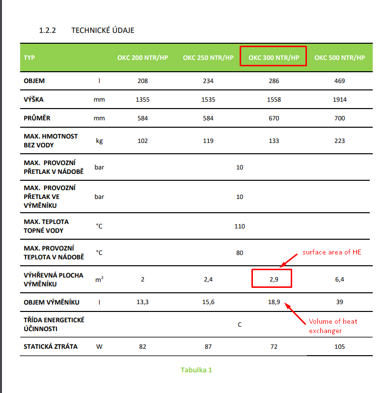

Hmm, that’s strange. The coil is definitely 2.9m2 with volume of 18.9l. Coil is running from top to the bottom of the tank. Here’s the specs…

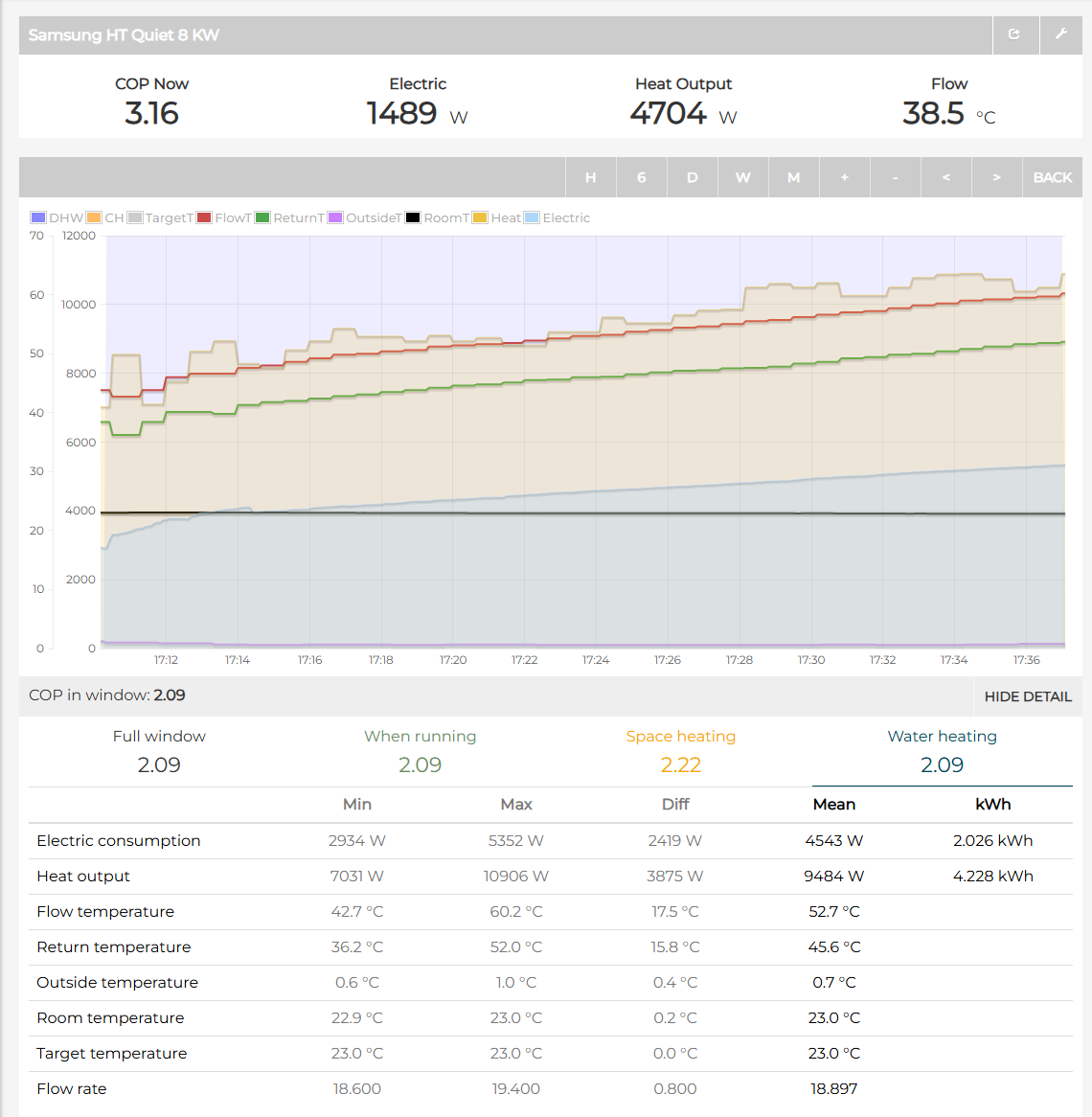

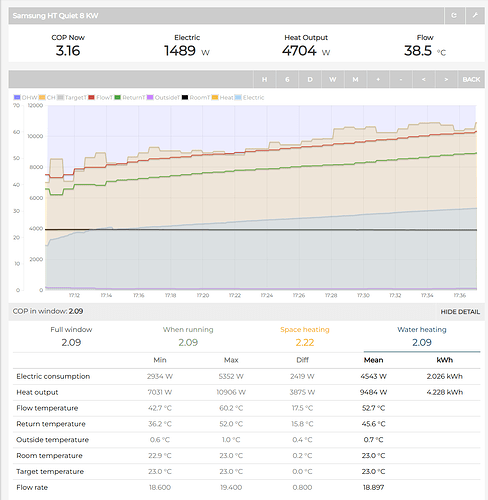

Let me share with you today heating cycle for 27 minutes heating water from from 43C to 51.5C.
Total heat output 4.2KW. Flow around 19l/min. Max flow temp. 60.5C
There is no circulation pump in DHW so I guess stratification takes it toll but anyway is this really unexpected ? That COP sounds pretty normal at ~0C outside and those flow temps.
@Ringi the temp sensor is right in the middle of the tank. Could be it is not in the center though. But from the screen you can see the coil is from top to the bottom. input of flow water is at the top, return bottom. I have 1" cooper piping but Max. flow is around 19 - 20l. I suspect there is some pressure loss on TF1 filter I have installed on return.
But something is really strange because from what I computed then heat needed to go from 43 to 51C is 2.61 kWh while emon shows 4.2KW was delivered. Also it would take around 9 minutes to heat this so no idea why mine took 27 minutes…
