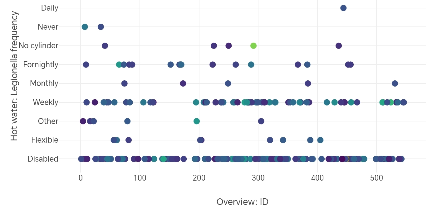

Many heatpump owners disable legionella completely.
A monthly cycle is probably a reasonable compromise if you’re still concerned about it. For more information, see Hot Water Temperature - Scalding and Legionella - HeatGeek

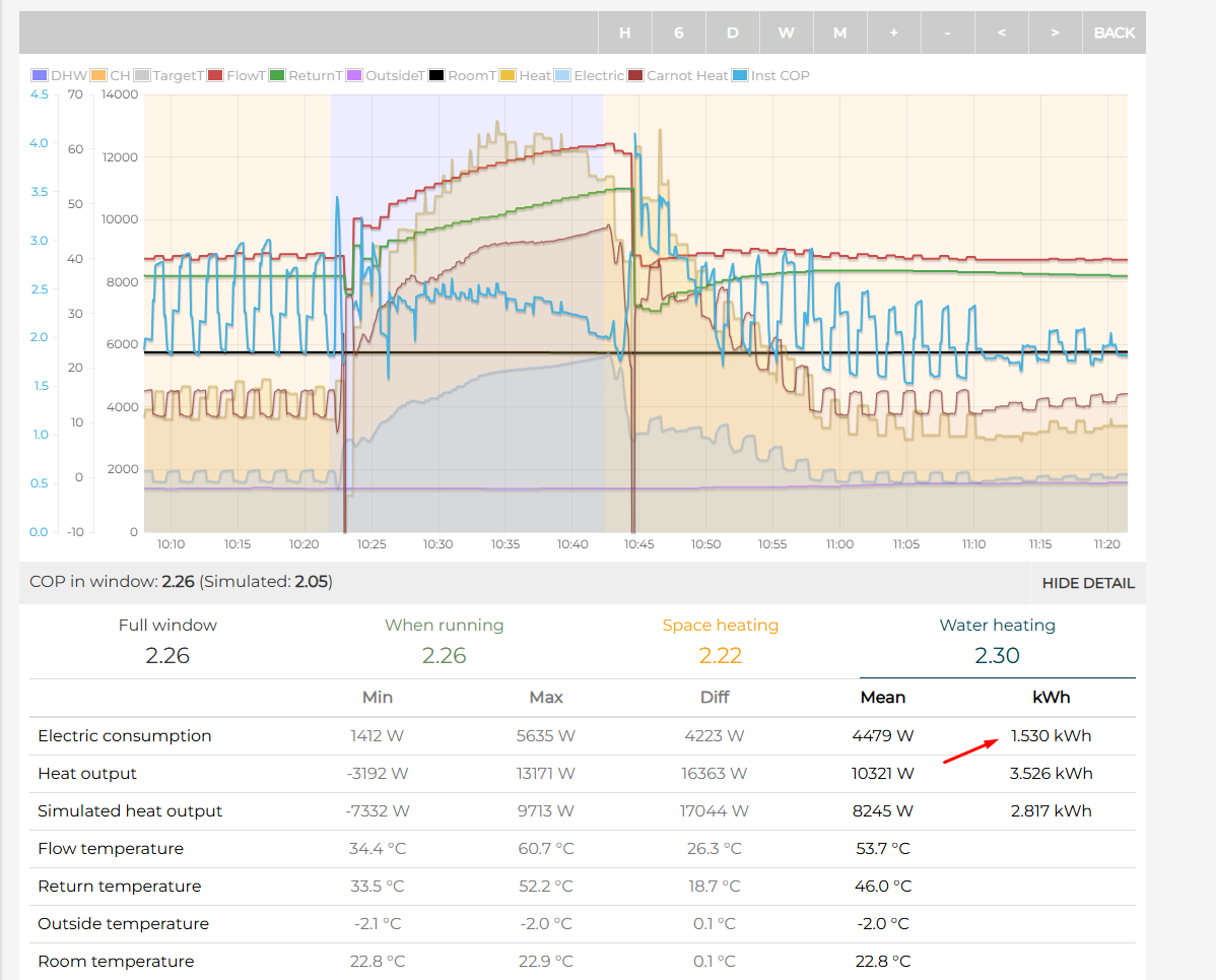

Where is the temperature sensor placed within the tank? How much kWh of heat was put back into the tank afterwards?
Have you considered increasing the reheat threshold to 10° or higher? COP will be higher when starting with a colder tank.
Thanks, I will have a look. Do you really think once per month is enough ? I’m not overaly concerned but I also don’t know what to think about this legionella in general. Never thought about it, never thought on my DHW temperature (electric boiler before). Scalding is not an issue here, I have thermostatic valves almost everywhere an d with e-boiler I had 70C set and never a problem also with small kids. But 70C is not efficient of course for HP. I would run as low as possible without minimizing risks of leg.
Sensor is place right in the middle of the tank. The coils is running from the very top to very bottom with 2.9m2 surface area.
This is what I’ve put into the tank and then antifreeze protection took it out… So around 1.5kW of electricity. Still could be the metering is not precise since this is using samsung’s data which might be not precise and there is some delay. So in reality it can be either better or even worse :slight_smile:

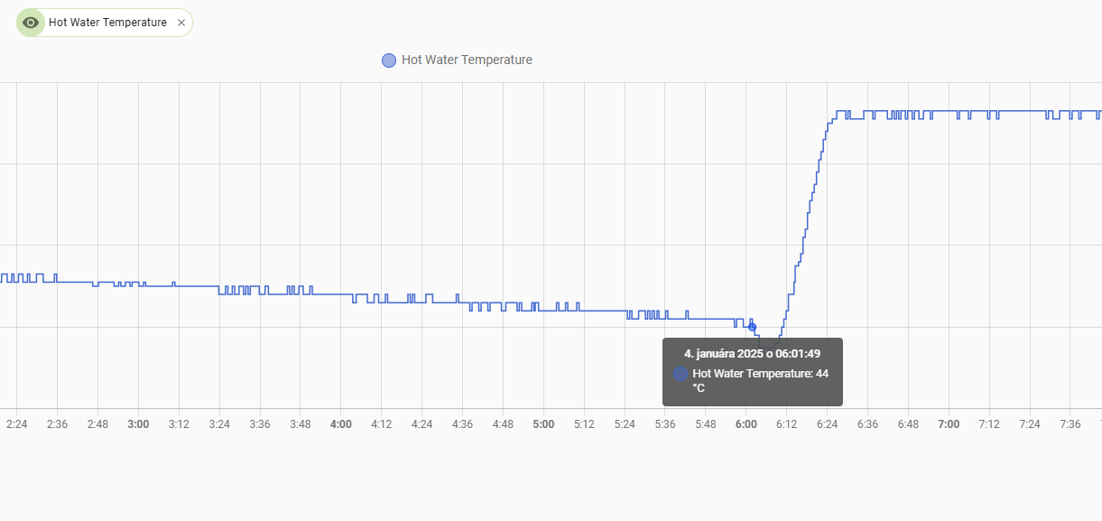

Hi guys, does anyone knows why heatpup started to heat water when temperature was 44C ??
In field settings I have START temperature set to 8C (STOP 0C), DHW temperature I have set to 48C so I would expect it would start to reheat when temperature drops to 40C. During night I had DHW turned off and it was turned on at 6:00 by automation but why the system start to reheat the water when dT was only 4C ??
@SarahH any idea ? thx.
My Mitsubishi would always start a DHW cycle as soon as DHW was turned back on, regardless of the current temperature. So maybe that’s what the Samsung is doing?
Hi @Michal_S.
I think @Timbones is correct, if you still have your #3011 set to 2.
The Installers Guide says:
  • If FSV #3011 is set to 1, the DHW operation starts based on the thermo on temperature, but stops at thermo off temperature.
  • If FSV #3011 is set to 2, the DHW operation starts, but stops based on the thermo off temperature.
I interpret this latter to mean that DHW will start as soon as your programmer asks it to, irrespective of temperature.

But indeed it’s probably because I have #3011 set to 2 - Hysteresis.
So if I understand Sarah, if I want to start exactly when water temp drops below 40C then I have to set #3011 to 1 and START_TEMP (8). Then SET_TEMPERATURE (48) - START_TEMP (8) = 40C. So it does not matter when I enable DHW (I have it OFF during night since I don’t need hot water that time). Is that right ? It’s pretty confusing how the manual is written.
You might be confusing yourself, @Michal_S, calling #3011=2 Hysteresis. Hysteresis is actually set by #3023.
Correct, setting #3011 to 1 should do what I think you want. Then, your DHW won’t start until the tank temp falls to 40degC (in your example) even if the DHW programmer enables heating earlier than this.
Exactly, thanks. I will observe this night and let’s see how it works :slight_smile:
