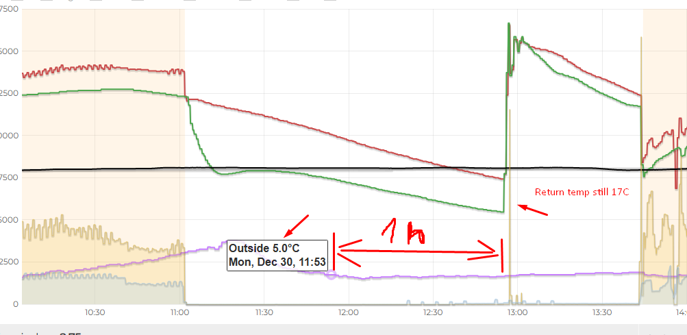

@SarahH Sarah, do you have any info about defrost operation values ? I can see sometime I have 1 - 3 - 7 and sometime only 2 - 7 so I wonder what this means exactly:
And here I have one correction. It’s below 5C and not 3C…

I expect Samsung is partly trying to prevent freeze protection values from operating, these operate at a few degree above freezing. (I expect the person who wrote the software would rather all their installations had their buffer tank setup.)
Don’t forget that this only kicks in when it’s colder than 3 (or 5?) degC (I know Slovakia can get much colder than southern England, but maybe this is still not that often). So maybe it’s not worth getting an ulcer over, though your idea of defeating the 3-way valve switchover with a relay might be worth a try if you don’t mind taking the risk…
Beats me - I’ve read the manual 10 times, and can’t see any effective difference between #3011 = 1 and #3011 = 2. Perhaps you should ask the Helpdesk now you have a contact name?
Seems to be 5 degrees but I will observe. But you are right, maybe it’s not worth the hassle since the temperature is bellow 5 maybe 60 days in a year, maybe less. We don’t have that much different climate at the end (besides rainy days :slight_smile: )
