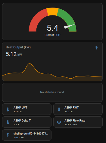

Thanks all for the replies. I have a Gen7 Integrated unit with the cabling from outside to in and into a Waveshare RS485 to ETH (B) POE device. The installer put a Modbus card in it and wired it. Not a 5 minute job to take the case apart and rewire it. I can talk the modbus card but it seems limited and rocket science to try and map the data you are looking for. Specifically flow rate. I can’t seem to find the registers to map for the pump info speed (%) etc. I think I have the compressor % mapped to the outdoor 6000 register space and I can then read it from register 4 and outside temp from register 6. They seem to match what is on the internal remote display.
Its a bit laggy. But usable. If anyone knows what the Pump registers are that would be great.
This is my test dashboard.
Cheers
