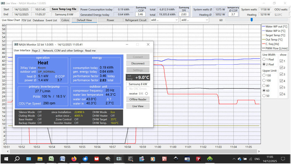

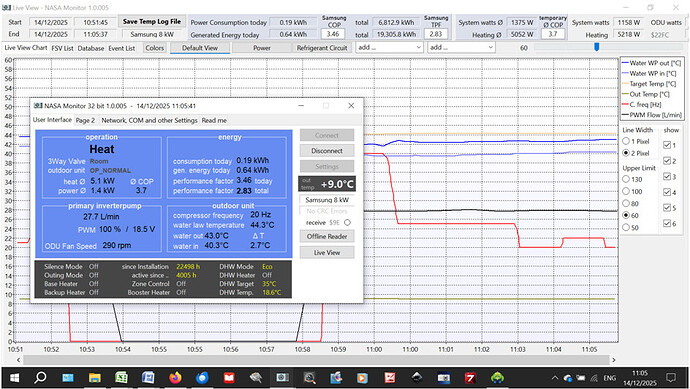

To whet your appetite for having a look at it, here’s a (composite) screenshot of its default display:
What you are looking at is the “User Interface” (UI, the box on the left) that displays the current key operating parameters, e.g. instantaneous heat generated (5.1kW) and power consumed (1.4kW), hence the calculated instantaneous CoP (3.7). The “receive” button on the right of the UI flashes when data flow is being detected.
By clicking on the UI “Live View” button you get the trendline view shown behind it. (You don’t have to have the UI obscuring the trendlines – click on the latter and the UI disappears.)
As you can see near the top of the trendline display, there are three standard trend displays – default, power and refrigerant circuit. Each of these displays trends six measurements, though you can easily add more (the “add …” buttons) from a predefined dropdown list. Between them, the UI and the 3 trend displays give you everything that SNET displays, with a far less clunky trend setup than SNET’s.
Also along the top of the trend view you get daily and lifetime heat generated and power consumed figures, along with their respective CoPs.
On the right you can select/deselect which trend lines are shown, and scale the y-axis.
Finally, like SNET, you can save a log file of all the data for later analysis.
The trendline x-axis compresses with time (i.e. the Connect time is preserved). Hovering your mouse over any line displays its value, as shown for the max. LWT on this screenshot (47.5degC):

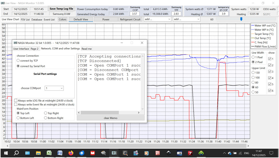

If you already use SNET, NASAmonitor should be a simple drop-in alternative. Once loaded, you can set up its connection to the MIM controller on the UI “Network, COM and other Settings” tab:
As SNET requires data access through a serial port, prospective NASAmonitor users need only choose Serial Port connection (rather than TCP) and the same COMport number that SNET is set for (though this means that you cannot run SNET and NASAmonitor simultaneously, of course.)
Selecting the TCP Connection button results in a request for a Port No., but I could not get this feature to work. This may a slight bug in the software, but more likely my own stupidity with data communication.
Considering that this is non-commercial software, NASAmoinitor appears to be very well-designed and pleasingly intuitive. If you fancy trying it, you can download the software (no cost) from https://www.heise.de/download/product/nasa-monitor-waermepumpe.

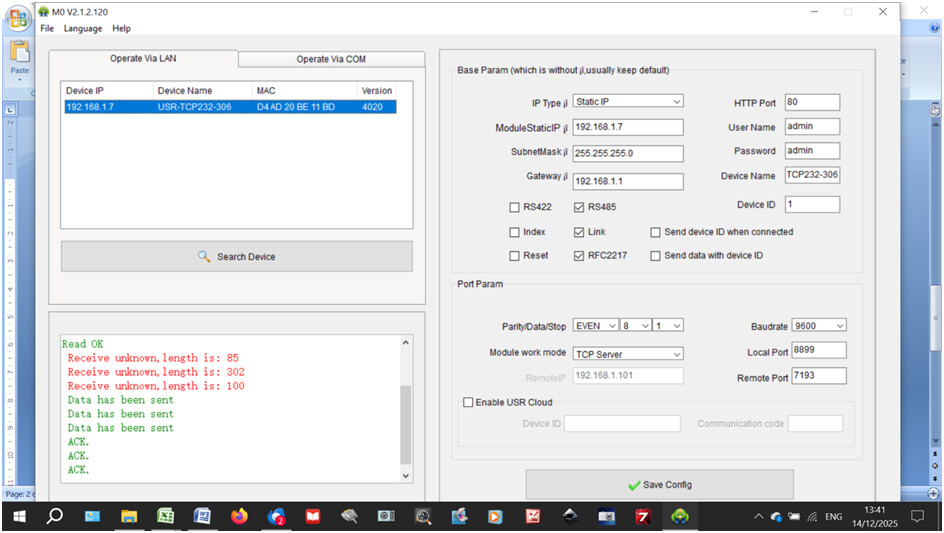

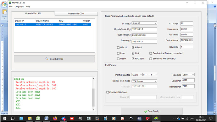

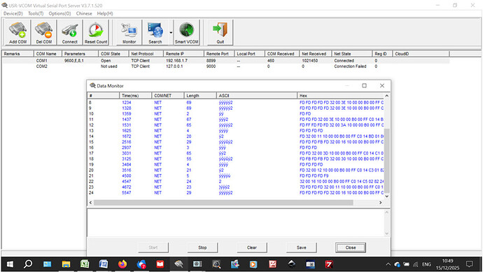

3. I settled on Static IP addressing rather than DHCP when configuring my adapter. The TCP232-306 comes with a default IP of 192.168.0.7. To connect the adapter, unless you change the SubsetMask, its third IP octet must be set to match that of your router (my router is 192.168.1.1, so I changed the “0” to a “1”). The fourth octet can be any number not already allocated to another device. In my case “7” was unallocated, so I retained the default for the adapter configuration, i.e. 192.168.1.7, as shown in this screenshot:
4. The Port Parameters should be set as above to match the MIM data stream. (The Local Port number is arbitrary, but numbers below 1024 should be avoided as these are reserved in certain devices and could result in conflicts.)

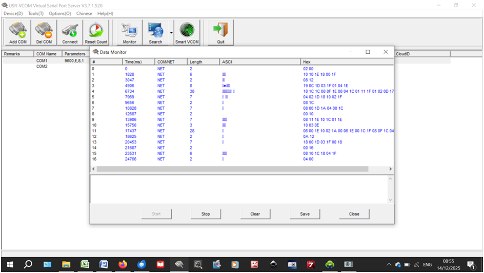

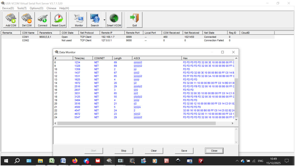

5. When configuring your VCOM, simply match the Remote IP and Remote Port to the adapter configuration values, as shown in this screenshot (ignore the COM2 settings – these are for another device which was disconnected at the time):
This screenshot also shows the Monitor data (the NASA serial data packets detected on the F1/F2 highway). The data shown (most starting 0xFDFD…) are normal.

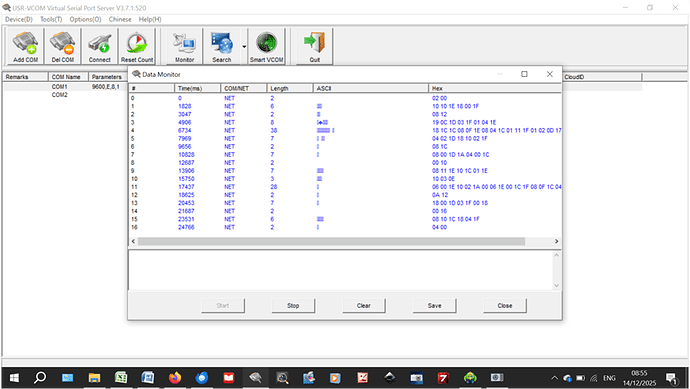

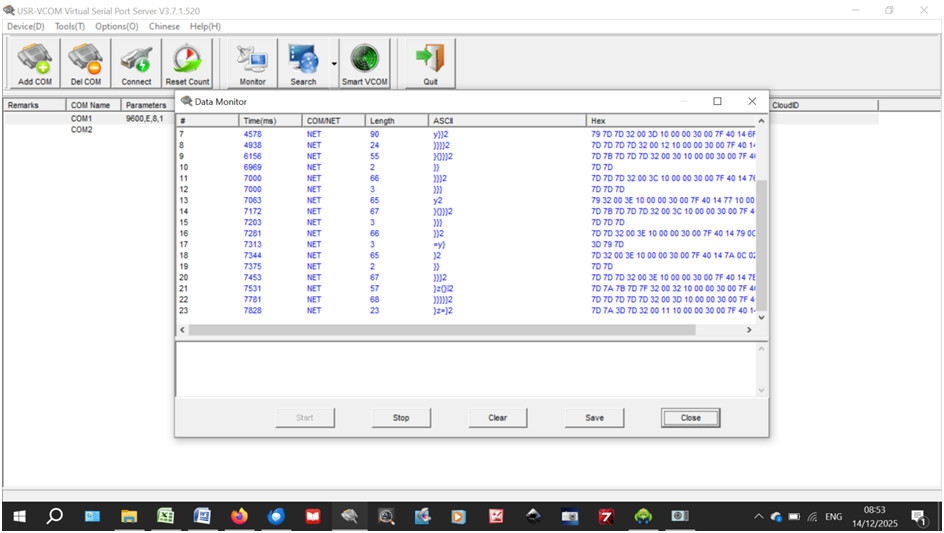

Sometimes initial startup of SNET or NASAmonitor results in data corruption, so that it looks like this (mostly 0x7D7D…):
In this event, disconnect SNET or NASAmonitor, switch the RS485 adapter power supply off and on again, and reconnect SNET/NASAmonitor so you get the normal 0xFDFD… on the VCOM monitor.
If you forget to disconnect SNET/NASAmonitor before resetting the adapter, you may get something like:
Unsurprisingly, neither SNET or NASAmonitor will work if confronted with packet data like these last two examples.

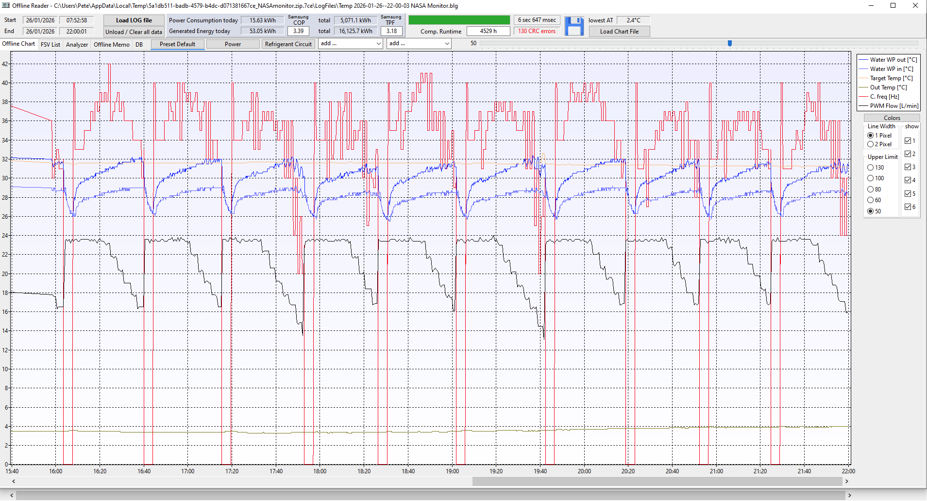

I’ve now got the NASA monitor working and its proving interesting reading. Not being very good at this stuff I cannot find out how change the resolution of the timescale of or even wind it back to the origin…is this possible?
Hi @JPB. One of the limitations of NASAmonitor is that the display start time remains fixed. As recording proceeds the time scale compresses, so if you leave it going all day it becomes ever more difficult to see what’s going on. AFAIK you can’t expand the timescale or rewind it.
I tend to restart the programme if necessary (e.g. I’m about to try an experiment) so I can capture the cause and effect in good detail. One thing I have discovered is that the Save Temp Log File button saves the screen as it is, allowing you to recall one or more “interim” screenshots more detailed study later.
Hi Sarah, Thanks for the reply. Suspected that was the case with the timeline, yesterday looked more interesting with multiple stops with the compressor not going below 22Hz before stopping but gone for ever it seems.

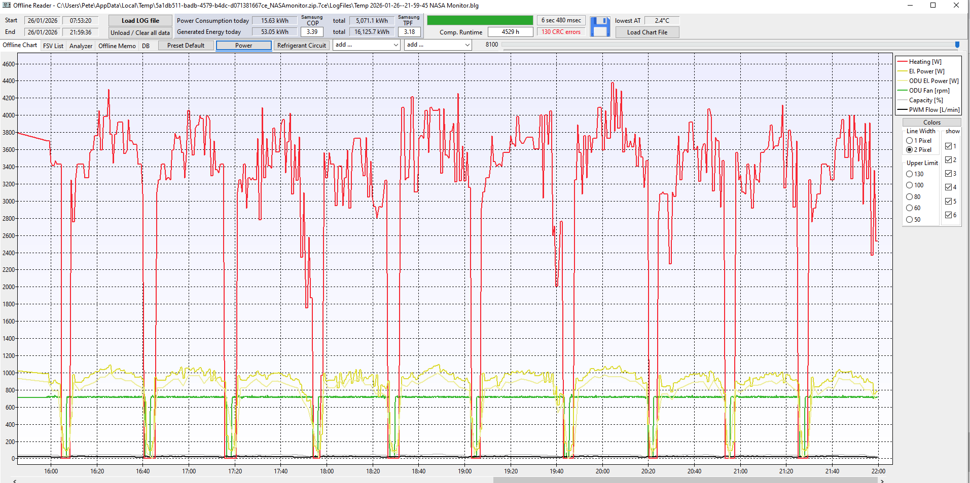

Used offline reader to view yesterdays events.
At first glance I would say that you have a very satisfactory operation there, @JPB. Your target LWT is much lower than mine so I imagine your CoP will be better as a result. The odd thing is that your comp is running at around 36Hz - much higher than mine. Can you pull up the Power trend for the same time period? It would be interesting to compare your power consumption with mine. Is yours an 8kW unit? (I forget.) And I can see that you operate PWM on your circulating pump. Do you see any effect on CoP (e.g. compare your CoP for the first half of each cycle when the PWM signal is 100% with the second half when it’s reducing)?

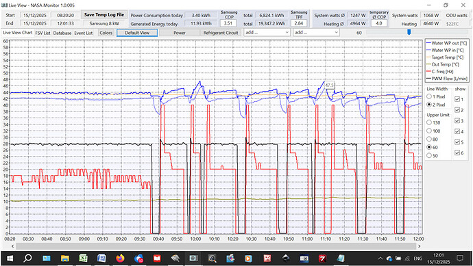

NASA monitor is impressive but also a bit frustrating as it doesnt quite behave as you would hope/expect. We have mainly UF so I’m trying to run as low a temp as poss with WL and seems reasonable so far, it also helps run direct without a buffer etc. Dont really understand why the compressor doesnt go lower in frequency which makes me curious that I’ve got some settings which are basically wrong or need twiddling a bit
According to HPM the cop was 4.2 at the time of the chart .

Didnt mention the pump…its left to factory setting so just pwm’s or sometimes doesnt…perhaps I should have it at 100% all the time as a trial?
Well that’s easy to test (just set FSV#4051 = 0). Personally, I’m not yet pursuaded that PWM control has a dramatic effect on CoP, at least in Samsung heat pumps. A higher water circulation flow - compared with the reduced PWM flow - decreases (LWT - RWT), so for a fixed LWT (due to WL) the average emitter temperature (hence heat released) will be higher. So in principle you could reduce your WL target (which would result in reduced compressor discharge pressure and thus reduced compressor energy) for the same emitter output, albeit at the cost of slightly higher circulating pump energy. Which of these dominates (reduced compressor energy versus increased pump energy) probably depends on your precise hardware arrangement, but I suspect that typically there’s not much in it - maybe not enough to justify the cost of a PWM-enabled pump in any case.
Hi Sarah, that is interesting. I find that my inverter pump often runs at 100% ( which is a very high value of 34l/min) whenever the LWT is too low for the emitters. As you say this strategy must be to try to get the maximum out of the radiators under certain conditions. This means in practice most radiator setups are likely to have the PWM pump running flat out in mild weather. I have the larger Grundfos pump as recommended by the supplier and it causes quite a lot of noise in the system. I have just turned 4051 down to 70% but still PWM controlled ( only option available I could find) and this effectively stopped the radiator noise and saves a bit of power. It does not seem to make any difference to the COP and the farthest radiators are still outputting correctly.
This winter I have increased my radiator output by 50%. I replaced three singles with doubles and one double with a triple all four of them with near silent speed controlled fans fitted. This throws the heat around the room even at 30C. I even added a bathroom fan heater from a UK company called Thermix (highly recommended). Every room, especially the bathroom, is now fully warm and the LWT is 5C less ( 30C to 45C) with corresponding improvement in COP. I do not expect any reduction in running costs because I am getting more home heating but it is the way to go for comfort if you need it.
The lower flow of the inverter pump still seems to work well with these larger emitters as long as it is balanced.
My pump also ran at 100% a lot of the time…then it would pwm…then back to 100% for hours.

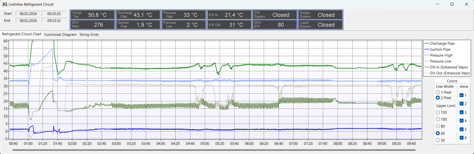

The performance of the Chart component leads to a - usable - limitation of 6 Trendlines. So with version 1.1 of the NASA Monitor there comes a new Chart Window: Refrigerant Circuit.
Now when pressing Button “Refrigerant Circuit“ in the “Live View“ You get this:

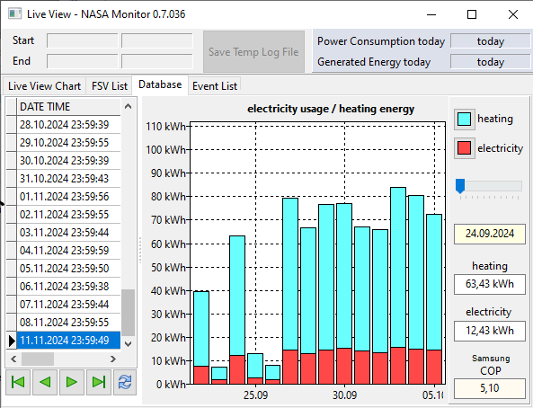

When running the program 7/24 the NASA Monitor captures Heat and Energy at midnight. And shows these data in a bar graph chart.
