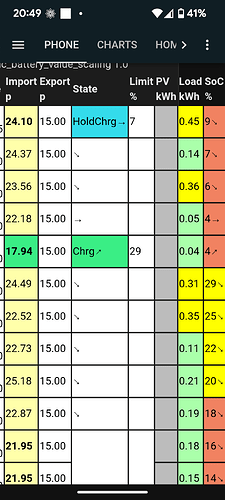

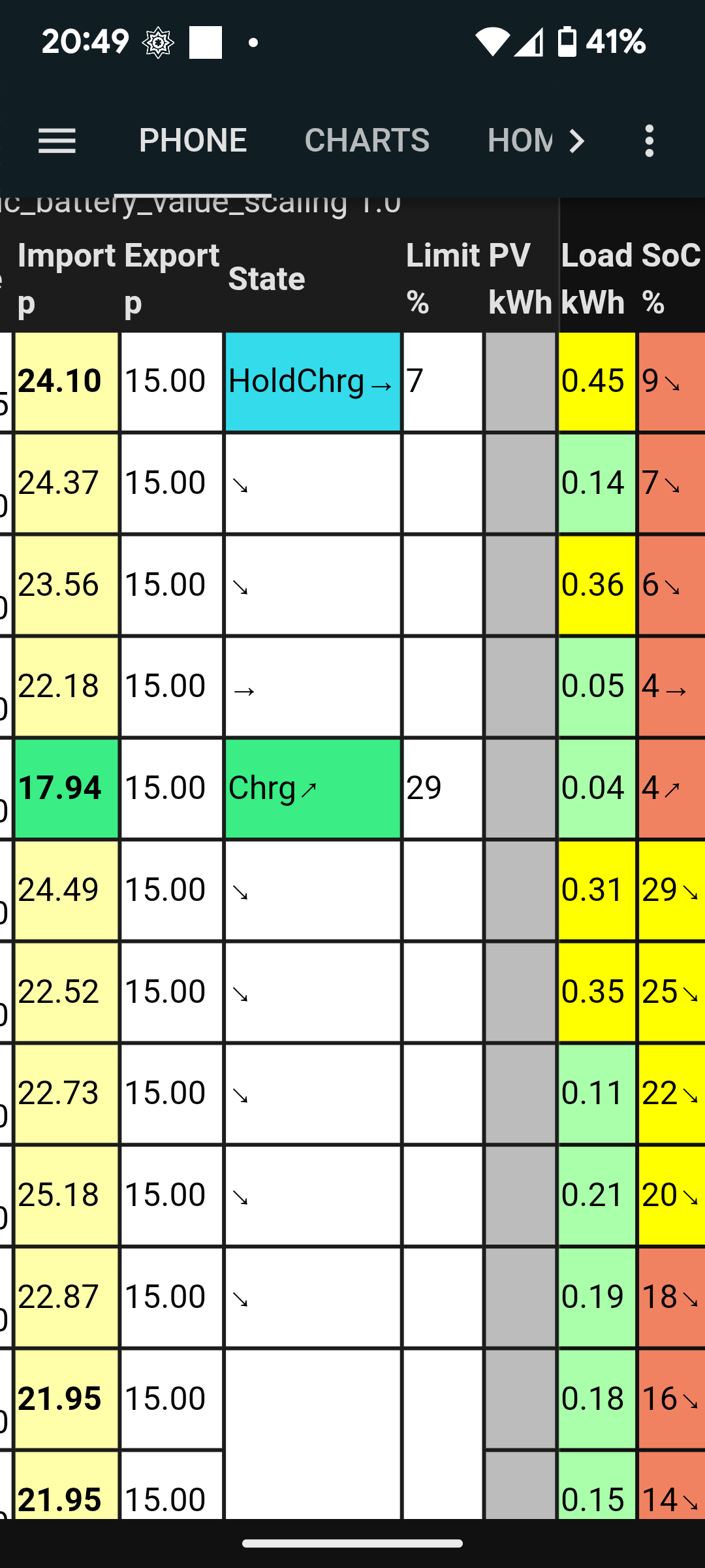

I don’t know if you’ve heard of predbat. Pradbat controls my battery charge, discharge, hold charge and export. Predbat calculates every 10min and changes the plan accordingly.
Uses octopus api and solcast api. Also reads my house load data.
Predbat is very clever. Takes a few days to setup but once it’s running you just leave predbat to it.
I’m trying to run the system as efficiently as I can.
Predbat can also control a ASHP and a car charger, but I’ll leave that for another day.
My lasts months p/kwh 20.63 on Agile. Not too bad as we’ve had 99p peak a few times over the last week or two
Predbat runs via homeassistant. I’m using a pi5 with 128gb ssd.

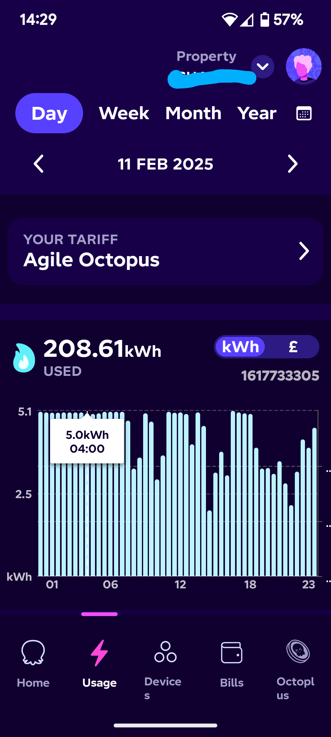

Hi all.
Heat geek won’t use my gas usage to design a ASHP. I understand that they have to be accurate and have confidence that my gas usage data is correct.
My local heat geek has proposed that we monitor the house using HTC testing. He’s waiting if head office will be OK using that method.
Any members had a HTC test?
Heat loss survey was 30kw
I use 34,000kwh of gas.

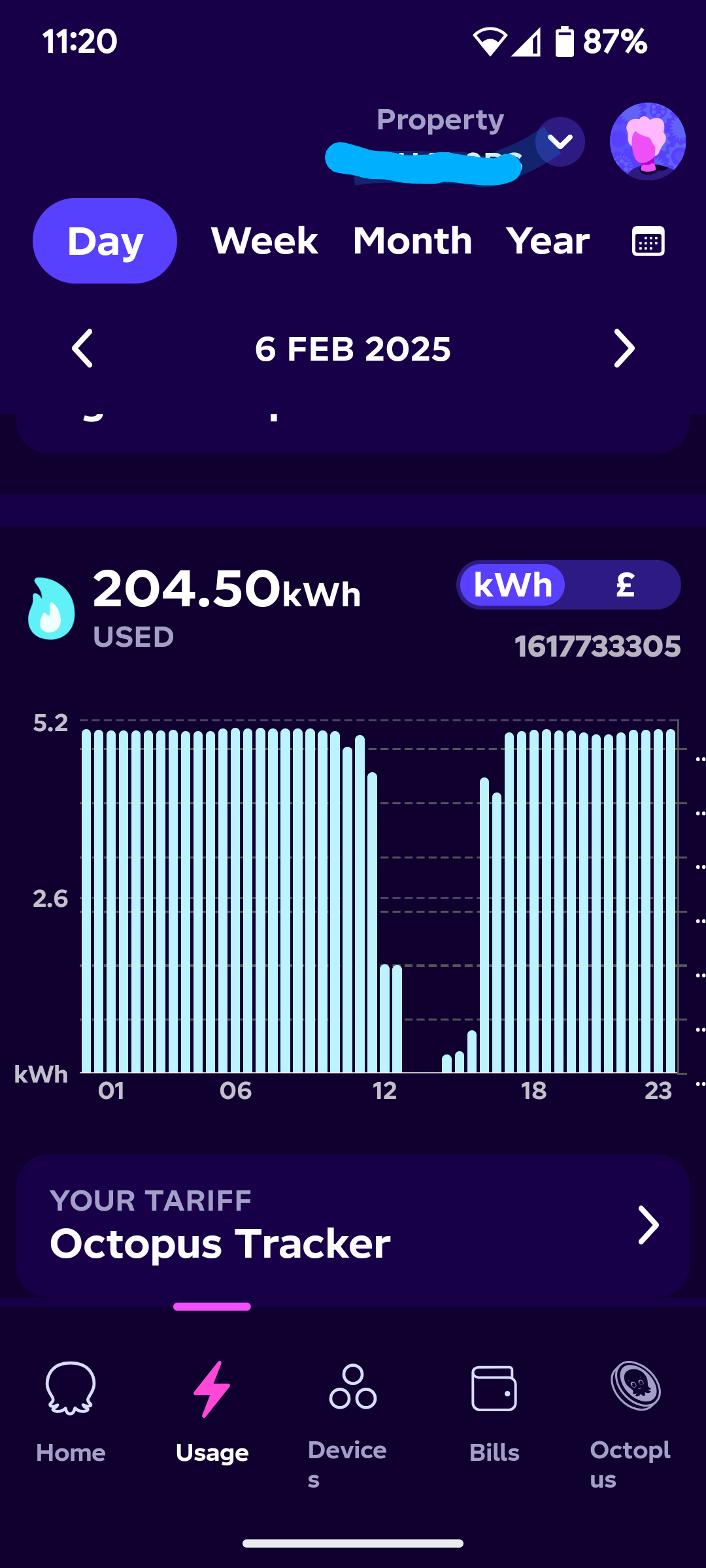

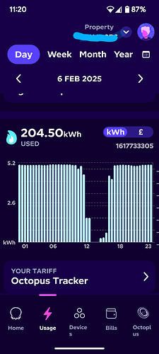

I’ve been running my boiler at 13.6kw 24/7 since 22nd jan
Nov 2024 boiler has been running 24/7 but boiler was still at 40kw but rad max was 50c
My boiler is a worcester 40cdi. Rad max temp 50c
House temp set to 20c.
Running 24/7 and comparing previous gas usage there isn’t that much difference when I was running on amd off method.

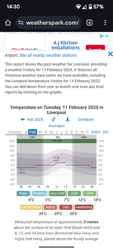

I’ve posted in this thread about my highest gas usage was at -5.
Looks like I’ll have to wait to see if heat geek will do a HTC test.

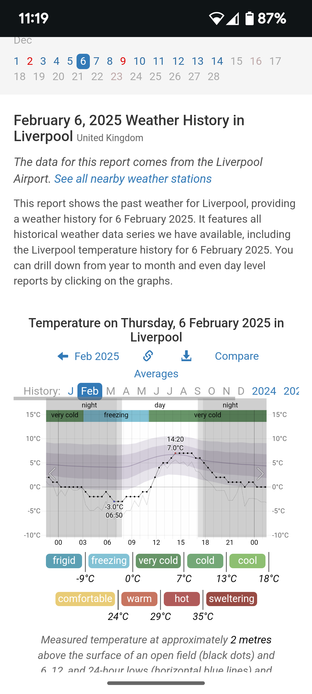

On this day -3c over night. House holding 20c.
