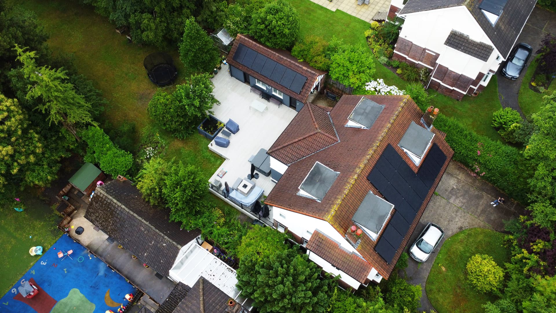

House is 6 bed.
306m²
9" solid brick walls.
New roof and windows in 2014.
I have 9.24kwp solar
10 kwh solaredge battery
6kw solaredge Homehub inverter. Dno 6kw.
System produces around 8Mwh. I exported 2Mwh last year.
I’m insulating the 116m² crawl space at the moment. Using ybs superquilt.
Boiler is a Worcester 40kw cdi. 17 years old.
I have a wood stove.

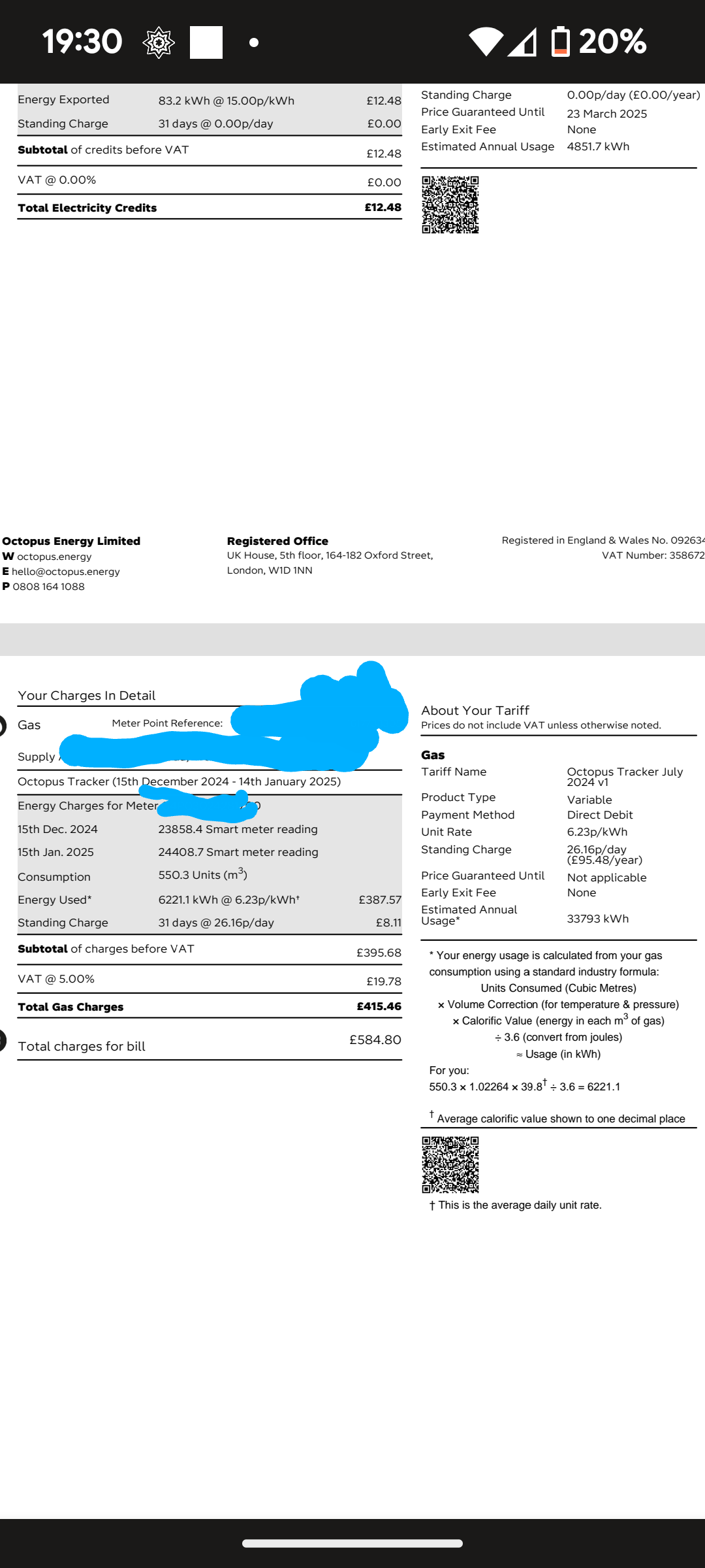

The bill for Dec, Jan was £415. Gas used 6221kwh. Heating was on 24/7. Internal thermostat was set to 20.5c. This is the worst case scenario.

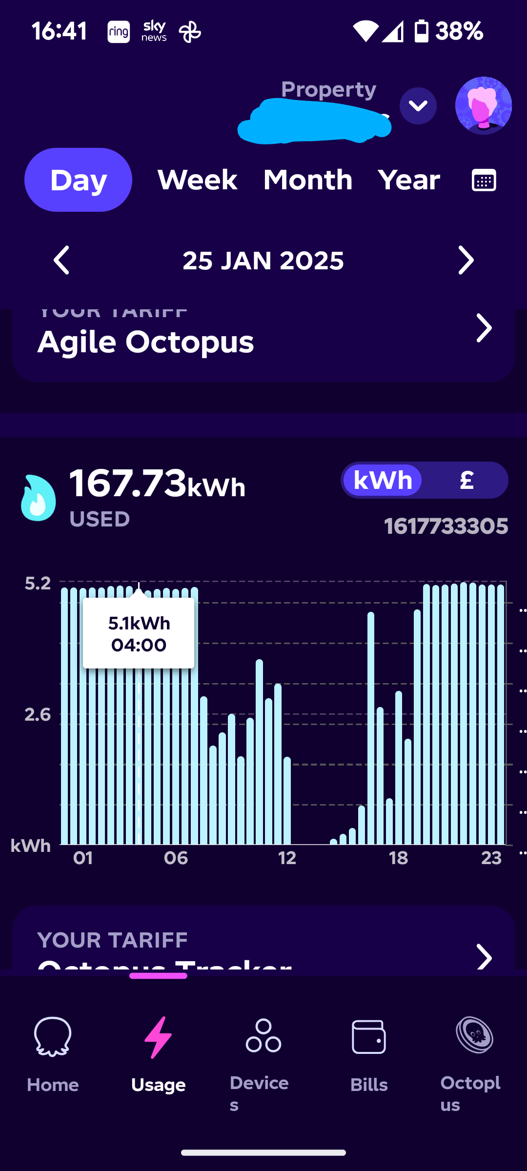

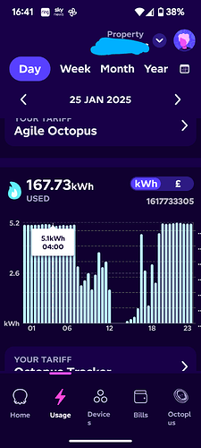

25th Jan used 167.73 kwh of gas. House was set to 20c. Outside temp was 0c overnight.

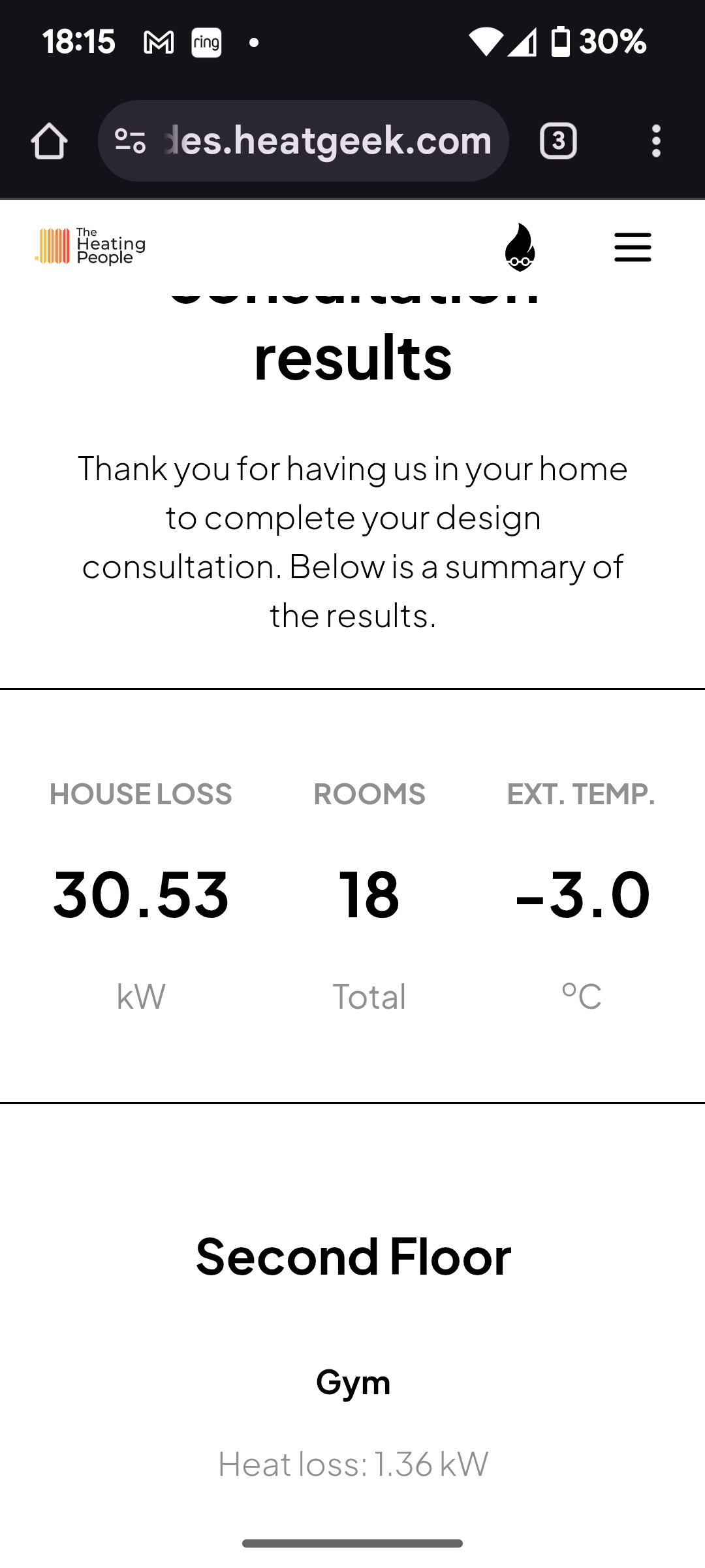

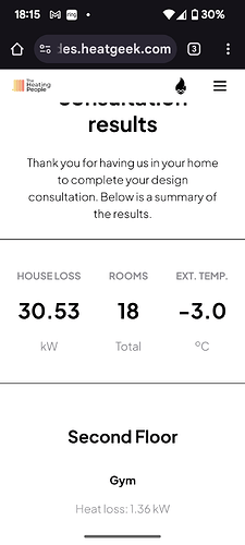

I’ve had a heat loss survey by my local heat geek elite installer and the heat loss was a massive surprise.
Any guesses.
(Just a small nit pick: you mean kW here if you’re talking about instantaneous power.)
Factoring boiler efficiency, the actual heating power is somewhere between 8 and 9 kW at 0°C. Extrapolates to around 10 kW at a design temperature of -3°C.
The 12 kW model seems a little oversized, but not unreasonably so given the size of the property. Having a big extra will help cope with defrosts.
What did the heat loss survey say?
Your property sounds similar to this one which HeatGeek and SkillBuilder did a detailed re-install. Checkout the two videos listed.
interesting @Alan_Bennett putting your house into Simple heat loss tool i get 15.5 kW assuming 0.6 ACH, -1.4C outside design temp and 23.8 kW assuming cibse defaults, what did the heat geek heat loss calc say?
Your gas day suggests 7 kW average on that day so quite a gap there…
Heat loss survey was 30kw. Ouch.

I also calculated the 7kW average for 25th Jan, but then realised that it was only 0°C overnight and warmer during the day, so figured it wasn’t representative of a cold day. It would be helpful to see daily gas consumption for the period around January 8-11th.
30 kW is ridiculous!
Ooo nice! Your gas readings clearly dont align with this but they also dont align with low air change rate assumptions in the heat loss calc and so I’d want to get a better handle of why that is.
  • 6200 kWh Dec/Jan = ~16500 kWh/year, half the 34,000kwh/year you mentioned above?
  • 34,000 kWh/year gas = 28900 kWh heat which is close to 12 kW.
  • Maybe the contribution from the wood stove could explain the difference to my 15.5 kW at least…

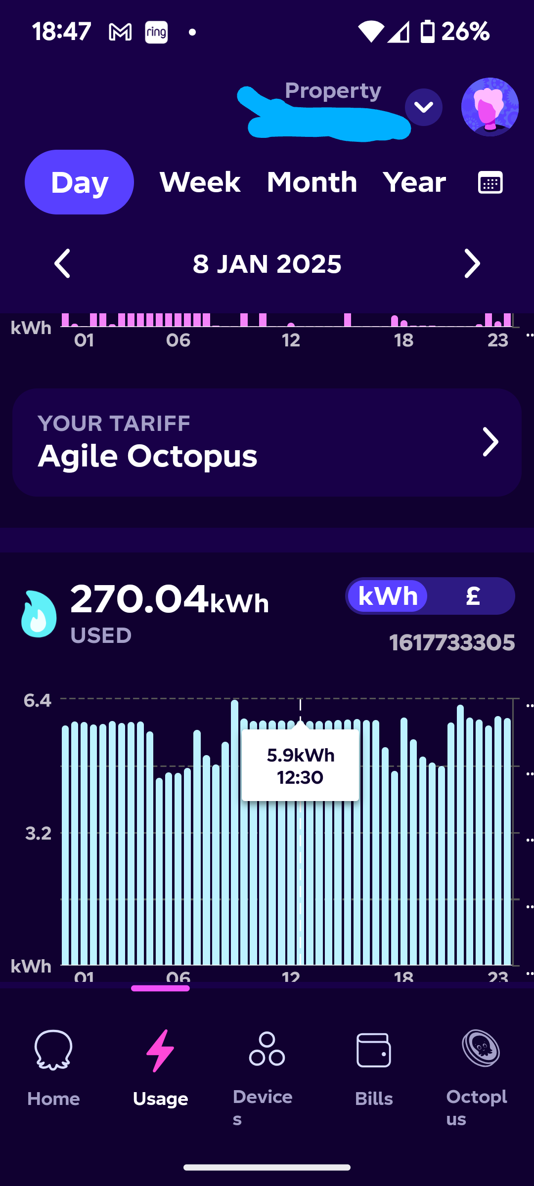

Jan.

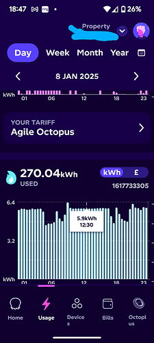

8th 270 kwh
9th 266.8 kwh
10th 259.2 kwh
11th 284 kwh.
On the 8th jan the temp range was 3c to -5c. 6hours was at - 5c. House temp was 19c at 8am with outside temp of -1. House temp didn’t increase until outside temp got above 0c
Boiler flow rate was reduced to 50c max on rads. Boiler was still set to 40kw.

The dips you can see is probably the hot water heating up. I have a 120 litre tank that’s 22 years old.
  • That’s more like it, so 11.8 kW gas, maybe 10.6 kW heat.
  • Aligns roughly with your 34,000 kWh heat/year
  • 6 ton bags is not 6 tons :man_facepalming: it’s more like 6x 350kg i think x 3000 kWh/kg = 6300 kWh… x 70% efficient stove = 4410 kWh heat. This gets us closer to the lower end heat loss I calculated of around 15.5 kW!

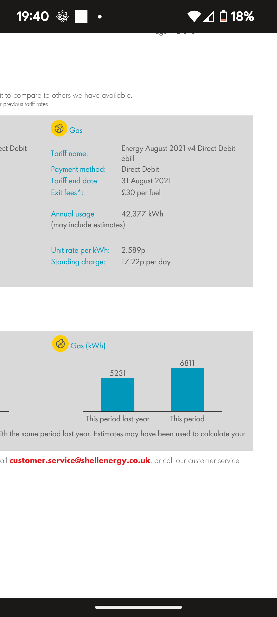

I understand that leaving the heating on 24/7 I’ll use more gas but I was surprised that I’ve used more in 2021 over the same 4 weeks.
Lastest bill.
I was working on the hall stairs and landing in 2021thats why gas was high that year and it was a cold winter.
Look at the gas price. Nuts.
