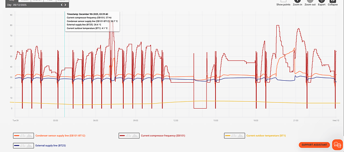

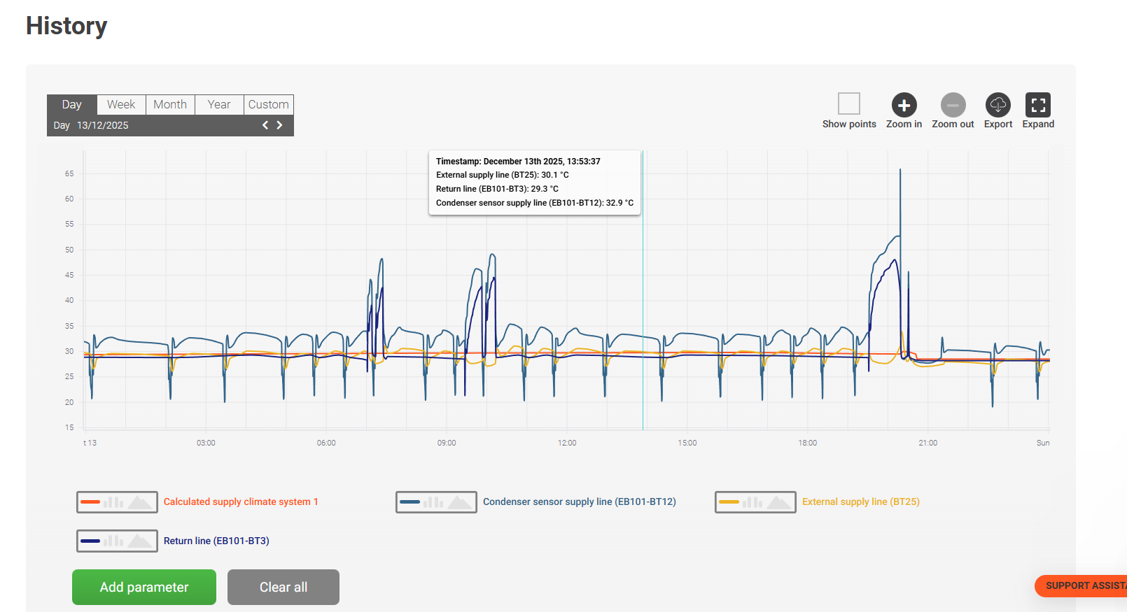

  4. The NIBE control algorithm calculates a Target Flow Temperature, S1, and then keeps track of how the Measured Flow Temperature, BT25, compares with that Target - including during defrosts and DHW cycles
    • Would you be able to post a graph showing S1 together with BT12, BT25 and BT3?

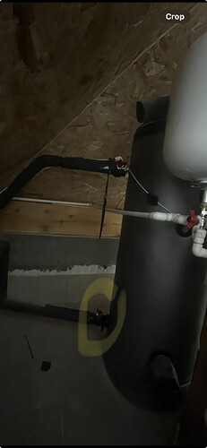

Are you able to identify where your BT25 sensor is physically located, and post a photo?
Yes, the BT25 is fixed on the pipework, basically from what I understand, I have the main flow trom the heat pump which goes into the buffer, at the middle of it I have a TEE pipe, one goes to the buffer the other one goes to the 2 UFH manifolds. Please see photo where is located

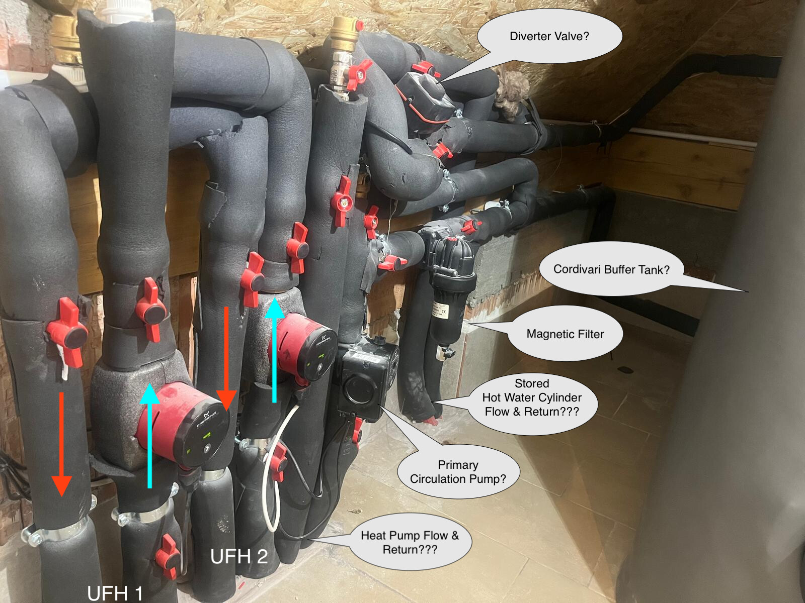

What doesn’t make sense to me.. if I have the main flow from heat pump and on the same flow I have that TEE pipe where it goes 2 ramifications, one goes to the buffer, the other one goes to the manifolds. What’s the logic here? Does it mean that at the TEE pipe I will have a mixing? I have used a thermocamera and before the TEE (where the main flow from heat pump is) I have a temperature of 32 degree let’s say, after the TEE (the ramification that goes to the buffer) I have 27-28. Then it means that the 2 pumps from manifols will get the water mixed and it is obvious it’s colder? Why my pumble would make such a setup? It doesn’t make sense to me.. What’s the point of the heatpump to make water at 32 degree and later on in the system to mix it with some cold water.

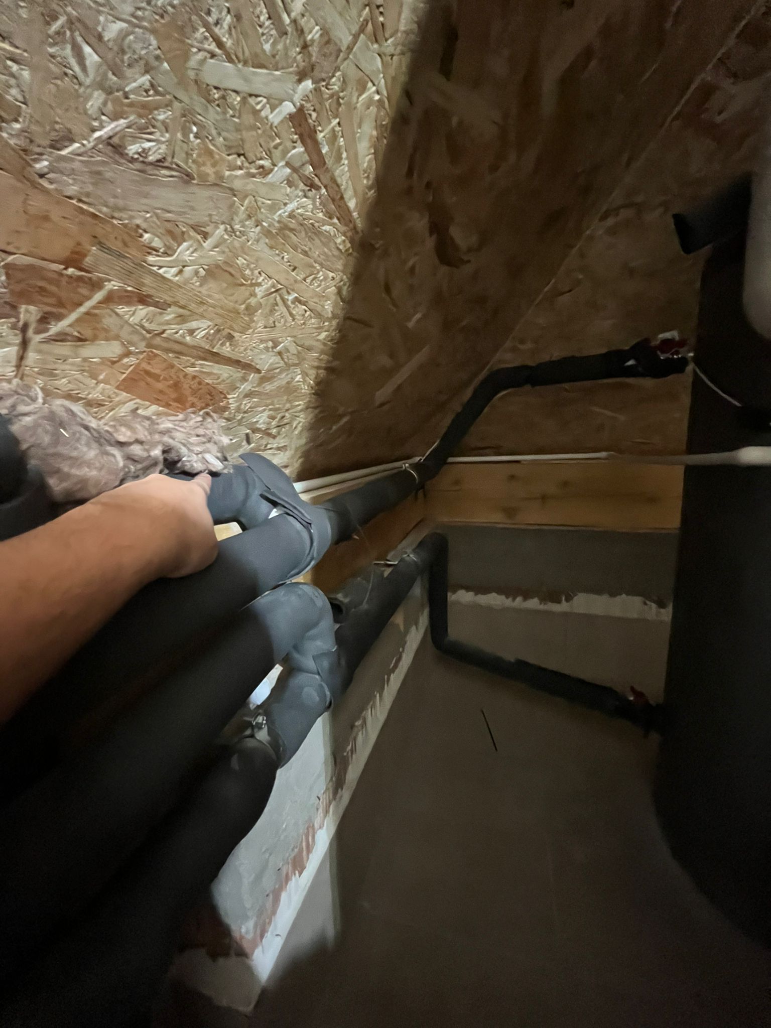

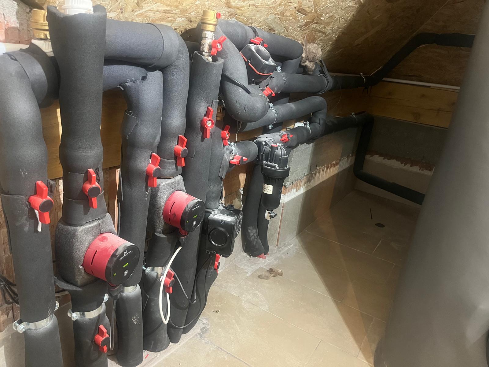

Please see attached general photos of my installation.
Thanks for your comprehensive responses to my questions. You do appear to have an unusual plumbing arrangement - especially for the buffer / volumiser tank.
Your graph showing S1 etc. confirms the NIBE control algorithm is (correctly) making BT25 follow S1 “on average” - but as you noted before, BT25 is often closer to BT3 (Return) than to BT12 (Flow) so the Flow temperature is higher than it needs to be, which will be lowering your COP.
Indeed. The Flow from the heat pump ought to go directly to the UFH manifolds, without being mixed with colder (Return) water.
My suspicion is that the interaction of the three circulation pumps is causing water to flow in unexpected directions so that BT25 is seeing more ‘Return’ water than ‘Flow’ water. Moving BT25 to a different section of pipe might be a partial solution - but since that won’t change the way the Flow and Return are mixing that would probably just make the house too cold.
Generally speaking, when there are multiple secondary circulation pumps (i.e. your two red Grundfos UFH pumps) - in addition to the primary circulation pump (i.e. the black one in your photo) - it is preferable to have a Low-Loss Header or some other form of “hydraulic separation” which makes the water flow more predictable.
Your pipe insulation is much better than most installations I have seen but that makes it difficult to understand all the pipe routes and connections from one photograph:
  1. The UFH connections are clear enough and I believe the two red Grundfos pumps will be pumping ‘upwards’. (I have the exact same pumps and their flow is ‘away from’ the electrical connection; you also have an ‘up’ arrow marked on one of your pumps.)
  2. I didn’t ask about stored hot water (DHW) before but based on your graph and your photo that looks like a typical NIBE arrangement, with a Diverter Valve on the heat pump Flow feeding a stored hot water cylinder - which I presume is located elsewhere, connected via one of the pairs of pipes which disappear into the floor?
  3. The heat pump Flow and Return must then be on the ‘other’ pair of pipes into the floor - but is that the one near the UFH pipes or the one by the Magnetic Filter?
Do my notes on your photo match your understanding or do I have some of them wrong?

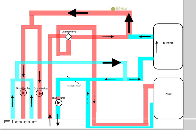

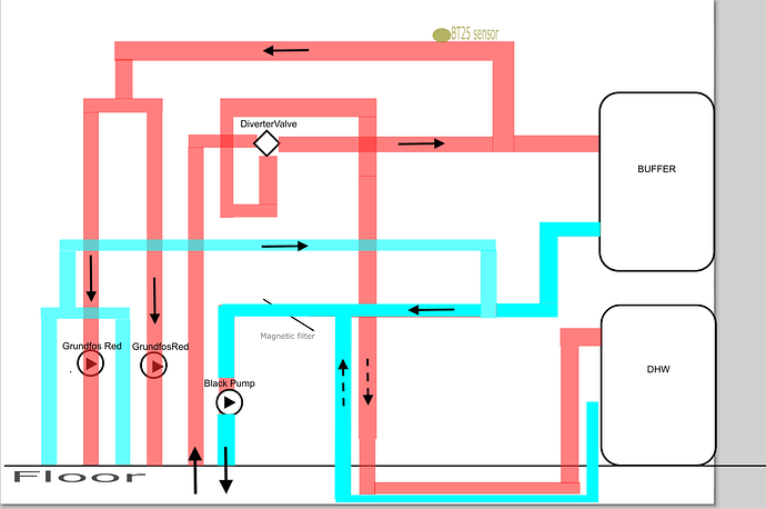

It would be very useful to have a simple schematic sketch which shows the pipework connections - especially how the buffer tank is connected and the source of the water flowing past BT25. It’s currently not clear to me whether the buffer tank is plumbed as a ‘bypass’ between the Flow and Return or if it’s ‘in series’ on one or the other.
David

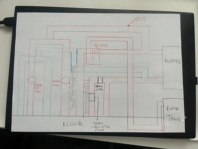

I have also tried to draw a schema manually and one with a digital tool.
Thanks. The video isn’t loading for me but the schematic is enough to go on for now.

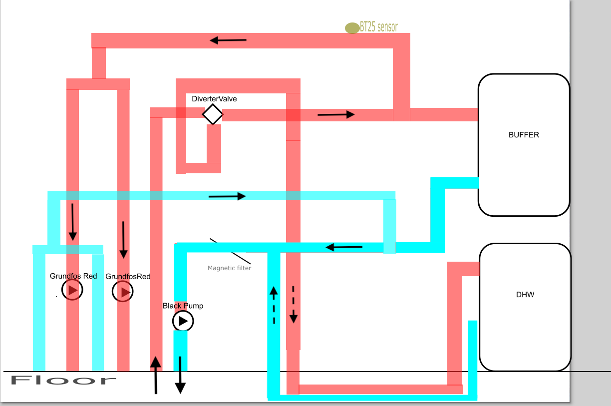

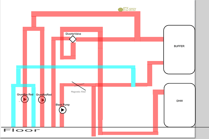

I’ve added some more colouring to extend what you had for Flow (Red) versus Return (Cyan) and some arrows for ‘intended’ flow direction. Typically the Black pump is on the Return to the Heat Pump - and the Diverter Valve must be on the Flow from the Heat Pump, which tells us which pipes are which.

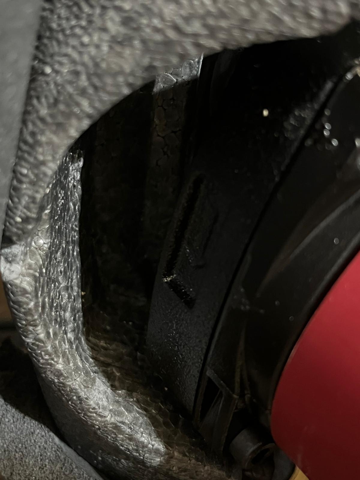

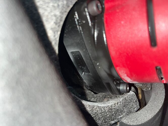

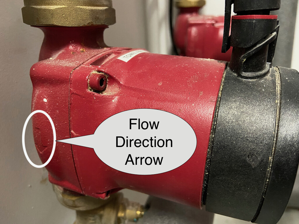

One obvious question is whether the two red Grundfos pumps are indeed pumping ‘upwards’ as I previously thought, or if they are pumping ‘downwards’ as seems to have been intended, based on the pipework layout
If these two pumps are pumping ‘upwards’ then they’re effectively on the Return from the UFH, not the Flow to the UFH - which would mean BT25 is seeing the water after it has been through the UFH - which could certainly explain your low BT25 reading.
To confirm the pump flow direction, you will need to check the arrow cast into the metal body of the pump. That’s under the grey polystyrene insulating cover. Here it is on my pump (which doesn’t have an insulating cover).
Hello David,
Your updated schema is perfect and I think it reflects the reality. I can confirm that on both pumps the flow direct arrow is downwards.

OK, so the two Grundfos pumps are pumping in the “correct” direction (downwards) (and my previous annotated photograph with the red and blue arrows was wrong).
That suggests you have a situation more like the following, where there’s some ‘Return’ water coming back from the Buffer Tank, mixing at the ‘Flow’ Tee junction and reducing the temperature at BT25 (and for the UFH):
(The logic behind that conclusion is that there are two Red pumps running in parallel for the UFH, but only one Black pump for the Heat Pump - and as you noted before the Heat Pump is 15m away, on the Ground Floor.)
Closing the Buffer Tank valve(s) would be useful as a test, to see what effect that has on the readings for BT25, but note that will result in additional flow through the Heat Pump heat exchanger which it won’t be expecting. It’s possible that might trigger an alarm condition in the NIBE controller.

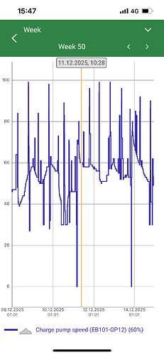

I’d be interested to see how ‘fast’ the Black Pump is being driven by the NIBE controller. Are you able to graph the data for that? In NIBE terminology that is the Charge Pump and there should be a reading called something like “Charge Pump Speed” which is a percentage value.
Typically, the NIBE controller adjusts the speed of the black pump to maintain a specified Temperature Difference (DeltaT) between Flow and Return, but there are configuration settings in the NIBE menus to have it run at a fixed speed instead or to set Minimum and Maximum speed values.

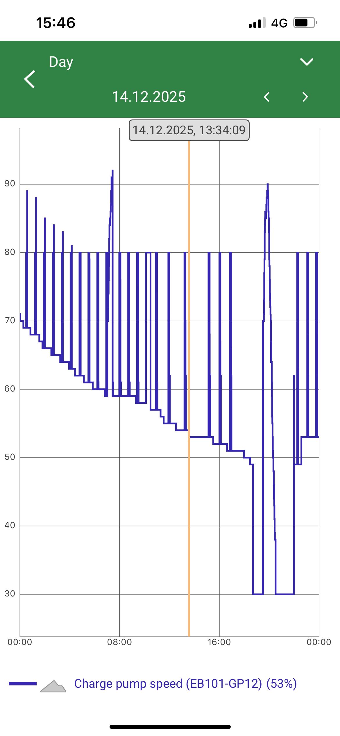

Hello,
Attaching 2 photos with GP12 charge pump. I keep this under observation in myUpLink view, usually in ‘heating’ mode it runs between 50-60%.
In DHW it runs faster, 80%+. During ‘defrost’ it also peaks to 80%. Worth mentioning that during defrost BT25 drops with almost 2 degrees.. so what I have achieved during a heating cycle it gets lost during defrost and it has to pick it up again in next heating cycle.
The GP12 pump it’s set on ‘auto’ with min speed 15% and max speed 100%, speed during waiting time 30%. I was thinking as well to switch it to manual and set a fixed speed starting with 75% and see if there’s any improvement. Would you recommend that?

Thanks for the GP12 Charge Pump Speed graphs. I was wondering if the pump speed might be really low (e.g. 20%) but it seems to always be over 50% while it’s heating - which isn’t crazy, but since the Charge pump is being ‘overtaken’ by the two Grundfos pumps it should be higher than 50%.
I would suggest trying a much higher speed while it’s heating. Mine typically goes to 100% (in ‘Auto’ mode) during a heating cycle, and it’s more like 60% during a DHW cycle, so there’s no issue with it handling a high speed. (The other option is to reduce the target DeltaT setting so it automatically runs the pump faster while heating. I changed my DeltaT from 7 to 4.)
30% pump speed while ‘Waiting’ is higher than it needs to be. I believe 30% is the default but a discussion on another NIBE thread settled on 10% as being more appropriate in most cases.
