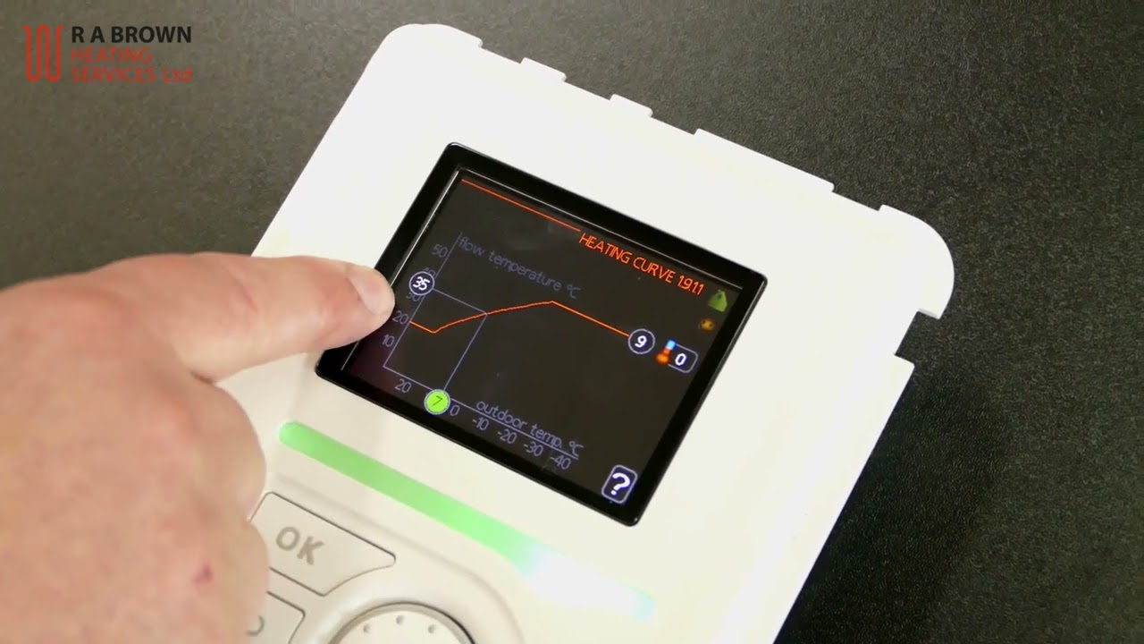

You could use trial and error with the leaving water/flow temperature drop/offset amount in degrees C (obviously timing to match the thermostats schedule).
Or do you know/have access to the weather compensation curve on the controller? A photo may help us better understand this if you’re not sure.
I’m not familiar with NIBE, so maybe others with a NIBE can assist, but this video may help in the above point if you have the same/similar controller.
