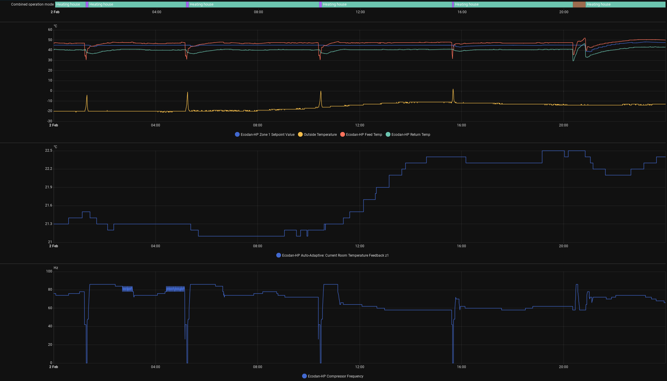

I dont have graphs for your temp ranges, as i only started using gekkekoe’s AA couple of days ago, but here is one for colder temps. (I am still tweaking the settings)

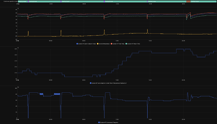

I edited the image to include the feed and return temps. You can see that the Auto adaptive system is adjusting the flow setpoint (the blue line in the first graph), according to the return temp. But like i said, none of that will fix the minimum frequency vs outside temp issue, it can only alleviate, at most.
Should be according to the feed temp, because the FTC will use the delta between Setpoint and Feed to trigger the micro-stops
Looking at the graphs, it is pretty clear it is being based on return temp. Maybe it is because i have buffer tank (1 zone), but the docs seem to confirm my observation
Calculate Target Flow: The final target flow is calculated based on the real-time return temperature. Calculated Flow = return_temp + target_delta_t
Ah yes, it seems to agree with the documents

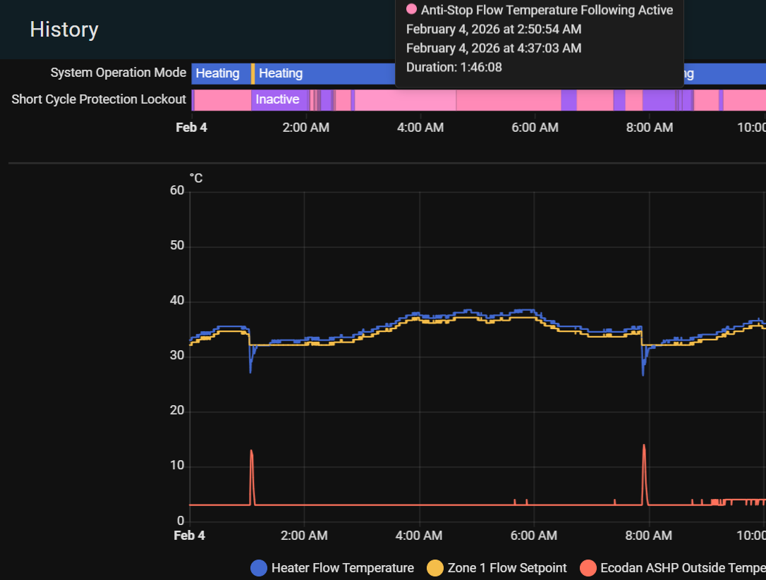

But this itself would not mitigate cycling as it’s not the condition the FTC would use to stop the outdoor unit
It seems that coincidentally raising the flow based on the return keeps the Setpoint vs. Actual within the FTC limit
Didn’t see that at first, I’m still using built in advanced AA on FTC6 v20.01.

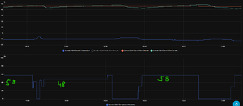

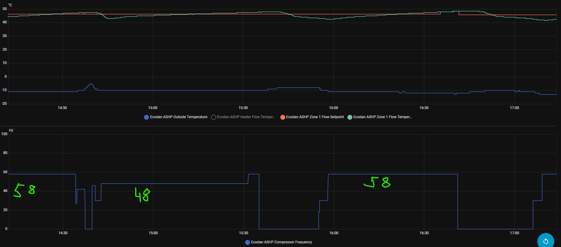

There’s a very strong indication that the pud/puz units have certain frequency based on outside temp. I have seen folks getting higher frequencies when it gets colder, it won’t go below. Only ‘fixable’ via fake NTC I guess.
From my observations the minimums :
0?…-10 = 48Hz
-11…-24/25? = 58Hz
-24/25?…? 64/68Hz
There seems to be some preheating/ramping about 3-4min with 30Hz below -11C
