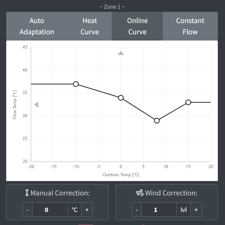

I am delighted that MELPump has built an easy-to-use online curve designer directly into their app to help users with this feature (expected to be generally available next week)

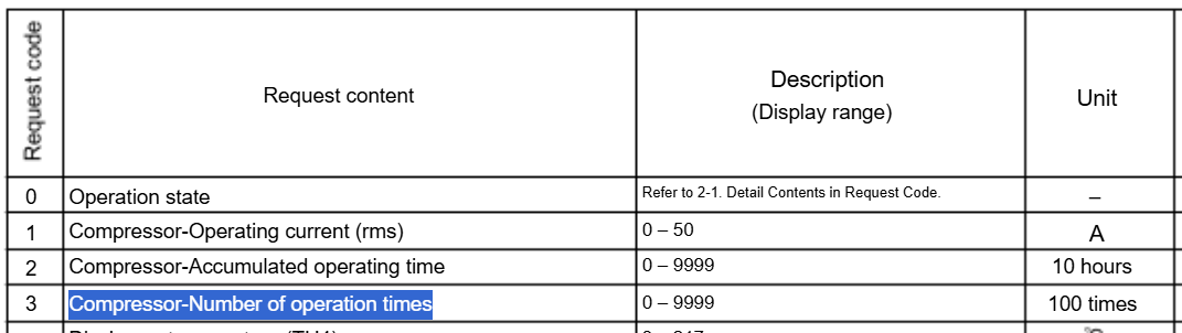

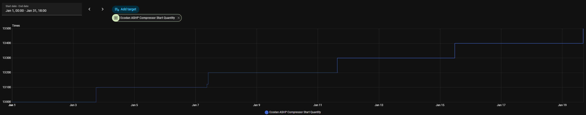

@F1p is there some specific reason the start quantity is odd number or is it just me? Running latest 6.5.5. was the same on 6.3.5
Also is it possible for the device to write time to HP and/or toggle daylight saving feature :eyes: . I’m running DHW schedule on the HP, I could move it to server control and add some script.
For example at first S3 would get time from HP, then compare to HA and updates it if neccesary.

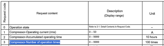

The Units from Mitsi side are in quantities of 100:

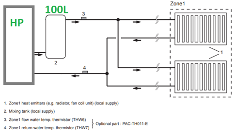

My system has got buffer tank on flow and zone1 flow/return temperature sensors after tank, whole system runs on internal pump. Rooms have TRV’s but they are mostly fully open.

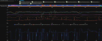

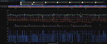

setback

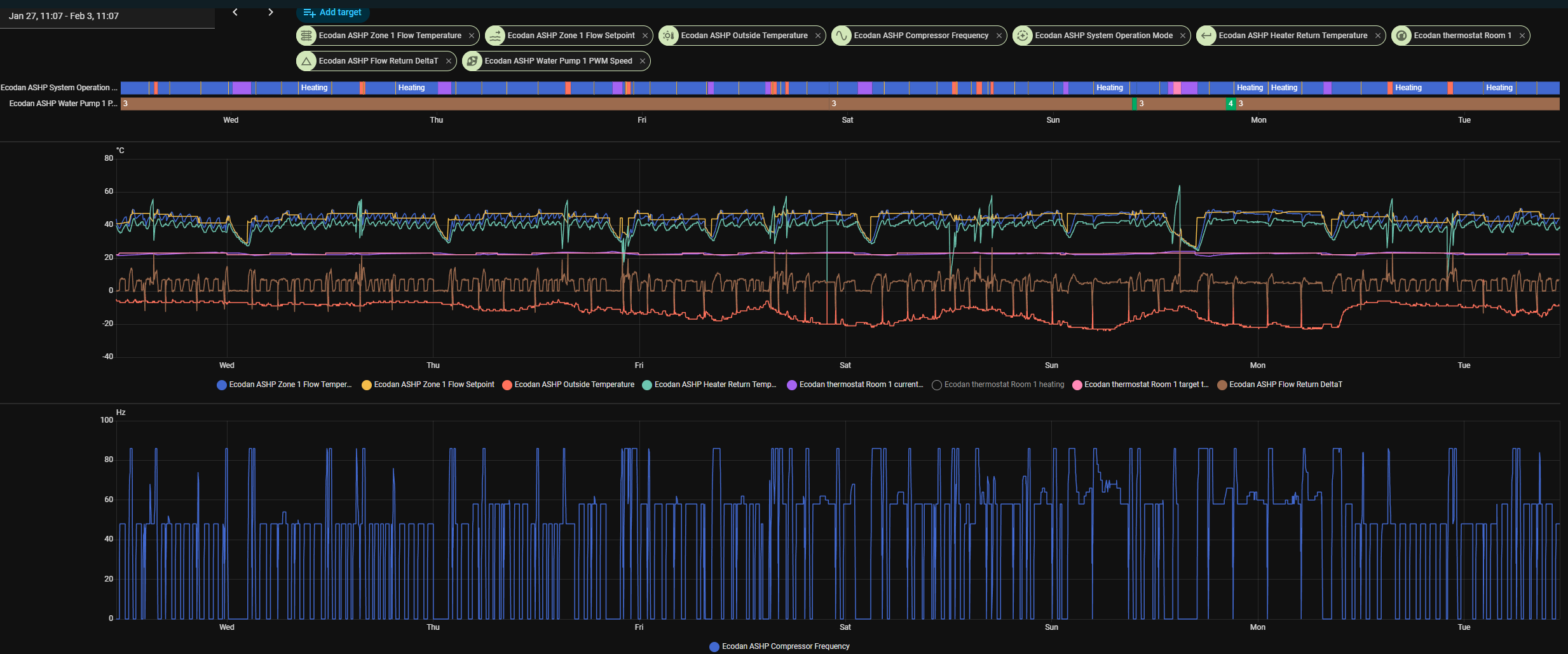

Week graph currently
shorter period

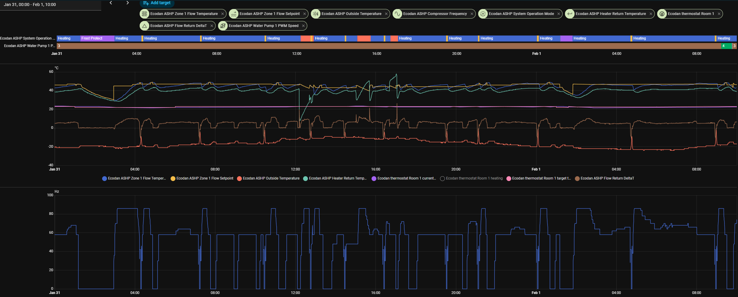

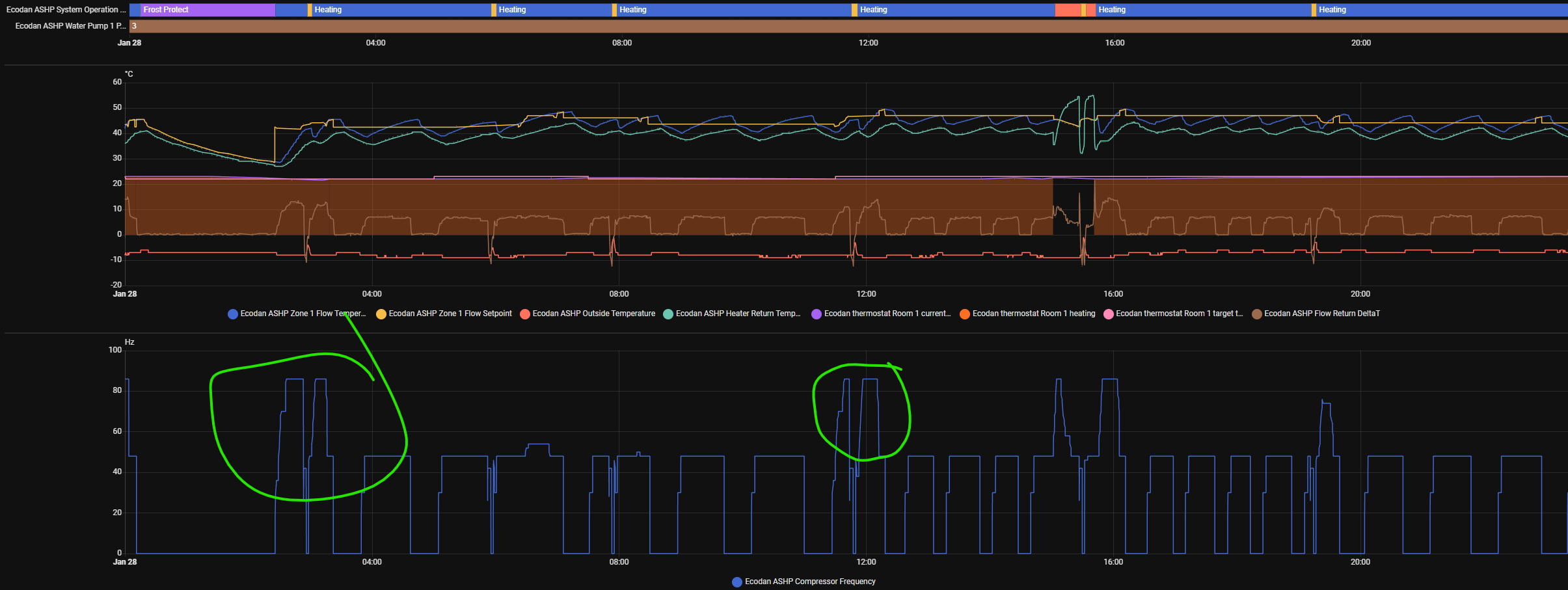

Does your control remove/reduce the unnecessary compressor peaks like on the image below, that are purely caused by large delta on flow vs sp flow?
This could easily be avoided by using “virtual flow SP” that is 3-5C higher than actual flow temp that gradually follows it to reach actual calculated flow SP. This “virtual flow SP” should be monitored/specified at which delta the compressor ramps up.
Tried the simulator and based on that the calculated flow temperatures were lower than Ecodan uses and should reduce the peaks.
Any realtime charts on lower outside temperature about -10C?
I don’t think there would be any difference, unless Flow Setpoint rises gradually.
This is FTC controlled, you can try “Normal” instead of “Fast” response if you have the option set in the Service Menu > Heating Operations
Typically this is just caused by the high delta between setpoint and actual
Note here that in some cases (e.g. post defrost) some users actually require a fast response in order to return to normal flow temperature as quickly as possible
This will probably depend on the size of your heat pump and heat loss
That’s what I tried to explain with that “virtual flow temp. setpoint” before.

I have installed buffer tank mostly for that if it’s cold (-15C) outside and the defrost cycle begins, I still have a full tank on warm water to feed radiators. Also it keeps cycling down.
