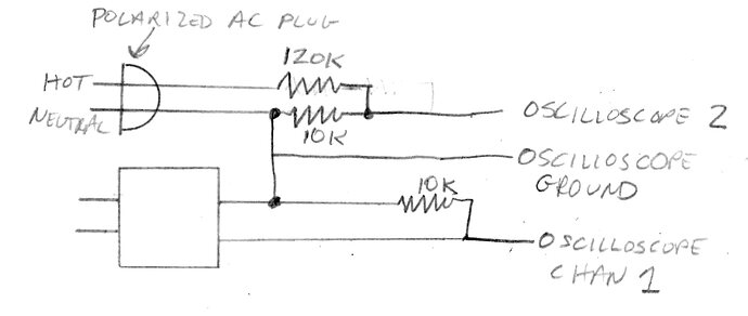

See if this makes sense. made up a power cord with a voltage divider and plugged it alongside the AC adapter:
[ DON’T DO THIS - THIS CIRCUIT IS POTENTIALLY DANGEROUS - Moderator (RW)]
When I look at the two traces on the scope, channel one (the AC adapter) crosses zero 280us before channel 2 (the line voltage). My device presents an 11K load to the AC adapter, so pretty close there.
One 60Hz cycle takes 16666us, so I get a phase shift of 360 * 280 / 16666 = ~6 degrees. Not sure of the terminology, but I’ve been saying the AC adapter leads the line voltage by 6 degrees.
I suppose I could do something similar by scoping the VT against the same line voltage probe with various load on the AC line. Does this make sense?
Before you think any more about that circuit, stop and work out what will happen if something goes wrong, for example the neutral falls off outside your house.
The consequences barely bear thinking about. You’ve said you’re a software guy with not too much knowledge of electrical engineering, so quit while you’re still alive. You’ll have a neutral-earth fault and all the current that was carried by your neutral will flow through your 'scope lead to ground. and when that fails, everything is live to line.
