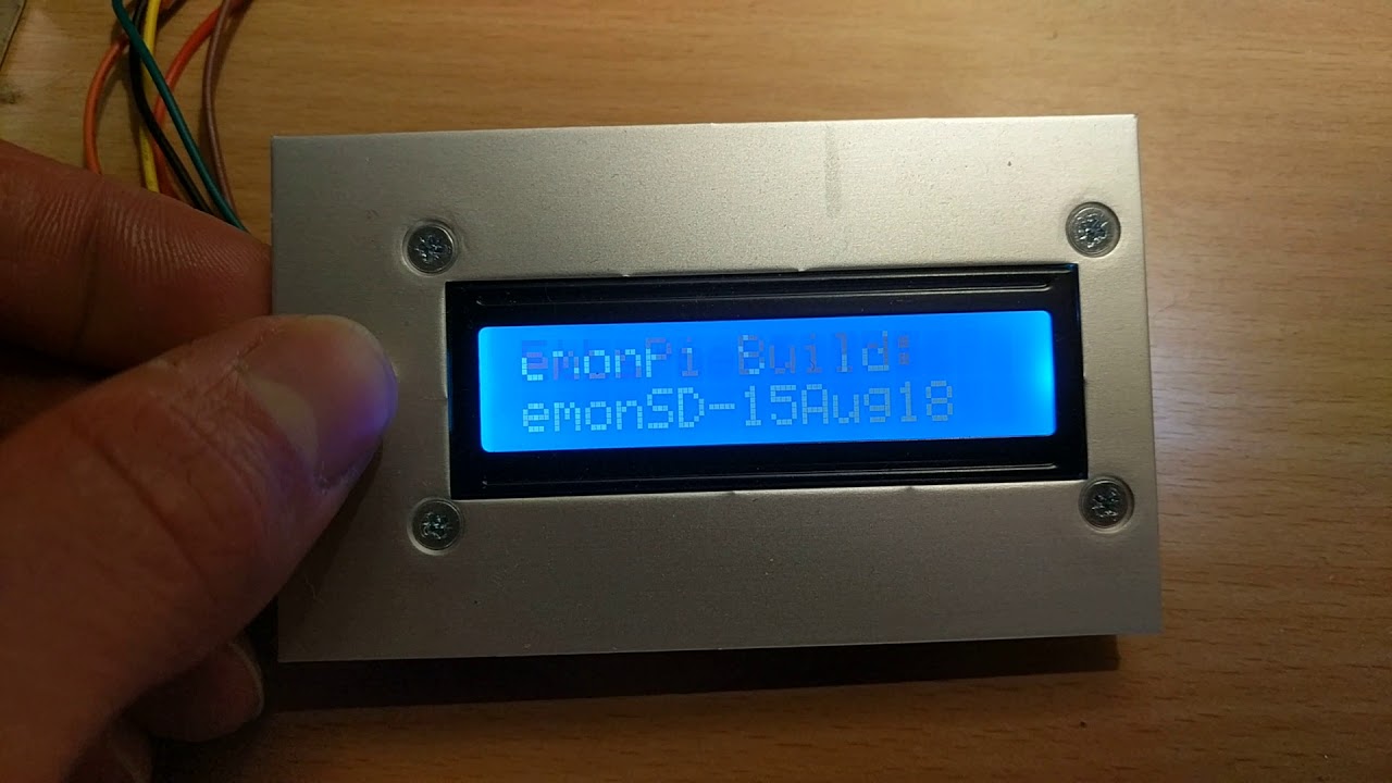

For the emonSD release emonSD-30Oct18 (based on Stretch) SSH will be disabled by default for increased security.
SSH can be enabled by either:
  1. The standard Raspbian way: adding a txt file in /boot called ssh
I see this being the preferred method of emonBase users where the SD card is easily accessible. A USB keyboard and HDMI monitor can also be used to create the file if no SD card reader is available.
  1. Press and hold the emonPi LCD button for 5s
This would be the preferred method for emonPi users, see video demo:
The update to emonPiLCD.py for this enable SSH feature is currently in the gpiozero-enable-ssh branch of the emonPi repo.
To handle both sort and long press of the push button I’ve moved to using gpio-zero python library this has a really nice class for handling button inputs. Gpiozero has also improved the response time of the push button as you can see in the video.
The gpiozero lib can be installed with:
$ sudo apt-get install python-gpiozero
This install will be handled automatically as part of the emonpiupdate process.

Agree, SSH is very useful if a user gets locked out of the web interface. This is why I’ve developed this feature to be able to enable SSH via a physical long press on the emonPi push button or by adding a file onto the boot partition of the SD card.
If we left SSH on by default and left it to the users to disable it if not needed then we run the risk of most users leaving SSH turned on with the default password. It’s far better IMO for the system to be in the most secure state by default.

The LCD prints “SSH enabled” after 5 seconds, so as long as the user is looking at the screen, the message is quite clear?

This feature has now been merged into emonpi master. All emonPi’s will benefit from improved lcd push button response time after running emonpi update.
Please feedback any issues here.

Correct, when SSH is enabled via a long press of the LCD push button the user is presented with the default password and prompted to change it. It’s presumed that since the user chose to enable SSH they would change the default password as prompted to their own secure password. If a user did wish to disable SSH it’s just matter of running:

Leaving SSH enabled is not insecure as long as it’s got a strong unique password. It would be possible to extend the functionality of my push-and-hold feature to toggle SSH on/off if there was demand for this.
The goal for this feature was to move away from having SSH enabled with a default password. Only a small % of emonPi users will ever use SSH, in fact, most don’t know what SSH is! Those who choose to enable it will understand the importance of security with a unique strong password.
