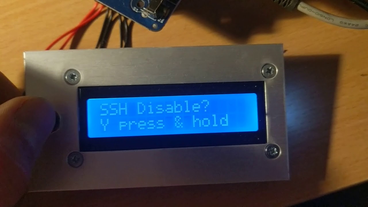

Following on from the emonPi SSH disabled by default thread, thanks a lot for everyone who contributed.
With significant contribution from @alandpearson we have now implemented an update (V3.0.1) to the emonPi LCD service. The update will make it easy to toggle SSH (enable/disable) as required on all emonPi’s. The main features of the update are:
  • Add toggle SSH features to the LCD
  • Add shutdown feature to the LCD (shutdown button still works the same)
  • Add config file for customizing the LCD service e.g. enable custom MQTT data to be displayed
  • Refactor Redis polling: reduce Pi CPU usage 30%-40%
Here is a video overview of the new update in action:
The update has been merged into master branch and is available to all emonPi users via emonPi update.
This update will be very useful for existing emonPi users to easily disable SSH if it’s not required.

Great to see this finally added, it’s logical to both enable + disable SSH from the interface.
Paul
I tried to use the backlight_timeout feature (the emonpi is in my kitchen so I don’t want it on all the time) but it has clearly not been tested with non-zero values.
File "./emonPiLCD.py", line 543, in main
    if (backlight_timeout) and now - buttonPress_time > backlight_timeout and lcd.backlight:
NameError: global name 'now' is not defined
Got it working by adding a global declaration of “now”.
Thanks, good spot. This must have got missed out during the refactor
I had to add now = now.time() to setup the backlight timer:
Change has been committed to master (V3.0.1)
