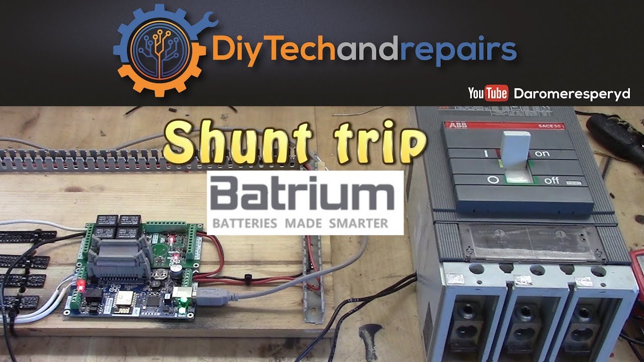

Isn’t this what a shunt trip typically would do?
This is what I’m using. Can hook this up to the relay attached to your bms. Still being shipped so haven’t tested but don’t see why it wouldn’t work… @daromer pointed me in this direction. I think he has one setup.
Yeap i have. Several actually …above is My video so :slight_smile:
