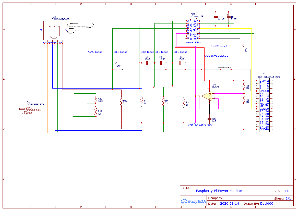

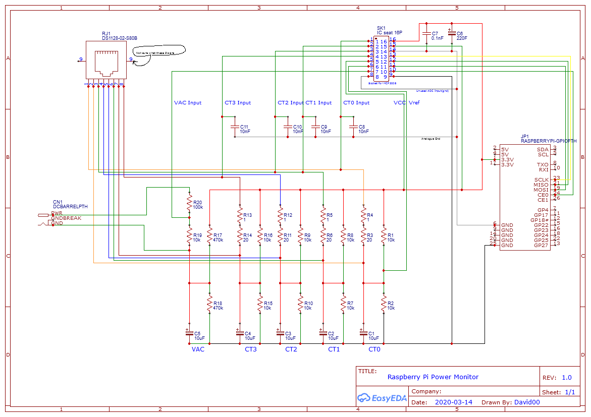

I’m looking into having a custom PCB made. I’m not really satisfied with how I had to stack two of the Raspberry Pi perma-proto-hats on top of each other because I couldn’t fit all the circuitry on one board. I have a feeling that is contributing to the noise. And, since I’m this far in already, I might as well go the extra mile to learn a little bit about PCB design. Furthermore, with the likely manufacturing delays due to the virus outbreak, I wanted to get an order in and use the waiting time to investigate the phase correction.
I’ve built my schematic already and I’m working on designing a custom Pi Hat that will fit over the Pi and connect to the headers. I’ve never done this before, so any advice, suggestions, or corrections are greatly appreciated! Here is my current schematic.
I’ve also uploaded a better quality PDF. (83.3 KB)
Why not use the buffered bias supply (see Learn | OpenEnergyMonitor) given that you have 5 identical bias circuits?
Also, do you really need the 20 Ω & 1Ω in series? I’d question whether it is worth the extra cost and board space. If you are tied to E12 series resistors, you’re only gaining 5% on the useful range of the ADC, if you can obtain an E24 series component, you can have 21 Ω exactly.
I’d put a inductor-sized link in the 3.3 V line from the RPi, just in case you need it for more filtering.
Posted today in another thread is an input circuit incorporating input protection for the ADC. You might want to think about that before committing your board to manufacture.

I’ll replace it with 21 Ohm resistors. The schematic was including components I already have, so I included the two resistors in series.

A wire link that you can remove and substitute a series inductor, if you find you need additional filtering on the power supply to the bias circuits and the ADC. So you have an inductor that presents a low resistance to d.c. but an increasingly high impedance to a.c. as the frequency rises (therefore it blocks a.c. noise on the supply) and then the capacitors you have attenuate the a.c. component even more. In effect, you’re introducing a frequency-dependent voltage divider into the supply that lets the d.c. through unhindered, but blocks a.c., and the higher the frequency the better it blocks it.
Thank you. That makes sense. I’ve added the buffered bias supply, an inductor (which I’ll use wire to connect unless an inductor is needed), and I revisited the subject of analogue vs. digital grounds. Since the Pi’s ground pins are all on the same bus, I can’t really separate the analog grounds from the digital ground. Can I use an inductor or filtering capacitor either inline or between the two grounds to help reduce the transfer of noise through the Pi’s ground bus?
Also, should my decoupling capacitors on the ADC input pin #16 (Vdd) be connected to the Agnd on the ADC, or the Dgnd? Right now they’re connected to the Agnd, but I think they need to be moved to the Dgnd (pin #9).
Schematic_OpAmp Bias Supply_Sheet_1_20200314150337.pdf (65.5 KB)
Edit. I just realized I left the CT4 input’s filtering capacitor disconnected. Fixing that now.
That might be worth doing - if you have it, you can always put a link there if it actually causes trouble. The main point is not to allow digital current to flow in the ground traces that link the analogue parts.
You’re probably right, but refer to the data sheet or App. Notes for guidance on that. You might need to determine the relationship between pins 6 & 25 on your RPi to get all the relevant information.
In any case, those grounds appear all mixed up. ALL the analogue circuitry needs to go to a clean ground - the ADC analog ground, the op. amp, it’s input voltage divider, and the filters.
You’ve got L1 in the wrong place - it needs to be before the half-rail divider for the op.amp. You’re not too worried about noise on the 3008’s VDD, it’s VREF that must be clean - if there’s noise on the reference, what chance do you have of making meaningful measurements? Get a copy of Microchip’s AN688 and study that.
I hope your PCB is large enough to accommodate a 220 Farad capacitor. :rofl:
And take a careful look around U1 - that’s gone wrong big time. C12 should go onto pin 1, and pin 2 to AGND.
