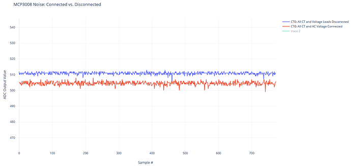

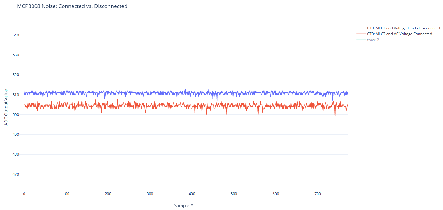

I’m not so sure anymore. I just pulled some new data from my board and plotted it, comparing the “everything connected” case vs. the “everything disconnected” case. Everything connected means that the CT sensor leads are connected via my RJ-45 coupler and the AC input voltage is connected. Disconnected means neither the AC voltage input nor the CT sensor leads are connected. It’s strange that the average noise value with the leads connected is lower than the ADC “zero” level of 511, but if I remove the CT leads, the ADC output is a bit less noisy, but it’s at the proper “zero” level at 511.
My previous post where I shared the min and max values from noise pickup were just that: min and max. I ran the numbers again in a new dataset and this time compared the median to the average to get a better sense of how the noise is influencing my data. For instance, with the CT leads connected, the average reading for a single CT is 504.8, and the median is 505, which tells me that the noise is not really skewing a dataset of 2k samples that much.
C1 is a 10µF electrolytic capacitor.
You’re right. The smallest electrolytic capacitor I have is 0.1µF. The next smallest capacitor value I have is a 22pF ceramic. I still want to try adding a filtering capacitor and I can order either some plastic film caps or some small ceramic ones. Is one better than the other when it comes to filtering?
I’m seeing consistently low “zero” levels on all 4 of my CT channels when the CT leads are connected to the board and not surrounding a conductor. Over 2k samples, my average CT input values are at 504.8, 505.01, 500.87, and 504.08. These are raw ADC output values before any corrections are applied. With the CT leads disconnected from the board, the average CT input values are better, at 511.0, 511.2, 506.9, and 510.1.
The filtering capacitor is more a case of the value than the type, too high a value and you’ll add a phase shift that you’ll need to account for somewhere else, so you really want the smallest value that takes the worst of the noise out, whilst still leaving a reasonably faithful representation of the signal you want to measure.
I wouldn’t attach any significance to the average (d.c.) value that you measure. You’ll take that out in the maths anyway. The transformer (any transformer) can’t pass through a d.c. value, so any d.c. going into the ADC is false, and has to be removed to get the true value of the wanted signal - voltage or current. And bear in mind, that d.c. bias you’re putting in to make the negative swings of the signal fall within the ADC’s range is going to move about with temperature and all the other things that affect component values and their properties, so you can’t take out a fixed value, you need to measure it to remove it completely. (Post no. 63)
Ok, thanks! I went ahead and ordered a kit of plastic film capacitors. I’ll have 10nF, 22nF, and 47nF values, among others outside of the range you suggested. I’ll add one to a single CT input and see how it looks when they arrive in a few days.
