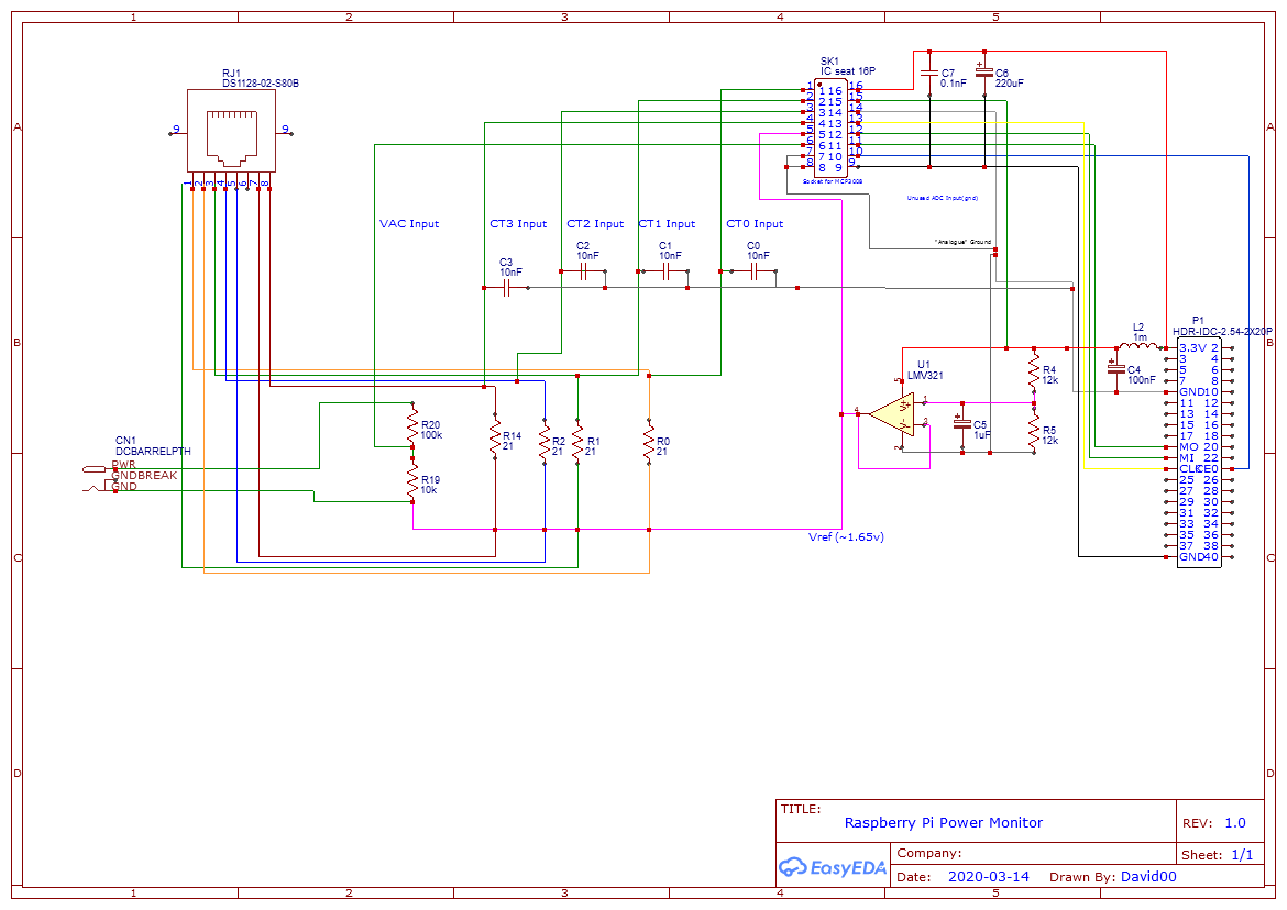

Ok. The MCP3008 does have an internal separation between the analog and digital grounds, so I may not need to be overly concerned with it.
Unfortunately, the datasheet for the MCP3008 isn’t that detailed. It just says:
A bypass capacitor should always be used with this device and should be placed as close as possible to the device pin. A bypass capacitor value of 1uF is recommended.
BUT…it continues to talk about the ground planes, and it says if no ground plane is utilized, both grounds must be connected to VSS on the board. Is VSS in my scenario the Pi’s ground bus, or pin #2 of the LMV321? So if I can determine which ground is VSS, I can infer where to connect the filtering capacitor to.
Good catch!! I think I’ve managed to correct L1 in the latest iteration - and the others too.
Got it! This publication is also referenced in the MCP3008’s datasheet. I will review it.
You know, now that I’m using the operational amplifier to supply the bias voltage for all 5 individual circuits, I should be able to fit the entire project on a single perma-proto board. I did order extras of everything just in case there were substantial design changes like this… so that might be worth a try before the custom PCB.
so you would do better to respect and use it if you can.
This is a bit chicken-and-egg. It depends on where and how the two grounds come together. How you need to be thinking is: Where does the current with all the digital switching transients etc - from the RPi as well as from the digital side of the 3008 - flow, and how can you best keep them apart?
The LMV321 definitely needs to be regarded as part of the analogue side, so pin 5 (VCC) needs to get its supply from the clean 3.3 V, and pin 2 (GND) needs to go to the clean analogue ground. Otherwise, the mid-rail reference will have noise on it, rather defeating the object.

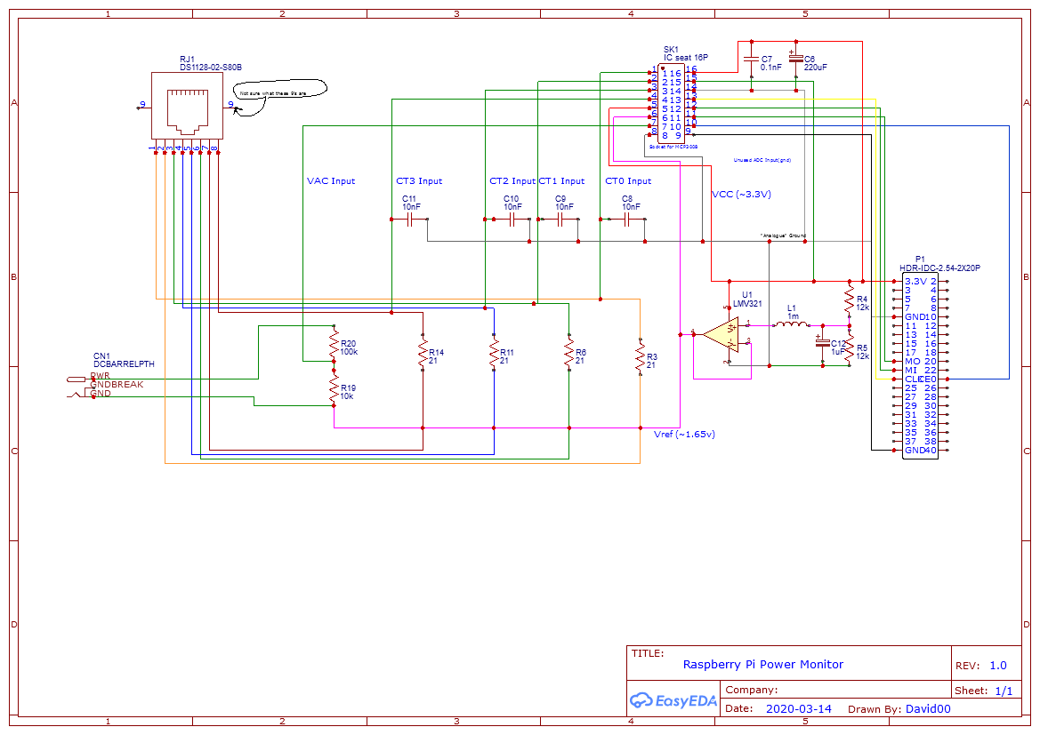

I realized I forgot to include the latest iteration of the schematic that I referred to. Here it is!
Argh! You’re going from bad to worse. L1 is completely in the wrong place now.
Let’s (conceptually at least) start from the beginning. Your 3.3 V comes from a dirty pin on the RPi and there’s a dirty ground that goes with it. Those two pins need to feed the dirt-generating dirty digital part of the 3008, i.e. pins 16 & 9.
From the dirty (pin 1) of the RPi, you need to take a feed for the analogue circuity and clean it up. You take it through your LC filter and use it to feed the clean analogue side of the 3008 (that’s AREF), the Op.amp and its input divider; and those plus all the analog smoothing, filtering and decoupling return to the clean analogue ground. If you have a clean analogue ground on your RPi, it connects there. Otherwise it connects at one place only to the common ground, and preferably as near to the source of power as possible, so that there’s no digital dirty current flowing in a wire or trace shared with the analogue return current.

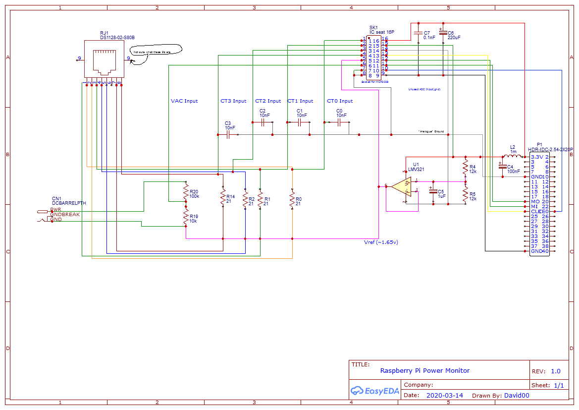

Ok, I think I’ve got it now. I have the 3.3V source going through the inductor and a (new) decoupling capacitor before it feeds anything else.
Third time’s the try?
I may have to move the grounds closer to the GPIO pins, but I wanted to address the inductor issue first.
Nope.
1. You’ve lost the analogue ground to the op.amp and the 3008 AGND.
2. I’d still connect the VDD of the 3008 (pin 16) to the dirty side of L2, otherwise you’re putting digital noise from it onto the clean analogue power rail. Likewise now that you’ve separated the analogue and digital powers, C7 & C8 need to return to the digital ground on pin 9. Depending on how exactly you lay out your PCB, you need to consider the last bit of section 6.5 of the 3008 data sheet. That infers that noise can enter the 3008 via the digital ground pin, and that will be worse than the 3008 injecting noise into everywhere else. This might only be true if you have a substantial ground plane.
3. There’s no point in taking the 3.3 V to the ADC to measure it, it will only ever read full scale (1023), because that input pin will be the same voltage as the reference, and 1023 counts by definition represents the reference voltage.

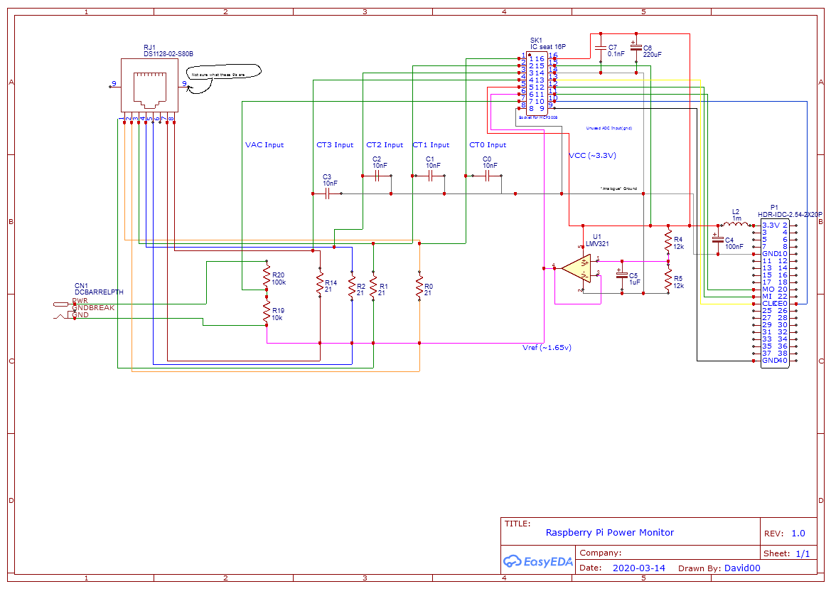

Is it not still there? It’s pin #14 on the ADC going to pin #9 on the Pi header. The routing in my schematic doesn’t look like the routing in the schematic of the Learn section, but I think the connections are still the same.
That makes sense. Thank you.
That is the next challenge. The layout of the parts is tricky. I’ve experimented a little bit but I know I need to review the Microchip document you suggested before committing to a layout. I would prefer to follow the Pi HAT specification which restricts the board dimensions to 65 x 56.5mm. The components look like they’re fit nicely with plenty of room, but I think routing the traces efficiently in only 2 layers is going to be difficult for a first-timer like myself. Maybe I’ll have to do a 4 layer and put the analogue grounds on its own layer.
I see - I think that was leftover from my original implementation where I was originally sampling it. I had commented it out in the code, but not removed the circuitry for it.
Here is the updated schematic after moving the VDD to the dirty side of the 3.3V supply, and the filtering capacitors to the digital ground of the MCP.
Is there a join where the vertical line from pin 2 of the op.amp (Vss) crosses the GND from the RPi? If there is, that is what threw me. Your drawing package is faulty, you never, ever have a 4-way join on a diagram, and it shouldn’t have allowed it. I read it as a crossing.
I thought I should note it. That’s a few less components to lay down and a few less tracks to route.
Pin 9 on RJ1 is probably mechanical fixing for extra strength as much as anything. Look at a photo and they’re the metal screening can.

Ah yes, it was a 4-way join. I think it threw me off a couple of times, too. Thanks for pointing that out!
That’s what I was thinking as well, but I wasn’t too sure. Here is the latest schematic with the analogue ground problems fixed.
I haven’t checked every detail, but that looks OK to me. I can’t see anything glaringly obvious that’s wrong.
