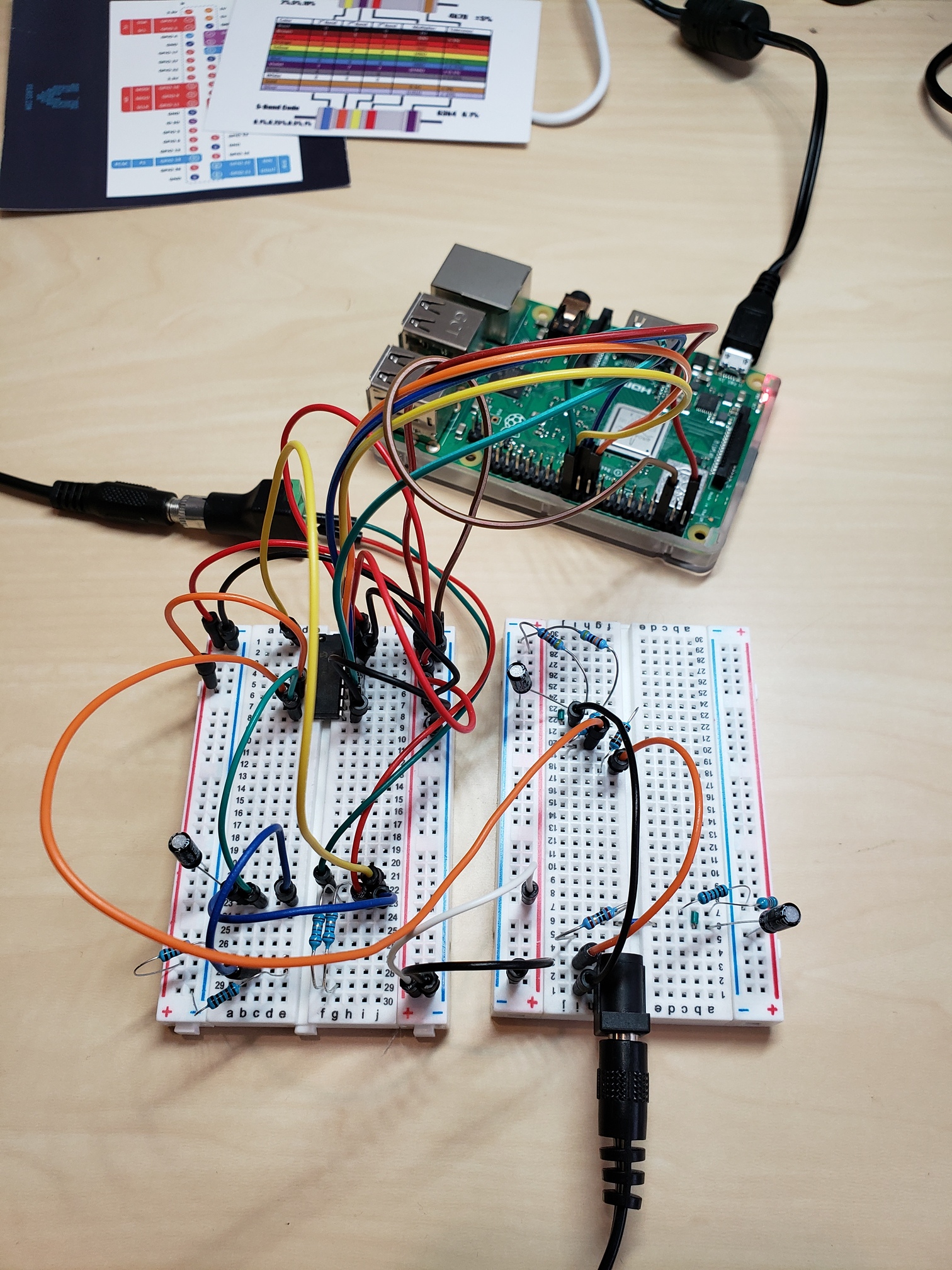

If you post a picture of your breadboard, that might help.
If I were making something like this, I’d use Veroboard (https://uk.farnell.com/productimages/standard/en_GB/1536938-40.jpg).
Pack everything in as small an area as possible with the shortest possible interconnections everywhere and the shortest possible wires to your RPi. I’d decouple the 3.3 V supply with a largish electrolytic capacitor (220 µF or so) and a 100 nF ceramic disc capacitor in parallel, physically close to where your power comes in, with a second 100 nF as close as possible to the ADC’s power pins.
Ground all unused tracks and don’t leave long ends on the used tracks.
That will be by no means perfect, but it should be an improvement.

Here it is, in all its ugly glory!
I’m doing the exact opposite of that with my current setup (not intentionally… that’s just how it worked out with my components). :laughing:
I’ll work on this now to see if it makes an improvement. I’ll also get rid of the long/loopy jumpers and replace them with shorter flat jumpers, and I’ll snip the extra long leads off the resistors and capacitors so they are more snug on the breadboard. I have a T-style header breakout for my RPI, but it has rather long ribbon cable used to connect it between the board and the breakout. Should I try with that instead of the individual jumper wires between the Pi and the board?

That’s something a bit like I thought you’d have. Only worse, if I’m honest. It really does explain everything.

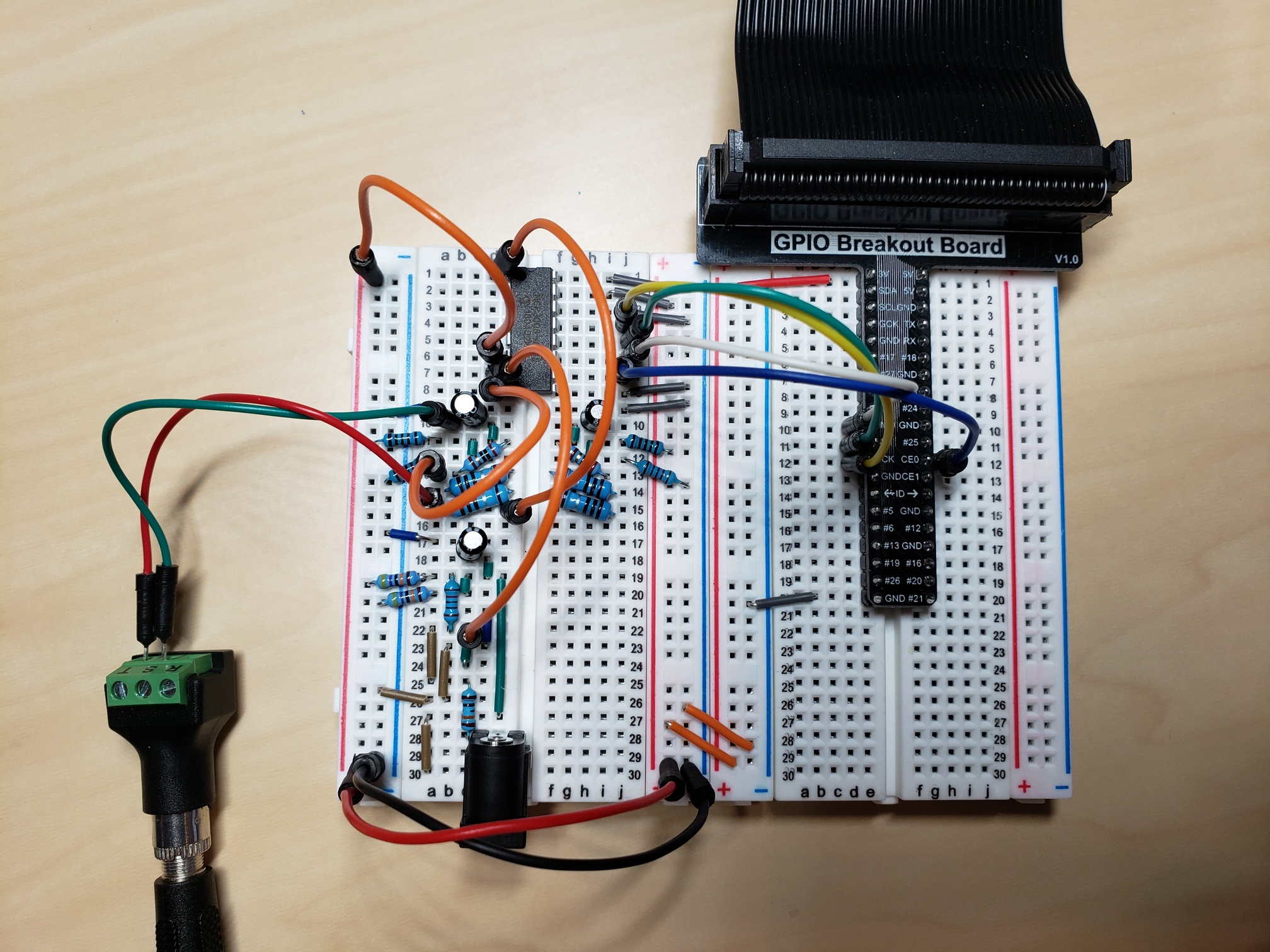

Haha! I’m sure it is common for beginners. I’ve cleaned it up on a new board and I was actually able to condense everything down quite a bit. I was able to condense the circuit for a CT sensor down to 6 rows (rows 9-15 in the circuit pictured below - the left hand side). The circuit for the AC input begins in row 17 and continues to 30. The right half of the board on the left has the circuit for a second CT sensor which I haven’t connected yet. It looks like there is enough space in rows 16-30 on the right half of the left board to build out 2 more CT sensor circuits so I should be able to fit all my inputs on a single 30-row board. The orange jumpers are my ADC inputs.
I also did some tuning for both the single CT sensor and AC voltage circuit. They’re quite accurate now across a variety of loads. The one CT sensor I’m currently using needed about a 1% correction factor, and the AC voltage needed about a -0.3% correction.
I grounded nearly (but not all) of the unused rows on the left hand side of the board. The 0.3A RMS current with the CT sensor disconnected still remains. I’ll still have to figure out where it’s coming from, or choose to set a “zero-threshold” to ignore values that fall between a range. I am not worried about the 0.3A discrepancy with regards to the house mains, but for the solar mains, it might have an impact.
I’m not too sure how to go about this… I think I have an idea, but I don’t want to risk damaging any components if I set it up improperly. I’m not too sure about the second 100 nF cap next to the ADC power pins though. Would the 2nd 100nF cap go between the 2 power pins on the ADC, like this?
Edit: I did some research and believe I’ve figured it out. Does this look correct? Not sure where to put the 2nd ceramic capacitor, though.
Adding the decoupling capacitors did not have an effect on the 0.29A RMS current that’s being detected/calculated with completely de-energized conductor. If I remove the input jumper for the CT sensor, the RMS current is still being calculated at 0.29A, so the interference is coming from elsewhere in the circuit.

Your ADC is a MCP3008?
If you haven’t done so already, read this: http://ww1.microchip.com/downloads/en/Appnotes/00688b.pdf
OK, you’re not making a p.c.b, but there is a lot of good info in there. Microchip do know what they’re talking about.
Note they recommend 1 µF, not 0.1 µF. I’d go along with that. It won’t hurt to leave the 0.1 µF there as well, in parallel.
According to me, the DGND (digital ground) is pin 9 and VDD is pin 16, so those are the pins that have the 1 µF across them. I think from your photo that VREF is also directly connected to the 3.3 V. That’s likely to be full of digital noise. You need to use a small inductor in series to block the noise coming in that way, again with a 1 µF to decouple the pin, this time to the analog ground. You need to keep the analog ground and digital ground separate, as far as possible. All the analog circuitry needs to come together and be connected to the analog ground, with only one connection to the digital ground, ideally at that 220 µF capacitor, which needs to be where the 3.3. V first comes onto your board from wherever the power comes from. As you have it, the current supplying the ADC ( = full of digital noise) passes along those bus bars to which all the analogue grounds are connected. You need to take the power for the ADC directly from the breakout board and only have the analog ground connected to the bus bar.
It wouldn’t do any harm to twist those wires to the c.t. socket together.
If you have them available, I’d put a 1 µF at each end of each of those power supply busses, in addition to the one as close to the ADC pins 9 & 16 as you can get it.

Yes, thank you for the link! I don’t have any disc capacitors that are 1µF - only electrolytic. I was doing some additional reading about MCP3008 noise on the RPi3 and the discussion I found suggested not to use electrolytic capacitors because they have inductive properties due to the way they’re made. I can get some ceramic caps if it’s recommended, though.
Yes, that was the case in the initial picture on a separate, unenergized breadboard. I did further reading and corrected it, then replaced the picture above just a few minutes before you replied, and I think the timing worked out so you didn’t see the new picture.
I’ll have to redo my grounds. Right now everything goes through the bus bar. I will try taking the Dgnd directly to one of the Pi’s ground pin and leave the bus bar for the analog ground (which will go to a separate ground pin on the Pi).
