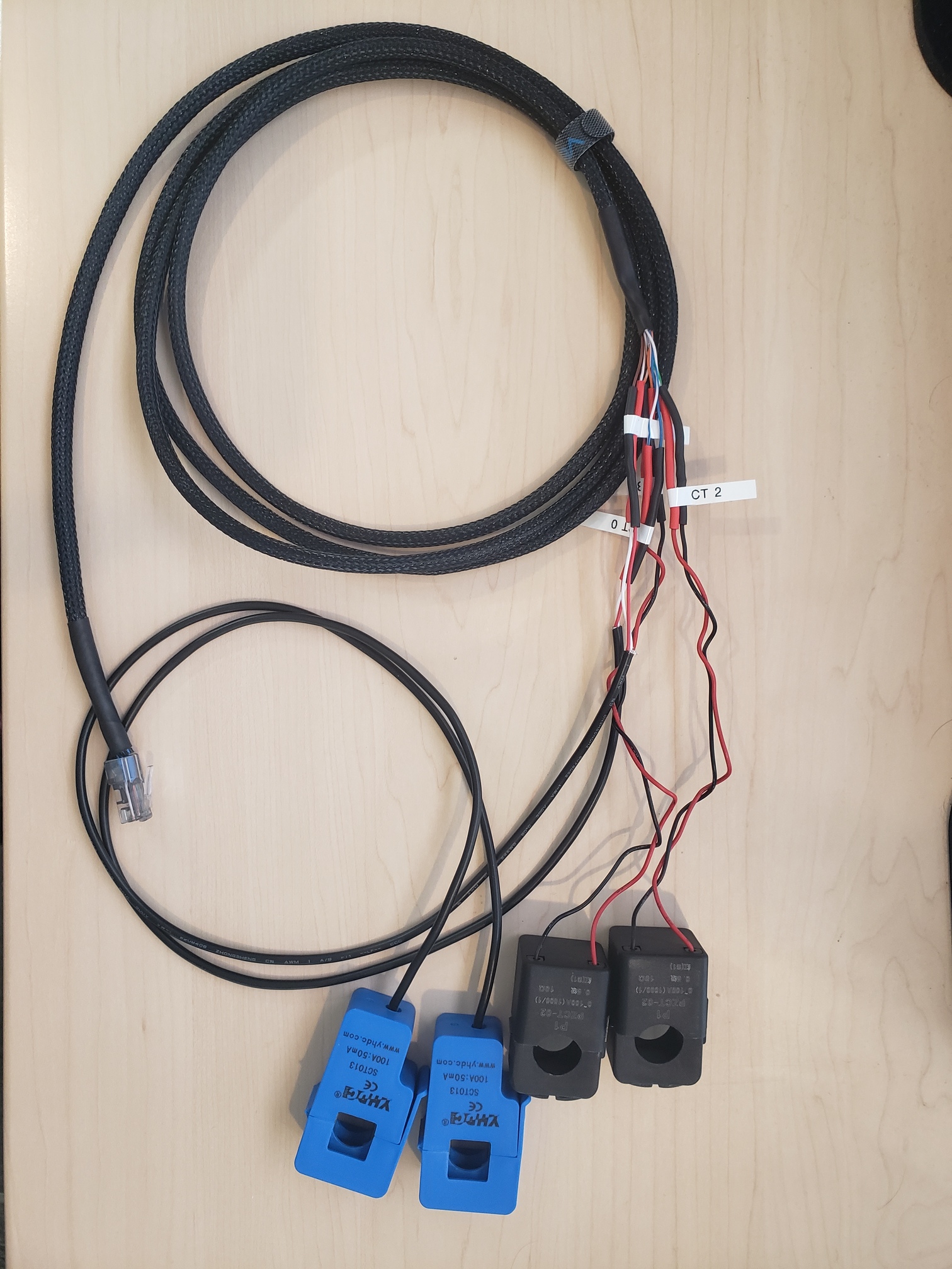

I soldered the leads from each of my CT sensors to a pair of wires in a UTP cat5e cable since I didn’t have any shielded on hand. I put an RJ-45 on the end of this cable, and soldered in another cat5e cable to the board, with an RJ-45 on the end of this side. Then, I am connecting the CT leads to the lead off the board with an RJ-45 coupler:

Here’s my CT sensor cable:

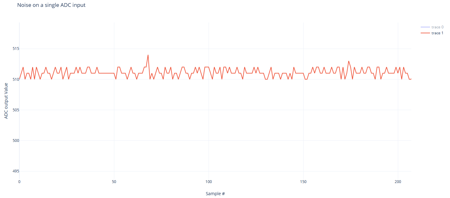

The noise on any given CT input looks like the following. This data was captured with the CT leads connected to the board via the coupler:
If I remove the leads, the noise is much better, like so:
Should I try using shielded twisted pair? Or try without the coupler in between the board and the CT sensors? Or does the proto-board look like a total hack job and I should instead go with a custom PCB? :smile:
What is the “noise current” when you take the rms value and put is as a percentage of full scale input? That’s the value that interests you the most. I’m no expert at guessing rms values of noise, but to me, I’d say its around ½ % of full scale. Bear in mind that it will be much less significant when you do the real power calculation.
I certainly wouldn’t condemn the proto-board out of hand when you’ve got ±1 count of pickup/noise, in 500.
It would be worth checking the noise/pickup with a c.t. just on its own leads. If it’s much the same, screened cable won’t do you much good (though done properly, it will always help).
The RMS current on each channel is usually between 0.5A and 1.1A. I averaged each CT sensor’s RMS current value over about 30 seconds and the average of the RMS currents for each sensor are:
Averages: Ct0: 0.63 | Ct1: 0.63 | Ct2: 0.67 | Ct3: 0.64
All CT sensors are marked at 100A current sensors, so the percentage that the noise represents is about 0.65%
That’s with my cat5e CT sensor bundle connected with the coupler. If I remove the cat5e CT sensor bundle (so that I only have the short cat5e pigtail with the RJ-45 coming off of it, like in the first picture of my previous post), the RMS current on each CT sensor channel is about 0.2. The averages of several RMS current readings from each sensor in this configuration are:
Averages: Ct0: 0.21 | Ct1: 0.21 | Ct2: 0.21 | Ct3: 0.22
So without the CT sensor leads connected, the noise represents about 0.21%
With the CT sensors connected to the board, but not surrounding a conductor, the real power is being calculated anywhere from -1.5 to 10+ W on each CT lead.
I see what you’re saying. The +/- 1 (or 2) with the CT leads disconnected tells me that the circuitry on the board isn’t all that noisy.
With the CT leads connected to the board, the error spread becomes much bigger - about +/- 22. The minimum “noise” is about 470 and the maximum noise is about 515.
So your problem really is pickup rather than noise per se coming in via the power supply or random noise in the electronics.
