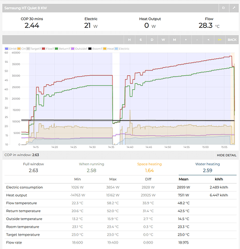

When there was around 0C I’ve had around COP 2. I was in an impression that when it gets warmer I will get much better cop because more heat is extracted from air. To my surprise today was 15C outside and I started DHW heading from 42C to 50C. I was watching and COP was barely 2.5. Pretty poor! Chart is attached. But what bugs me more is that I went out to have a look on a pump and the fan was barely spinning! Power consumption was increasing with flow temperature raising but the fan was still spinning at almost minimum RPM. No change over a course of heating. I can’t get why simply the FAN is not spinning much faster to get more heat from air at the lower compressor speed. Maybe I’m missing something but does this sounds legit to you ? Or some issue with the pump… thx

Nevertheless, would be good if you can check the outside FAN RMP in warmer weather, I was surprised by the fact it was barely moving. Pump consumption was above 3KW. Flow rate around 19l/min. dT was around 5 - 6 C so I guess the pump tried to maintain this but really don’t know why it didn’t increase the FAN speed. Usually when there is above 5C outside i have my flow temp set to 40C but and here the FAN moves really slowly but also the pump is running at 800W.
So that why I don’t understand why when heating water and flow temp raising to 60C slowly the FAN is barely spinning. Compressor consumption is increasing of course. Unfortunately I don’t have sensor for outside FAN speed (I don’t know the modbus register for that) so I can only go out and check.

Looking at your graphs you’re only starting to heat (flow temp) from 40C through to almost 60C.
So the efficiency will always be poor doing that.
All the good COP in a hot water run comes early when the flow temp is at its coldest.
So the emptier the starting point, the colder the water, the colder the starting flow temp, the higher the efficiency.

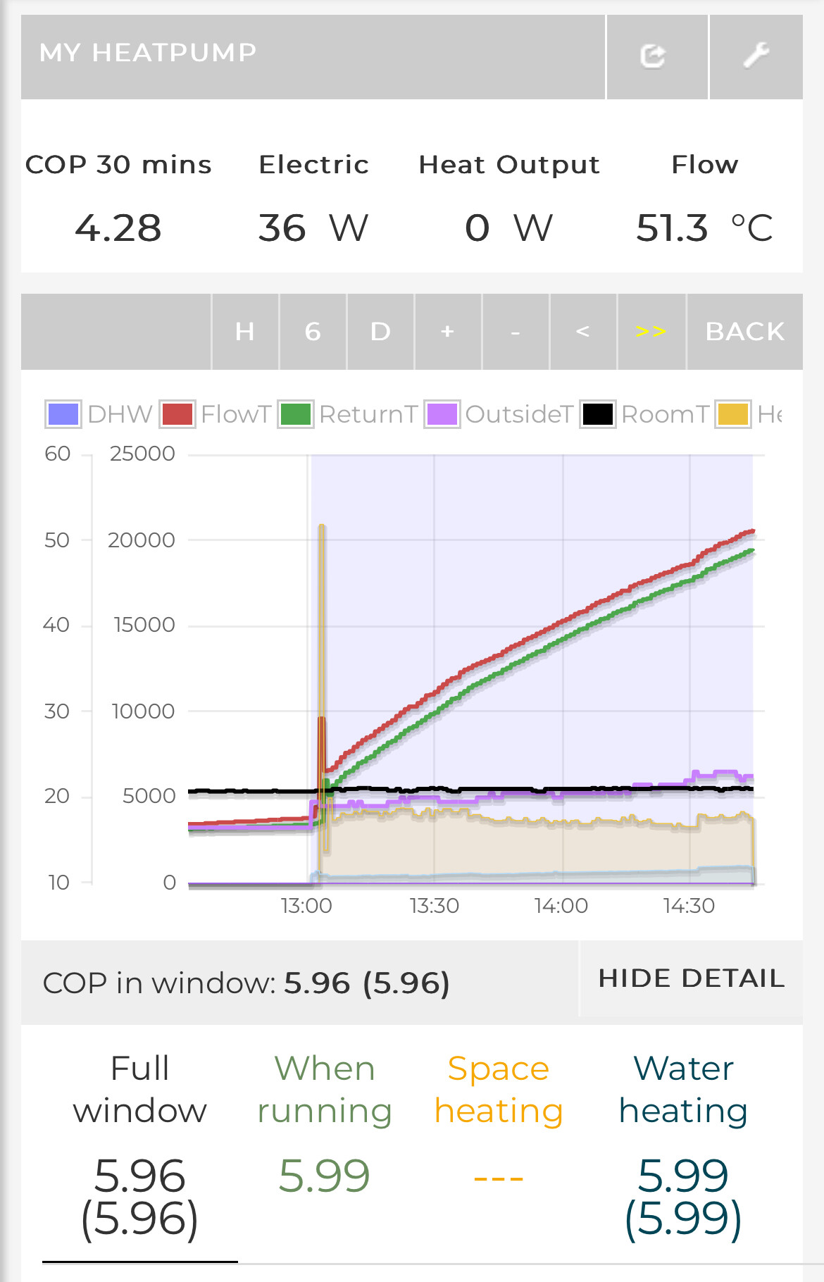

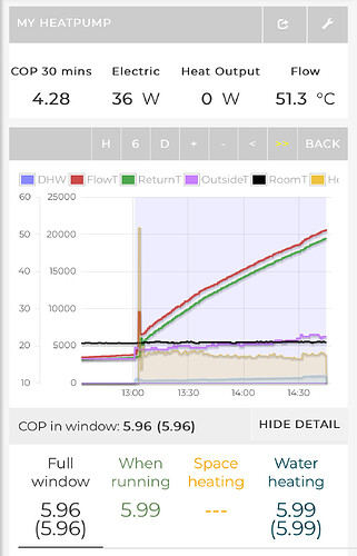

With the warm weather, I experimented with this today and got a COP of 6 on a DHW cycle. Heated 250L Daikin cylinder (essentially rebranded Oso?) from 36° to 46° this afternoon. Daikin 4kW in quiet mode (more quiet). It was only installed last week so I’m still tweaking the settings for best efficiency. Conflicted by the fact that I’m missing out on 15p export by doing this, and can run overnight at 7p on IOG.

I can never get anywhere near this with my 8kW Daikin (which is the same heat pump).
Mine is MID monitored.
My DHW run at those temperatures takes less than 30 minutes for a 205l Joule tank.
My COP would be nothing close to that starting at 36c, I need it to be less to get the best efficiency.
Quite often my DHW COP is truly awful.
I am running in quietest mode.
I wonder what is different.
What is your flow rate?
How is it monitored?
Do you have circulation ? Then either my pump is shit or something is wrong here :slight_smile:
I thought it was too good to be true too! Flow rate was constant 25L/min. Monitored via Shelly and ESPAltherma. Have I not got something set up correctly on it? Heating COP from the limited time I’ve used the heating overnight Thursday and Friday seemed sensible at around 4.

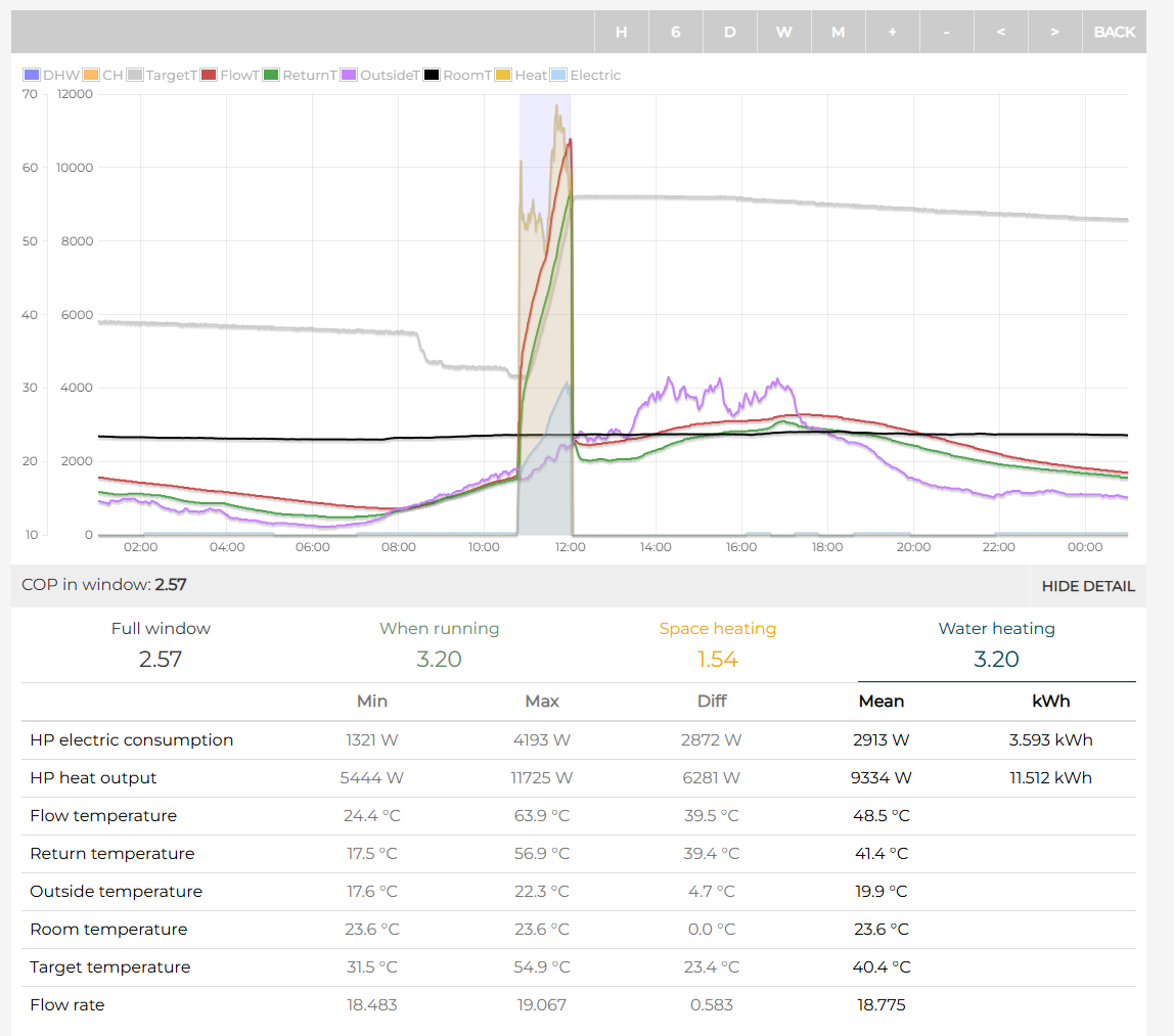

I’ve got COP 3.2 from 32C to 56C. Outside temp 20C.
