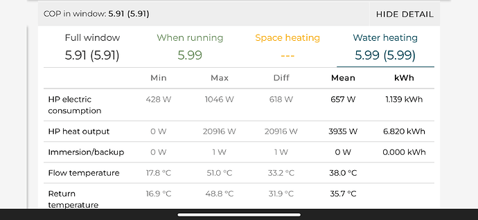

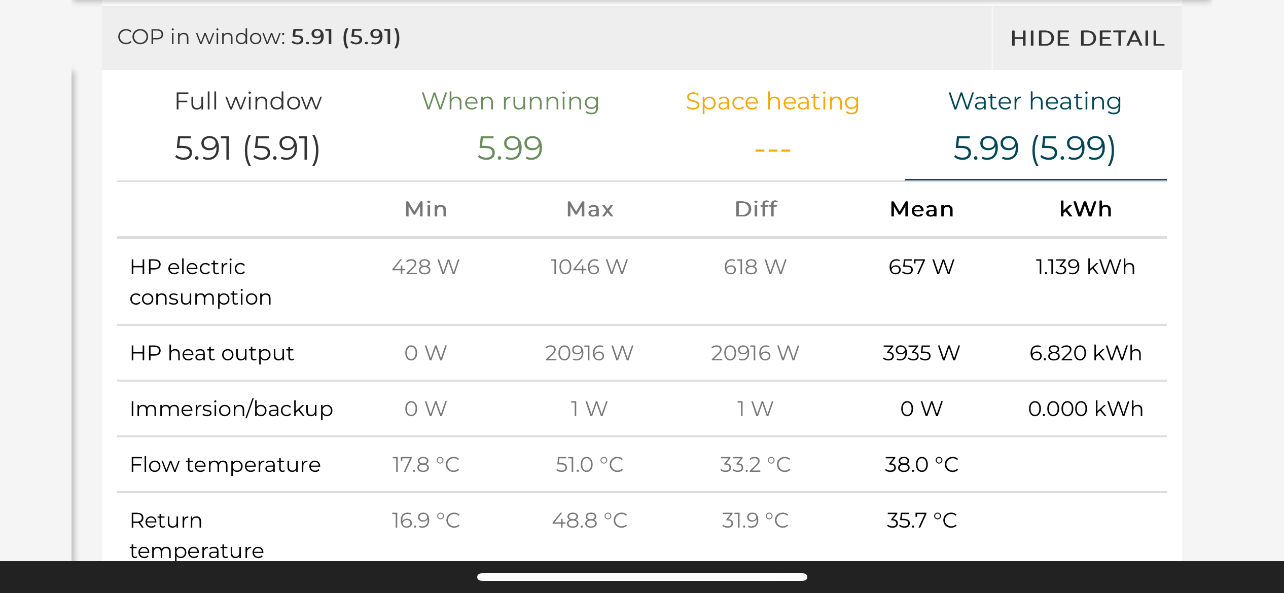

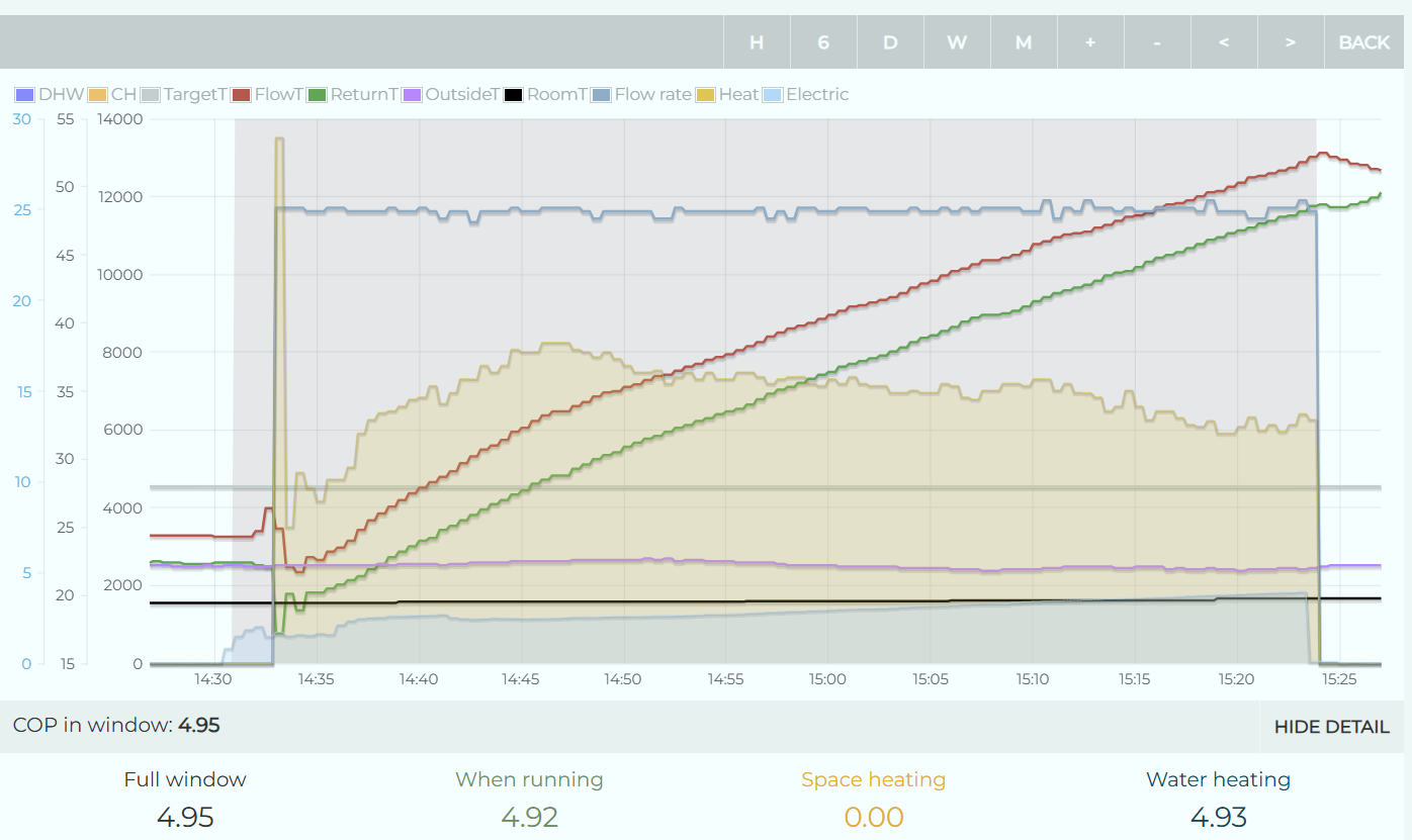

It looks like it started at around 23c, not 36c.
It took a long time, about 105 minutes.
How much electricity did it use?
The flow rate is the same as mine.
How is the electricity monitored, with a ct clamp?
I have seen issues with these Shelly devices before but that is not to say you have anything wrong.
Who knows though with the equipment you are using to get your data.
It seems optimistic to me given the outdoor temperature but that doesn’t mean it isn’t true, just better than I can get and better than I have seen on any MID monitored Daikin.

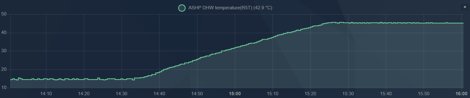

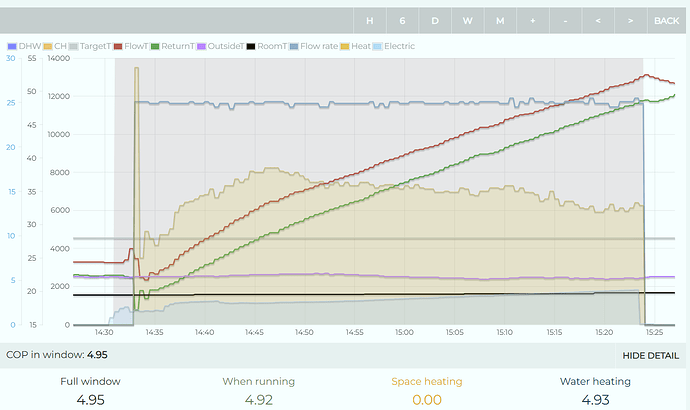

8kW non quiet mode, 180L tank (back to back on wall with heat pump minimal pipe run) for comparison, ESPAltherma + Shelly EM, 22C outside temp, heating to 45C from 15C, 1.2kWh consumption.
Sorry - when I said 36° start, that was the temp on the MMI/Onecta. I realise that this is the temp wherever the temp sensor is, and that the water below that was likely much colder.
As the 4kW is a rebadged 8kW, it will still do 8kW in DHW mode, in non-quiet. As mine is in “more quiet” mode, it seems to be limiting the power output in DHW to under 5kW, hence why my cycle took so long. My max electricity power was only 1000W. This seems to have had a very positive effect on the COP, plus the high outside temp and max flow rate. My pipe run is around 8m total from pump to tank. All piped in 28mm then reducing T down to 22mm right where it enters the tank.
It used just over 1kWh. Electricity monitor is Shelly PRO EM50. They are supposedly very accurate. CT, yes. This doesn’t mean inaccurate though - you can get MID CT meters.

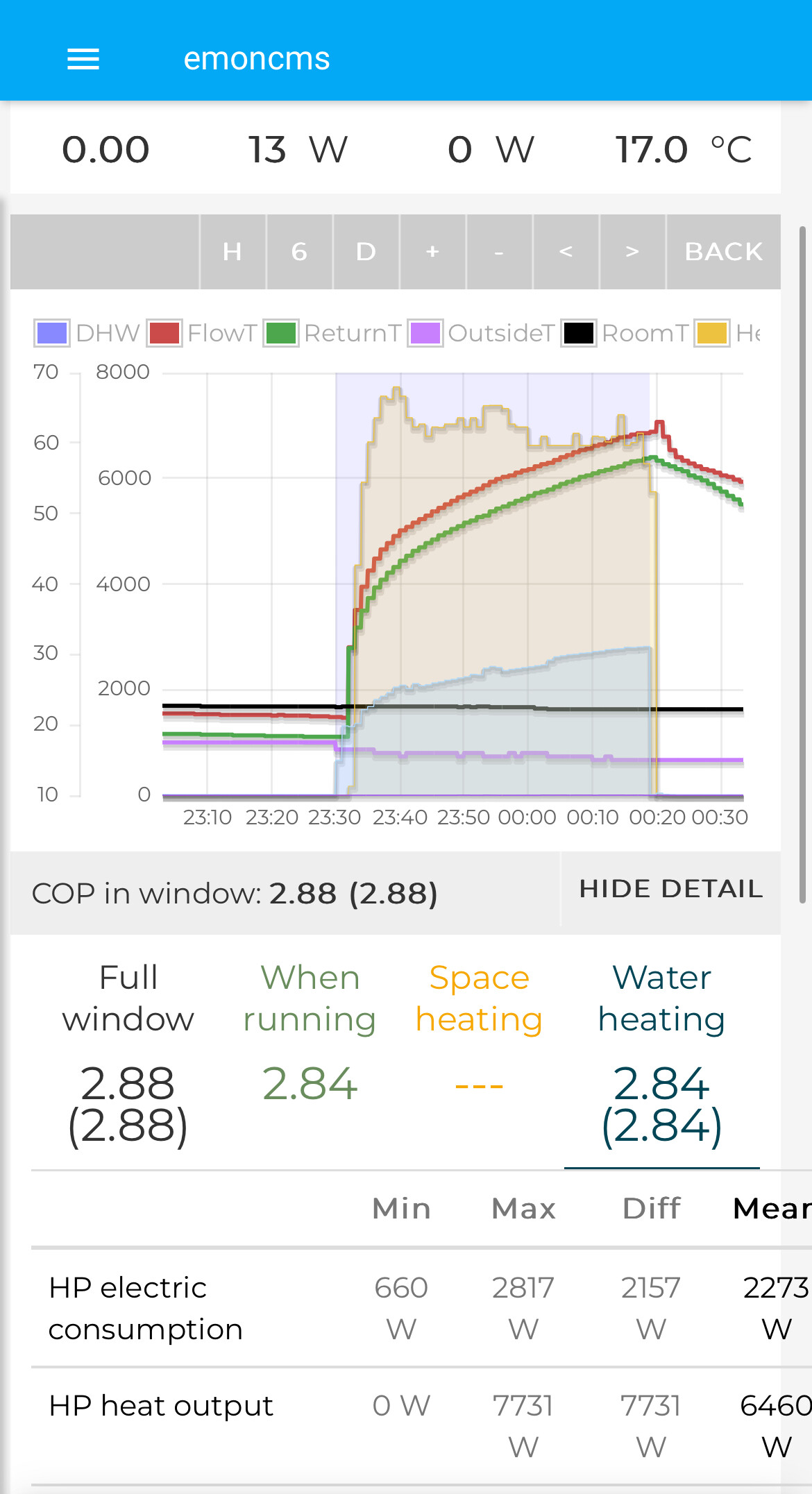

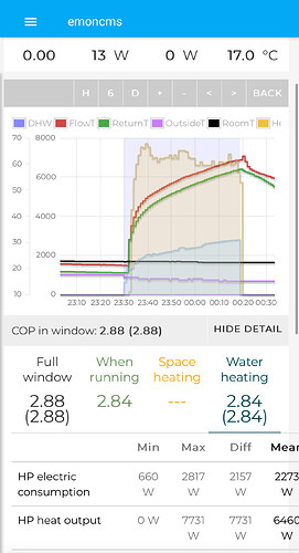

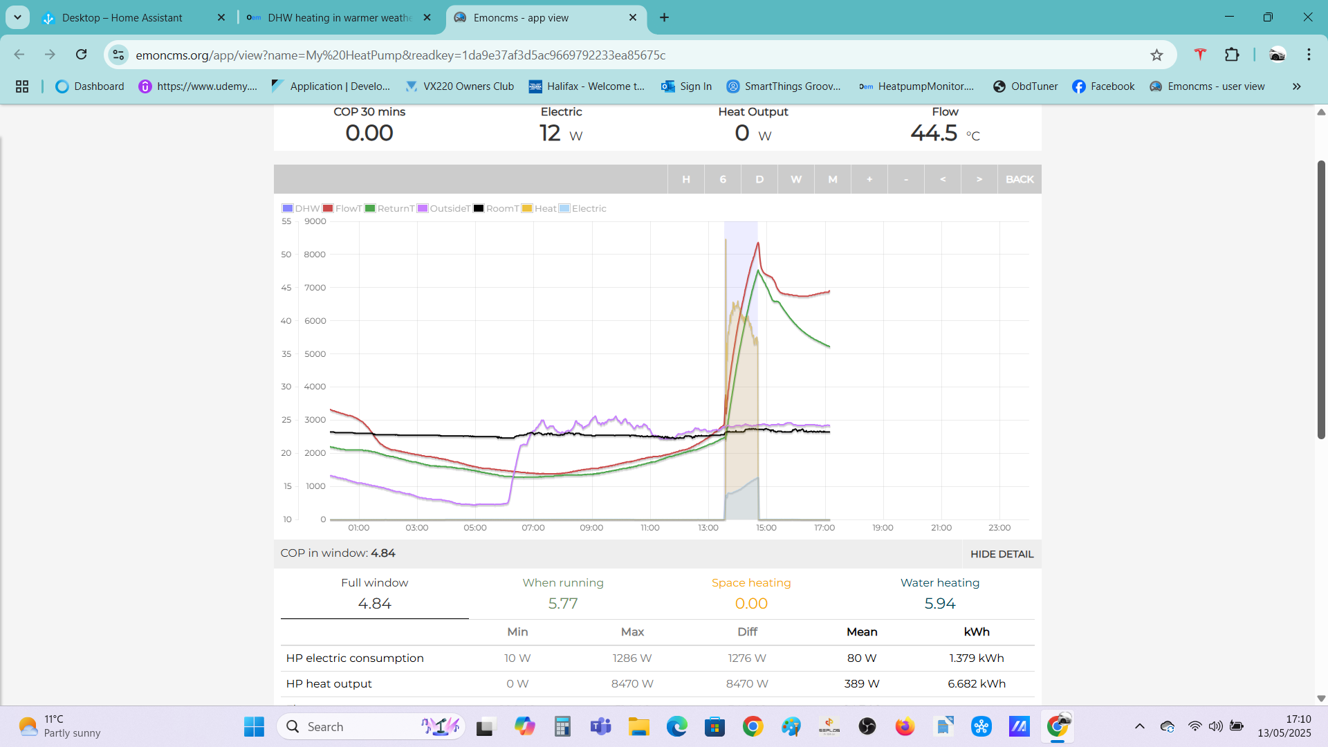

As we had 1/2 price IOG cheap rate last night, I stuck it in beast mode (quiet off), cranked the setpoint up to 53° and let it rip:
This looks “better” :slight_smile: Basically it’s same with my numbers now. Seems it’s extremely sensitive to start point and end point tank temperatures. I have exactly these numbers when I heat from ~40C to 55C, outdoor 20C.
Wonder if quiet mode has any impact on COP at the end ? Can you repeat test with same parameters but quiet mode on ?
I’d also suggest comparing what you see in emoncms versus the MMI’s produced heat / input power for a day for DHW. Divide produced heat with input power and you’ll get what it thinks the COP is.
If it’s vastly different, you might be using the wrong heat sensor on ESPAltherma. There are two, at least on my 11kw unit and “Leaving water temp. after BUH (R2T)” is the closest. I added 0.3 to the value to get produced heat within +/-1kWh in Home Assistant versus MMI’s produced heat sum figure.

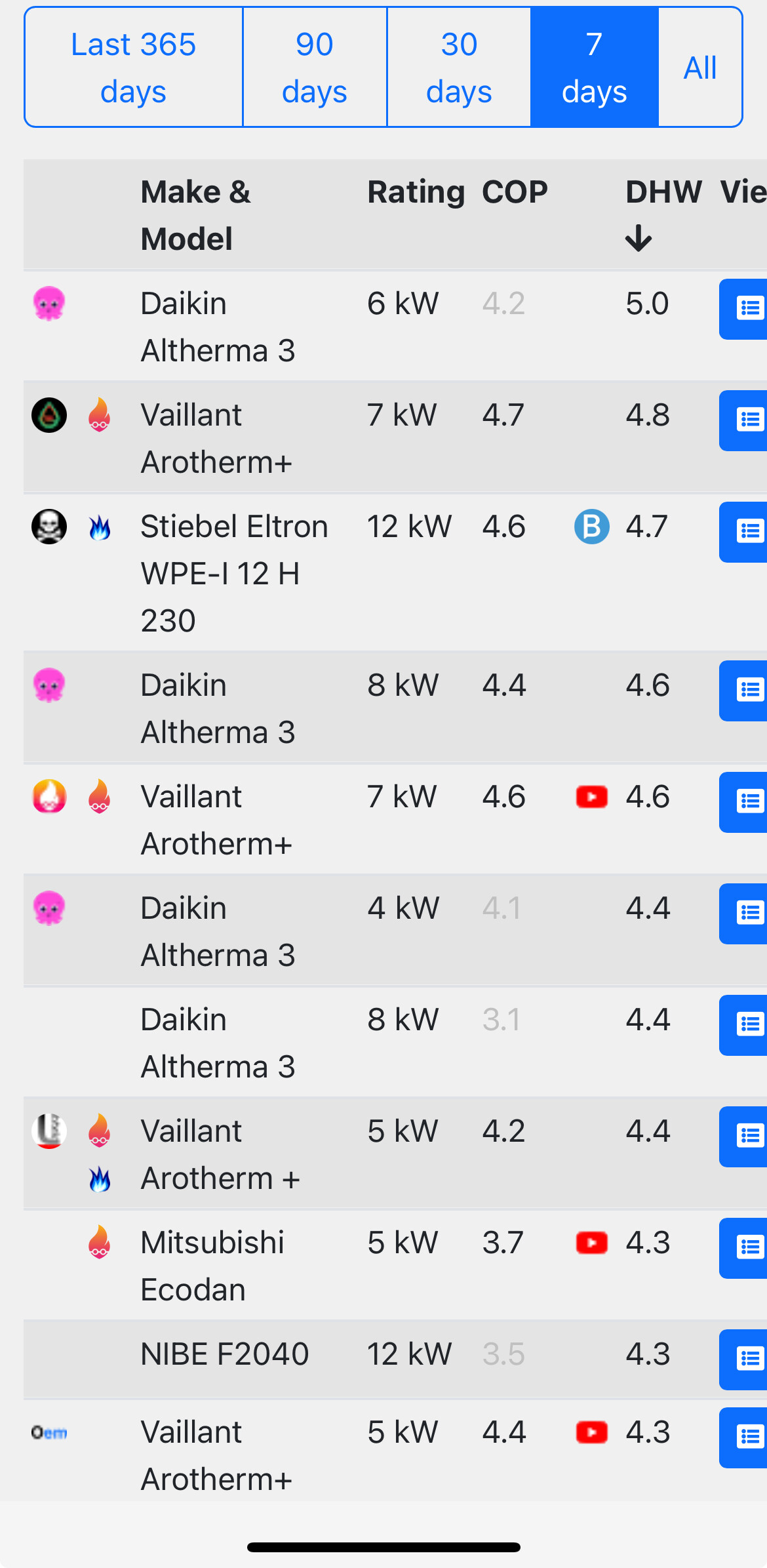

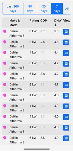

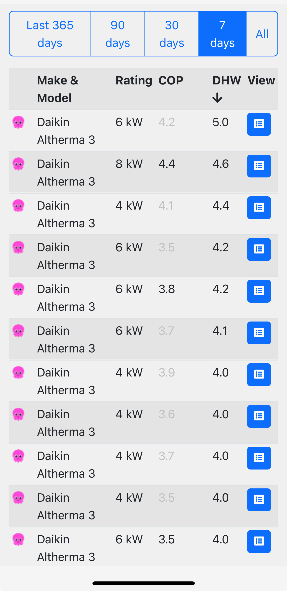

There’s some strong numbers on HPM for DHW this last week.
