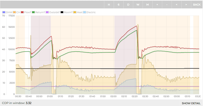

Hi folks, I’m getting poor COP readings for my DHW run (Altherma 3 8kw monobloc), these are typically 1.6 - 1.9. The 150 Ltr tank is set to 50 degs and runs around 12am for 60 mins, I’m only used about 50 Ltrs per day of the hot water, so it doesn’t drop too much in temp. The install was a retrofit by an independent installer, it’s the Daikin tank. The pipe run is about 8m to the tank and most of the pipe run is 28mm. Peak flow temp is 64.4 and return 61.1
I’ve dropped my data below.
Heat meter data
The heat output seems to collapse at the end of some runs, but is okay in others.

It seems odd that the Flow & Return temps are over 60C when heating the tank to 50C. I also have a DHW target temp of 50C and typically the Flow peaks at 55C with the Return around 51C, so you’re showing a whole 10C higher. It will be interesting to see what happens with the DHW target set to 45C instead.
Running for a full hour at roughly 7kW of heat output is a lot of heat to dump into a 150 litre tank. (My DHW run-times are around 20 minutes.) 7kW for an hour is enough to heat 150 litres by 40C (assuming I’ve managed to use one of the online water heating calculators correctly), i.e. taking your whole tank from 10C to 50C (or 20C to 60C).

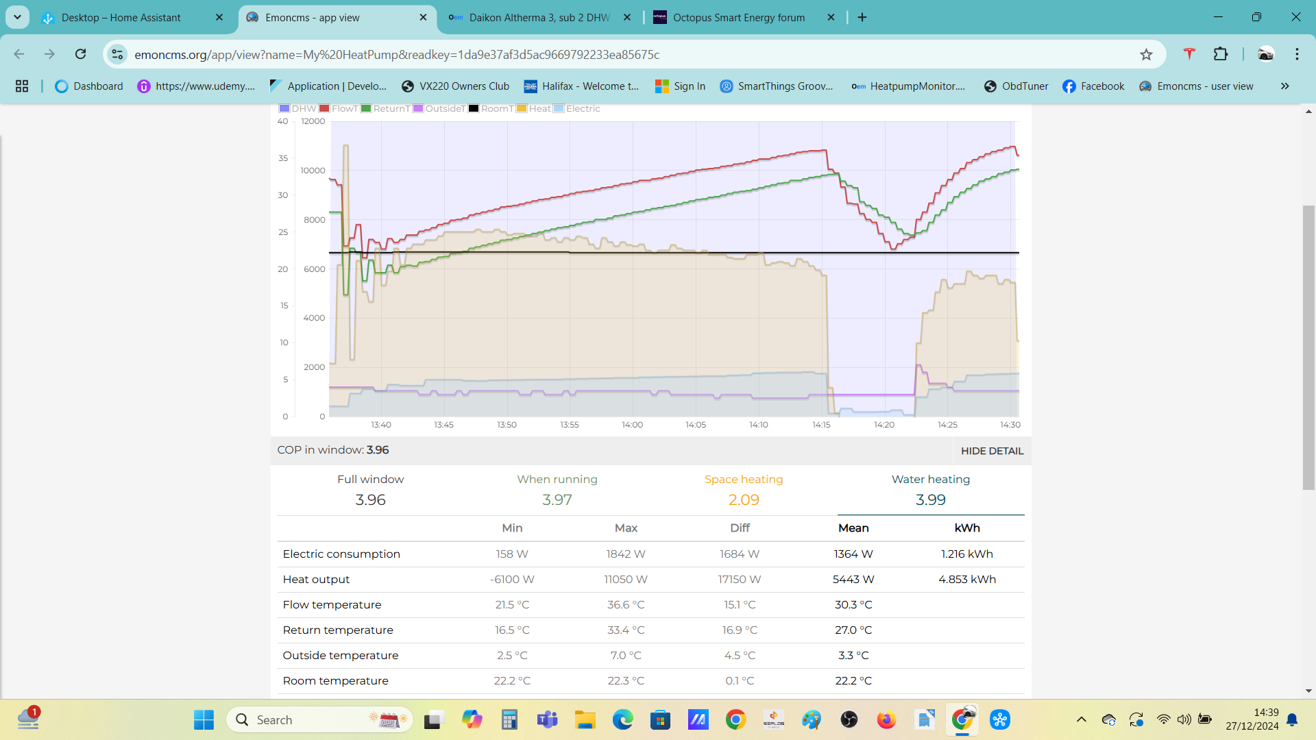

Ive had a play with Quiet mode today,
these are on reheat - not shedule
before quiet mode, starting temp of water heating is 20 degrees C
after quiet mode, starting water temp 11.8 dehrees C, unfortunately i got a defrost cycle during this test due to it only being 3 degrees outside and high humidity but will leave quiet mode on long term to see the amount of power i use on hot water and the cops , and also need to make sure it dosent effect internal temps to much for being on for longer
The hot water temp never got up to temp this time as the system moved back to central heating after the defrost cycle so need to watch this
https://emoncms.org/app/view?name=My%20HeatPump&readkey=1da9e37af3d5ac9669792233ea85675c
do you think because using quiet mode the hot water water is hotter throughout the tank ?
Running the DHW in 2 x bursts has definitely helped with the COP, last night it was ~2.9 in phase one and 2.15 in phase 2. In phase one the flow temp is hitting 51 deg and 60 is phase 2. I’ve also added a plot of the DHW temp rise (I don’t think I can add that to the emon plot)?
