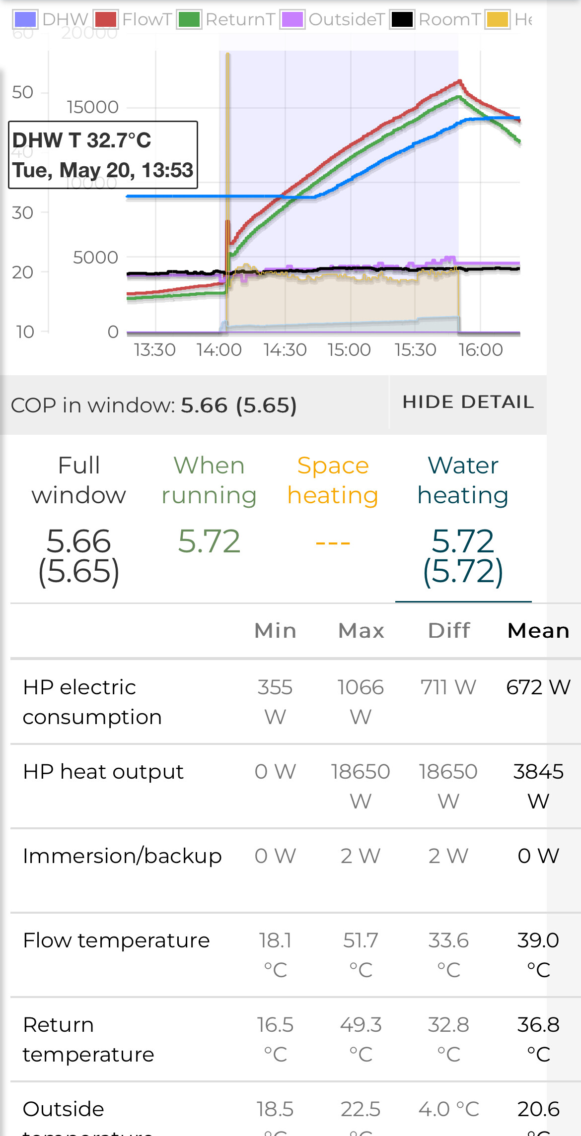

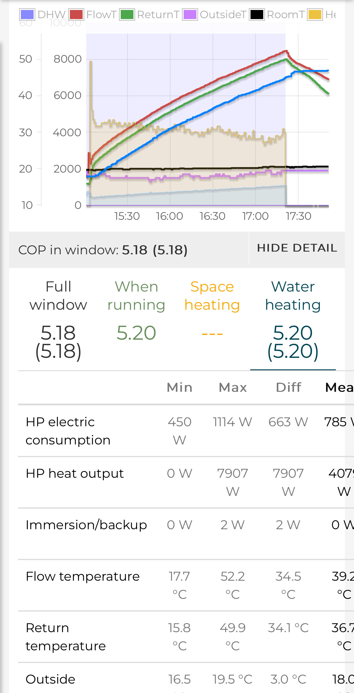

I have found that enabling quiet mode has a noticeable effect on the DHW efficiency as it throttles the output of the unit. My 4kW in “more quiet” mode will only output up to 4.5kW instead of the full 8kW without quiet mode. I’ve seen COP of up to 5.99 when running at warmest time of day in the recent heat, and 4.41 overnight last night. When I tried in non-quiet mode I got 2.84.
Discovered today that you can set a schedule for quiet mode, but I’ve not tried this out yet. As I’m only using DHW and not heating currently, this will be more useful come autumn/winter, to be able to set one quiet mode level for the DHW run, and a different one if needed for heating.

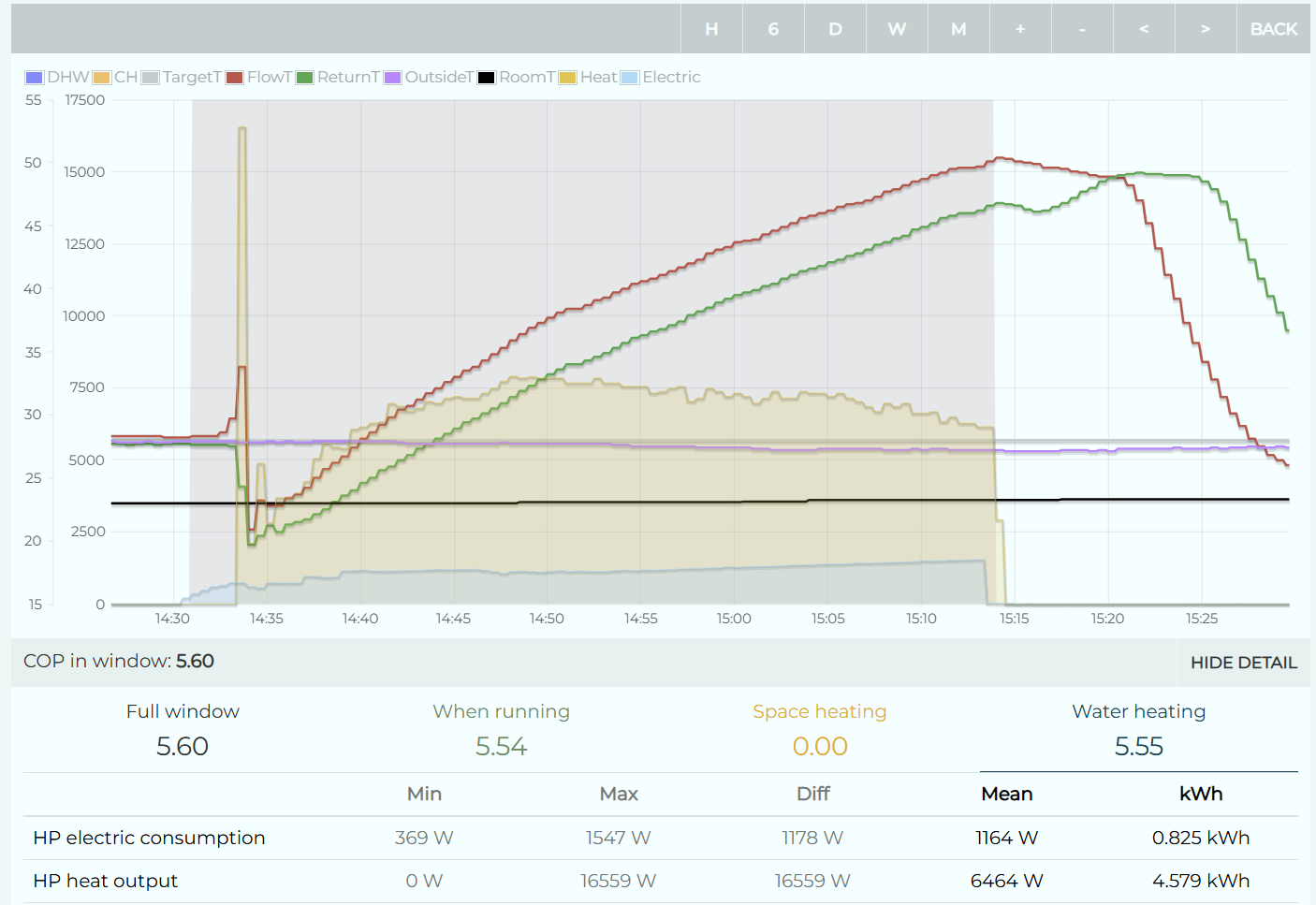

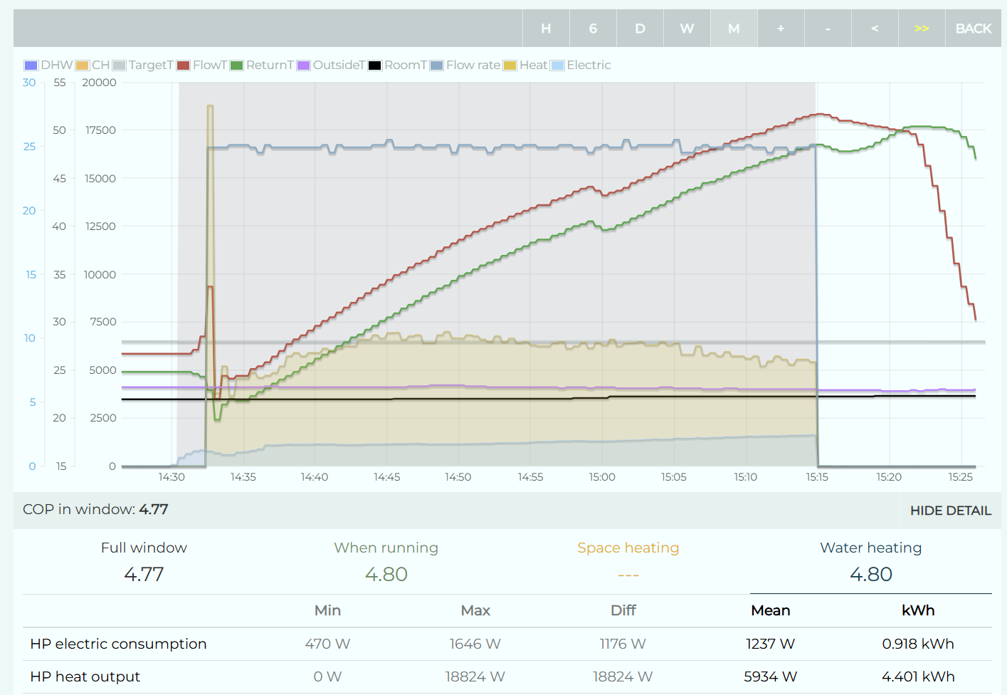

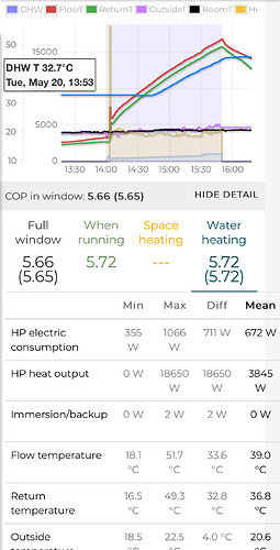

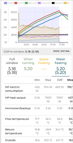

Here is my regular non quiet mode 8kW. I’ll try quiet mode and report back.
hmm, not a huge difference with the more quiet setting and its a degree or two warmer today as well

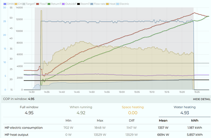

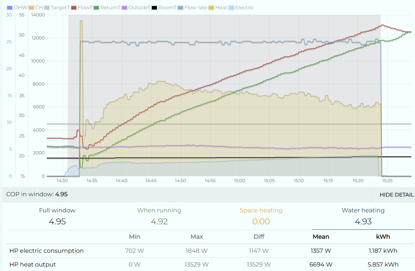

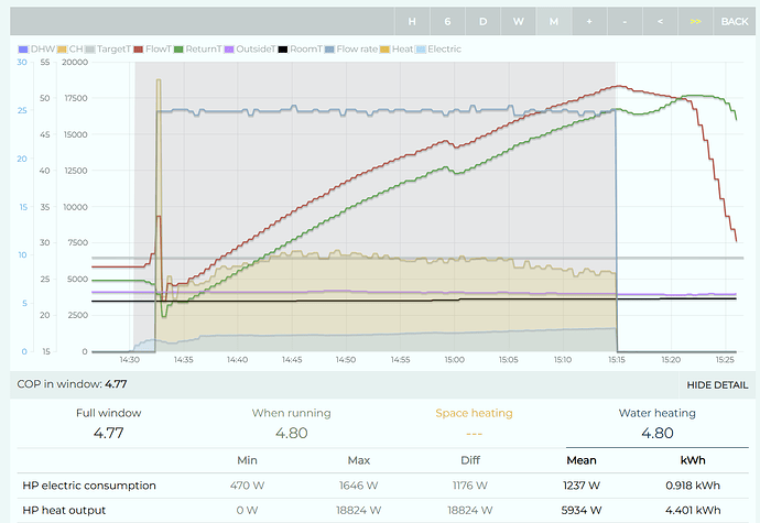

just tried on the quietest setting and no significant COP difference for me between non-quiet and the quietest modes. Maybe because I am always starting from a low temp.
Similar start temps ~15C
Same end temp 45C
Similar Outside temp, similar weather
Quietest (Quiet icon shown on MMI)
Normal (not quiet)

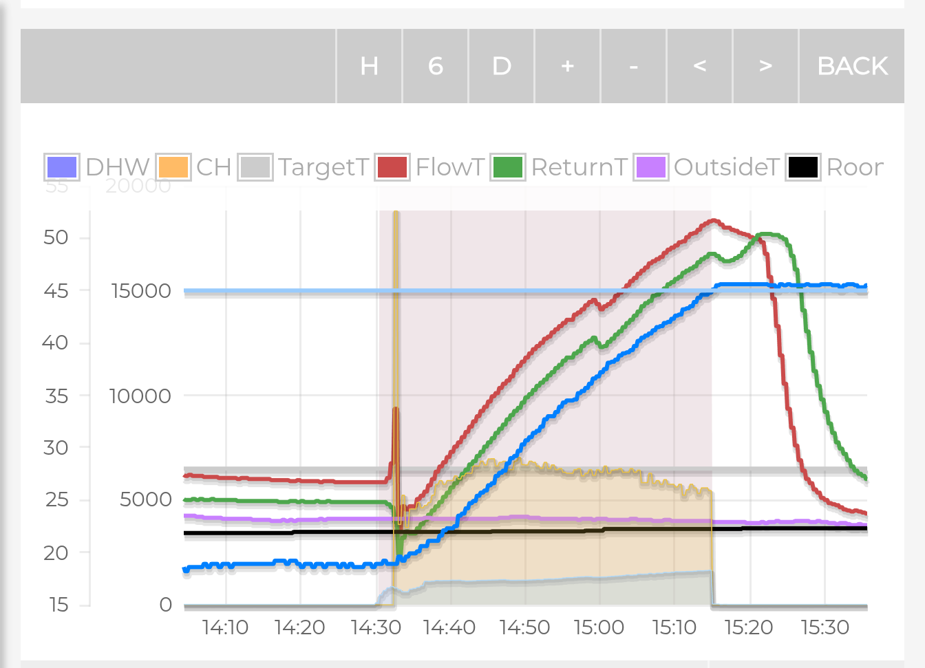

I’m also very interested in improving DHW cycle COP.

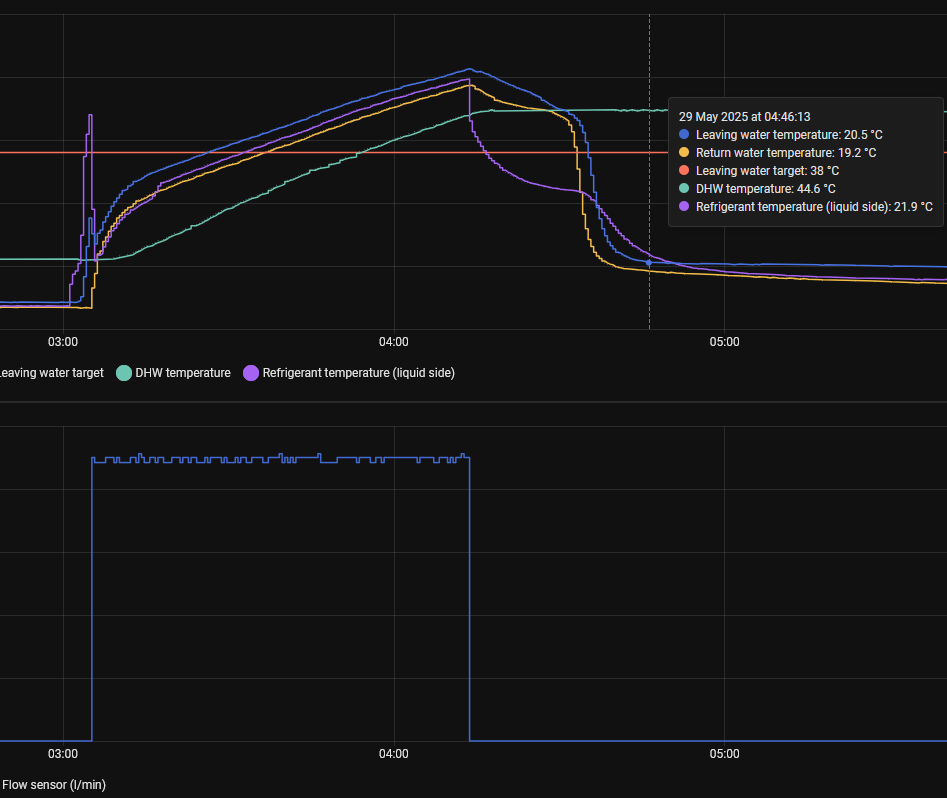

I keep seeing a lot of these posts with COP over 4 values for a DHW cycle. I have recently had a Altherma 3 (EDLA04E2V3 - the lowest 4kW model) installed, but I can’t seem to get a cycle with a COP much over 4, it’s more like 3 or below.
I’ve set up everything as described in the ESPAltherma article. I was wondering how you measure your stats for emoncms, is that via an approved meter or just based off the standard sensors?
I started manually double checking the values and they just don’t align, e.g.:
My last DHW cycle shows a COP of 4.04 for the cycle, but when manually calculating with crude numbers, and most optimal conditions the COP only comes to 3.01.
In more detail:
Starting tank temperature: 20.4 °C
Final tank temperature: 44.6 °C
Delta tank temperature: 24.2 °C
Tank size: 150 L
Required heat = 150 kg * 4,184 J/kg°C * 24.2 °C = 15188 kJ
Required heat in kWh is about: 4.22 kWh
Actual consumption during cycle: 1.40 kWh
Efficiency = 4.22 / 1.40 = 3.01
So there’s almost a whole factor of efficiency lost in what’s the theory and what I see in practice.
Obviously there’s limited advice what can be given without the details of the full install, I’m just wondering whether any of the above COP values posted by others have been self-verified in a similar way? Is it realistic to achieve a COP of 4 or 5 with a relatively low target tank temperature of 44 °C?

You may be slightly conflating two (or more) issues in your post.
The CoP that your system reports (4.04) is referring to the heating efficiency of the heat pump (i.e. the energy that it’s putting into the circulating fluid compared with the energy required to do so), and not that of the DHW tank. Some of that circulating fluid energy never reaches the water in the tank - part is lost from the transfer lines between the Outdoor Unit and the DHW tank (through the insulation etc.), part is unaccounted for due to heating the circulating fluid itself (i.e. you are heating somewhat more than the 150l actually in the tank), and part is consumed heating the tank wall and the circulating pipework/pump (maybe only a few kg of copper but it all adds up).
Also, are your tank temperatures (start and end) representative of the whole DHW tank? And is the “end” tank temperature at steady state? DHW tanks are inclined to form temperature layers - especially during heating - so you cannot expect a single thermocouple to report a true average tank temperature when you do your heat gain calculations. Furthermore, tanks can go on heating for quite a while after the heating fluid flow ceases, due to continued in-tank convection - you may find that your “real” final average tank temperature is several degC higher than you suppose, as thermal equilibrium slowly takes place (which can easily take half an hour). In which case, you may well be heating your tank more than you thought (and took credit for in your calculations).
Personally, I wouldn’t lose too much sleep over apparently modest DHW run CoPs - unless you use the shower a dozen or more times a day, DHW energy is quite small compared with space heating energy, and I’d suggest that you focus on the latter if you are keen to get that last 0.1 CoP out of your heat pump…

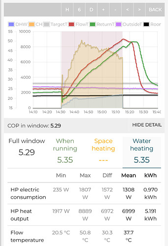

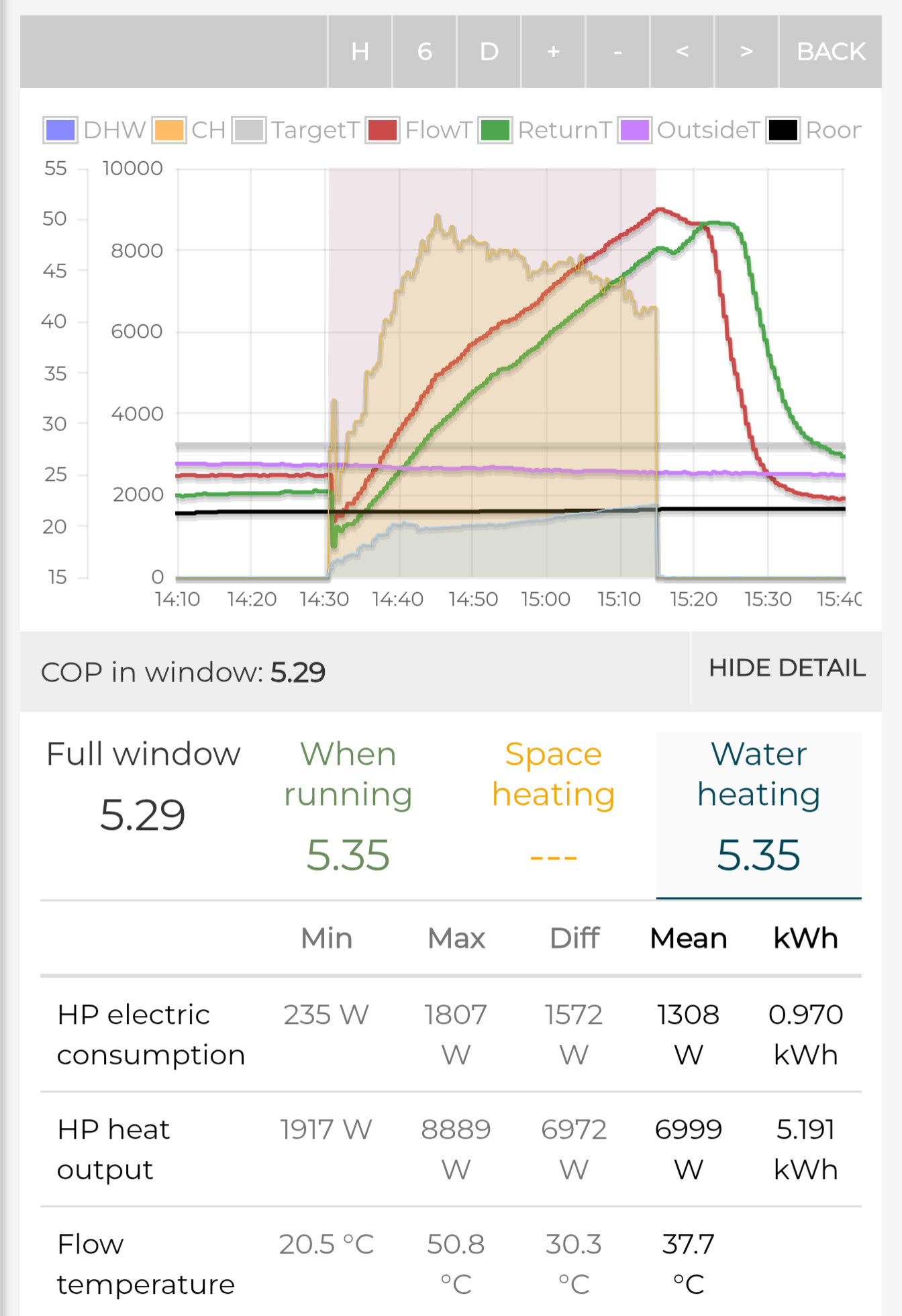

Your last DHW cycle COP according to emonCMS is actually 5.2! It looks like you have done everything recommended for optimum efficiency:
Heating from cool by using most of the hot water to maximise efficiency at the start of the cycle.
Running the cycle at the time when the outdoor air temp is highest, when there is maximum heat energy in the air.
Running in quiet mode to limit the output of the heatpump and again improve efficiency. This seems to have a more marked effect with the 4kW Daikin.
Here is your emonCMS data:
and here is mine from yesterday:
Obviously we are both using ESPAltherma and not a MID calibrated solution, so we can’t directly compare our data with one another. We can however compare our own DHW cycles, and I have found the above settings to work for me.
Thank you for the welcome and for your very detailed response.
I understand the physics behind it, perhaps I was just a bit confused about the benefit of measuring the efficiency of my heat-pump output rather than the system as a whole. If I lost most of the heat e.g. on the transfer lines, it’s not much good that my HP output directly is efficient. However, I do understand that there’s a lot of settings, and different ways to run these, so it’s also important that the HP itself is running as efficiently as it could, and that I’d need a lot more expensive equipment to try and measure everything accurately anyway.
I’ve attached a diagram of the water temperatures of my last cycle in the hopes that it might answer some of your questions. According to the temperature sensor readings, it heats very little more after the cycle stops - but I have also noticed (although difficult to measure) that the water might very well be warmer than 44 degrees on average at a target temperature of 44.
I’m just keen to get the system working as efficiently as possible, I only got it installed less than 2 months ago and got very little information from the installer. I appreciate that heating will use a lot more energy, but I have to wait until September with to tweak that as I don’t really need heating at the moment.
I’ve noticed most people with Daikin HPs have this in their charts, am I missing something in understanding why in DHW cycle mode they don’t start circulating immediately - or at least when the LWT is higher than the tank temperature? It only seems to be doing it once the refrigerant temperature has reached your DHW target. Is this to avoid potentially cooling down the water temporarily instead of heating?

Sorry I don’t have a Daikin so I’m not familiar with your controller algorithms, but it does look like you are correct - the heat pump appears to run for ~5min before starting the circulating pump, presumably to warm up the refrigerant in the condenser so as to avoid temporarily cooling the DHW tank water.
(By contrast, my Samsung controller starts the circulating pump from the moment the programmer requests a DHW run. It avoids that initial cold water hit on the tank by circulating fluid round the radiators for a minute or two before flipping the diverter valve to DHW. Interesting how different vendors solve this problem in such different ways.)
