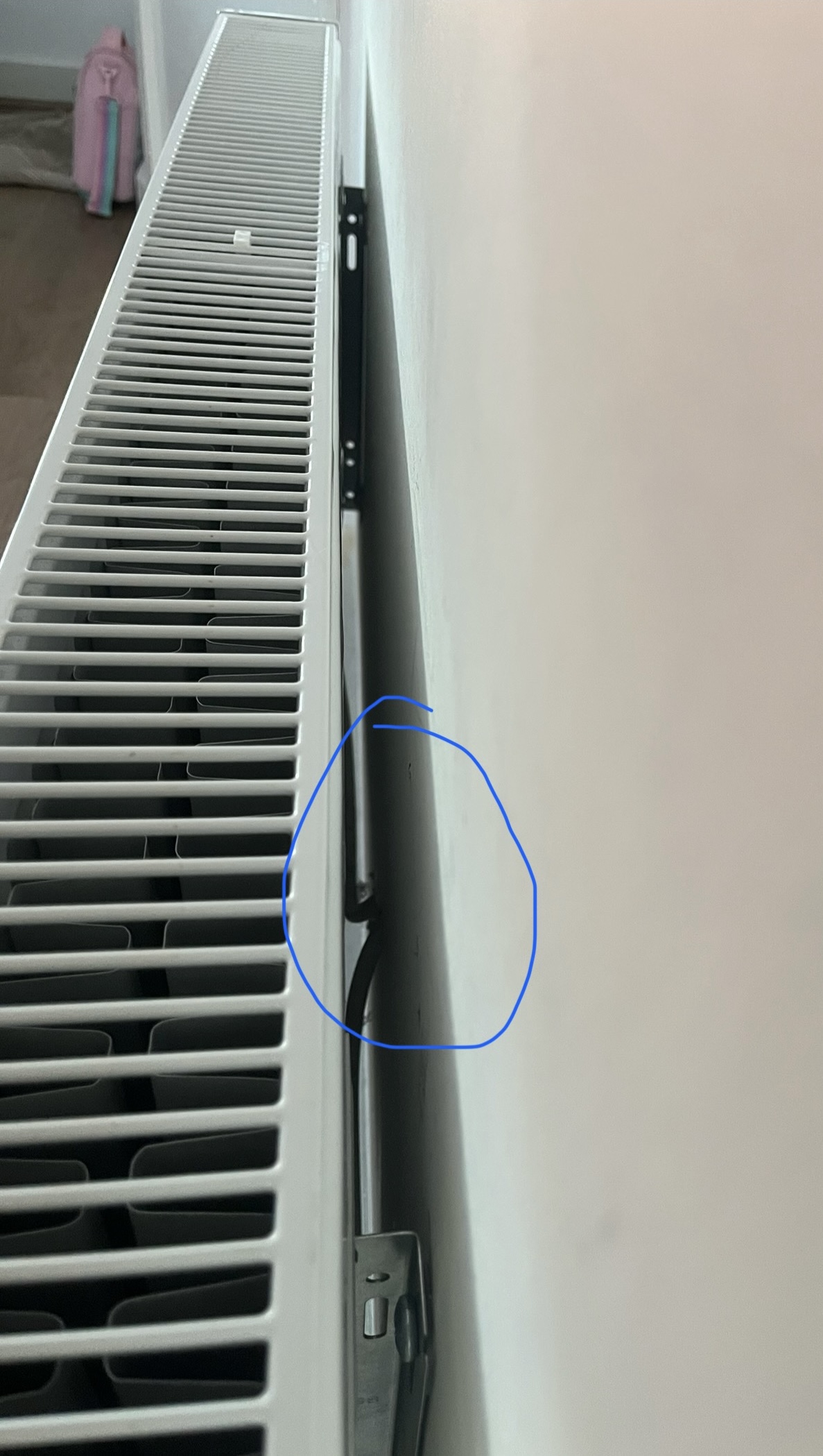

It’s hard to get a picture of the back of the radiators, I see there are two separate tubes going into the walls. Tried to show it in the picture below
Does this confirm the pipe layout for hot/cold is separate ?

  1. It looks like you have microbore radiator flow/return pipework. This can make radiator balancing slightly more tricky because of the increased pressure drop, especially for radiators at the far end of the system.

Your pipework in the photo looks as per normal so I think we can discount hot/cold being the same pipe.
