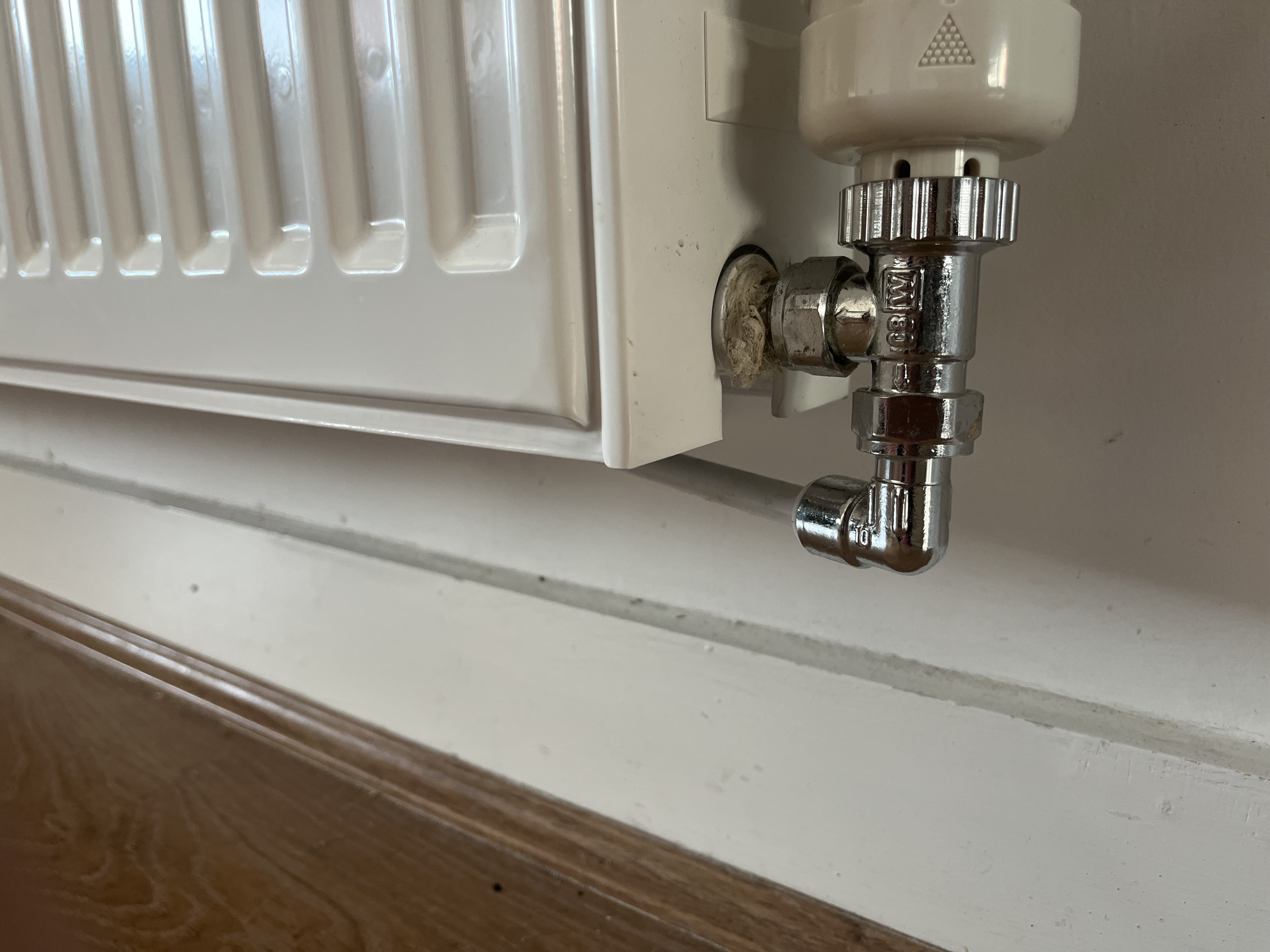

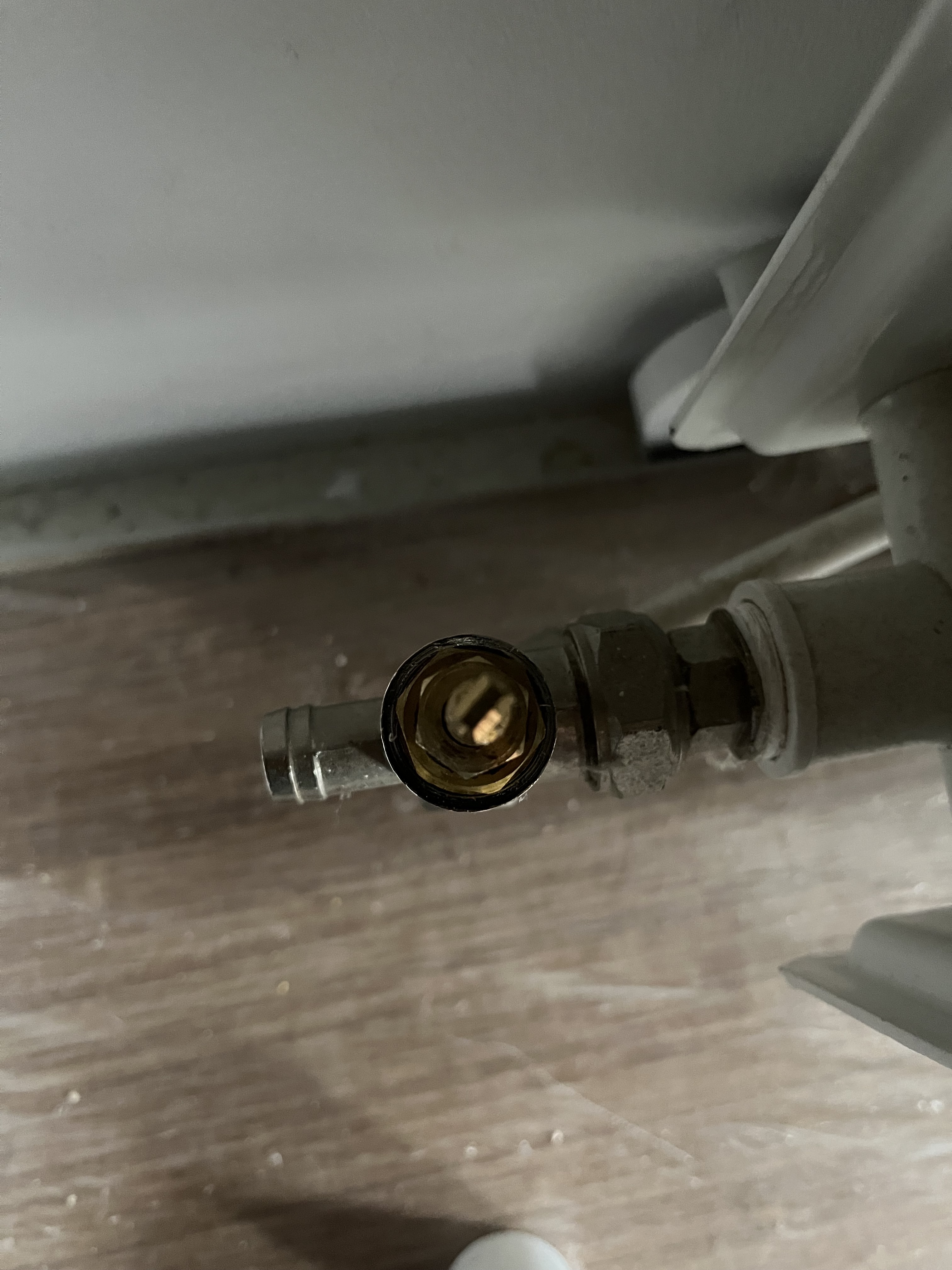

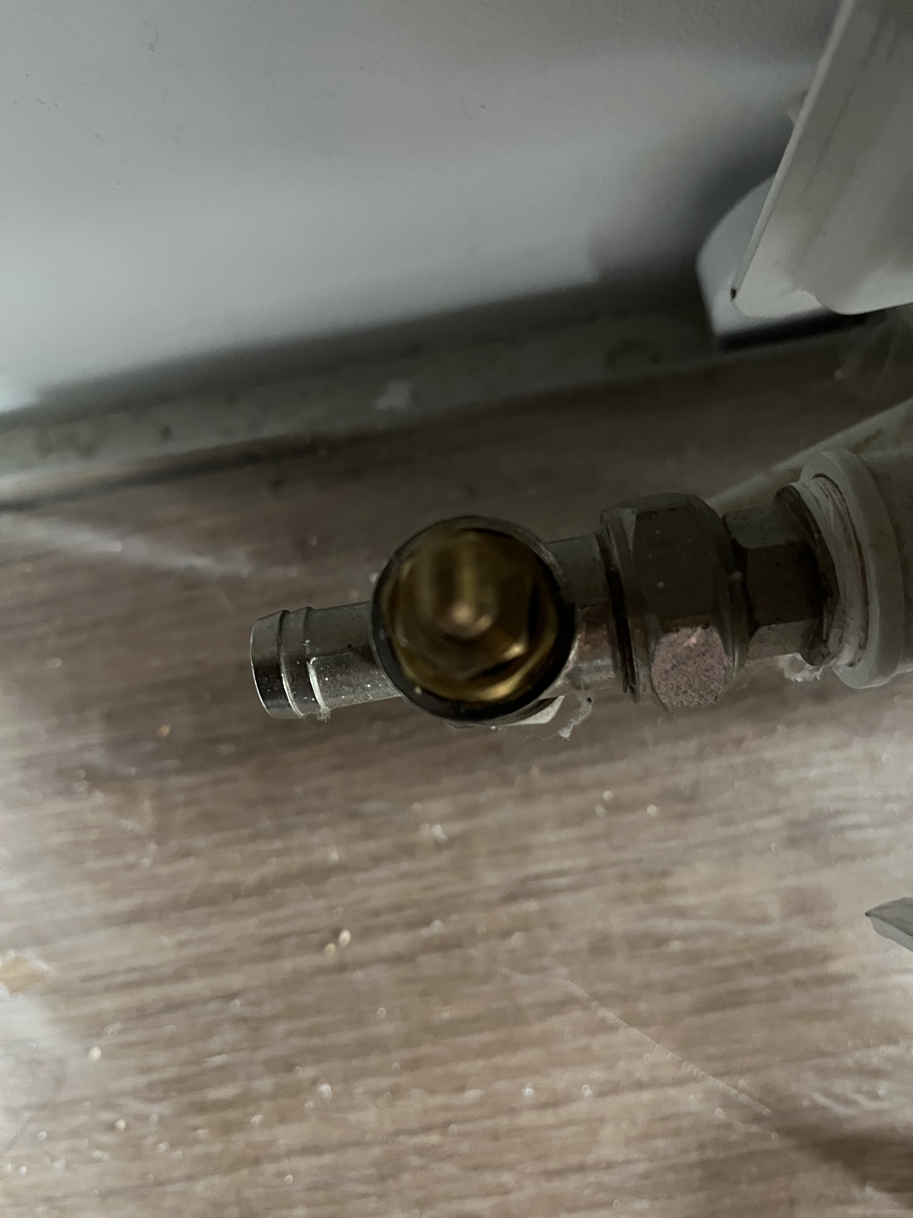

I have started on the balancing the kitchen radiator. To start with it was only about a quarter turn away from fully open. I have opened it up fully now.
Before
After
Thank you for that. For now I don’t have any equipment to measure the flow/return temperatures. I have started on balancing the radiators by trial and error.

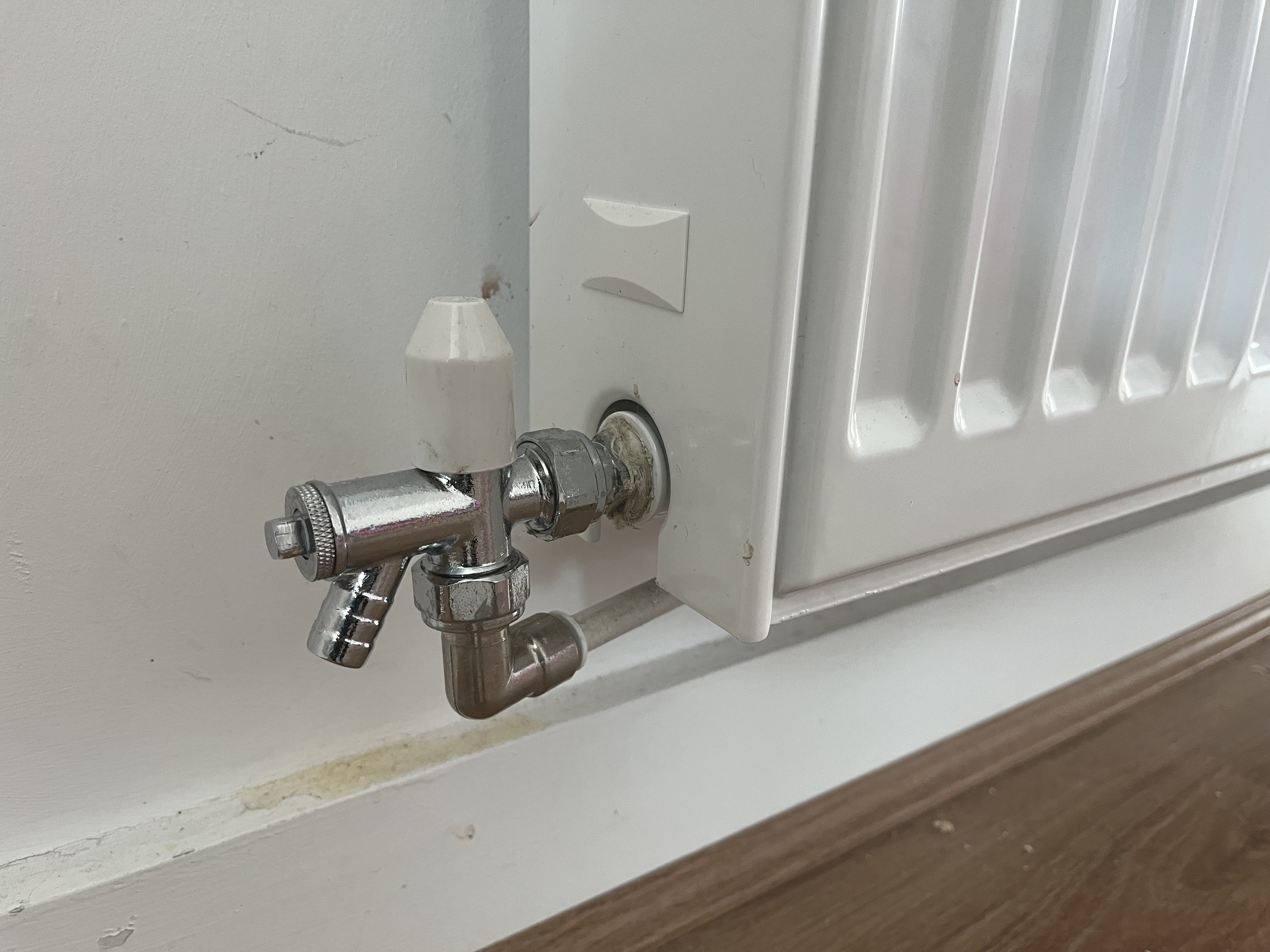

Good to know. Yes I suspect balancing is the suspect. I also noticed on checking the lockshields on other radiators. The one in the entrance hallway close to the thermostat has the flow nearly fully open. I suspect this might cause the thermostat to register higher temperatures faster and cut the flow to the house. After checking how the kitchen radiators now behave, I will close down the hallway a bit more.

Great, see how that changes things. is there a valve of any sort at the other end? If so open this too.
You can use your hands in the first instance. Its not super accurate but for your kitchen to not be warm we are looking for a really big difference. If your flow temperature is about 40C then feel the pipes at either end of the kitchen radiator. If they feel the same, or similar temperature then water is flowing through the radiator fairly quickly which is what we want. If there is a marked difference or one end is virtually cold then we have a problem. Also check that your radiator feels similarly warm all over, and that the back panel is also warm.

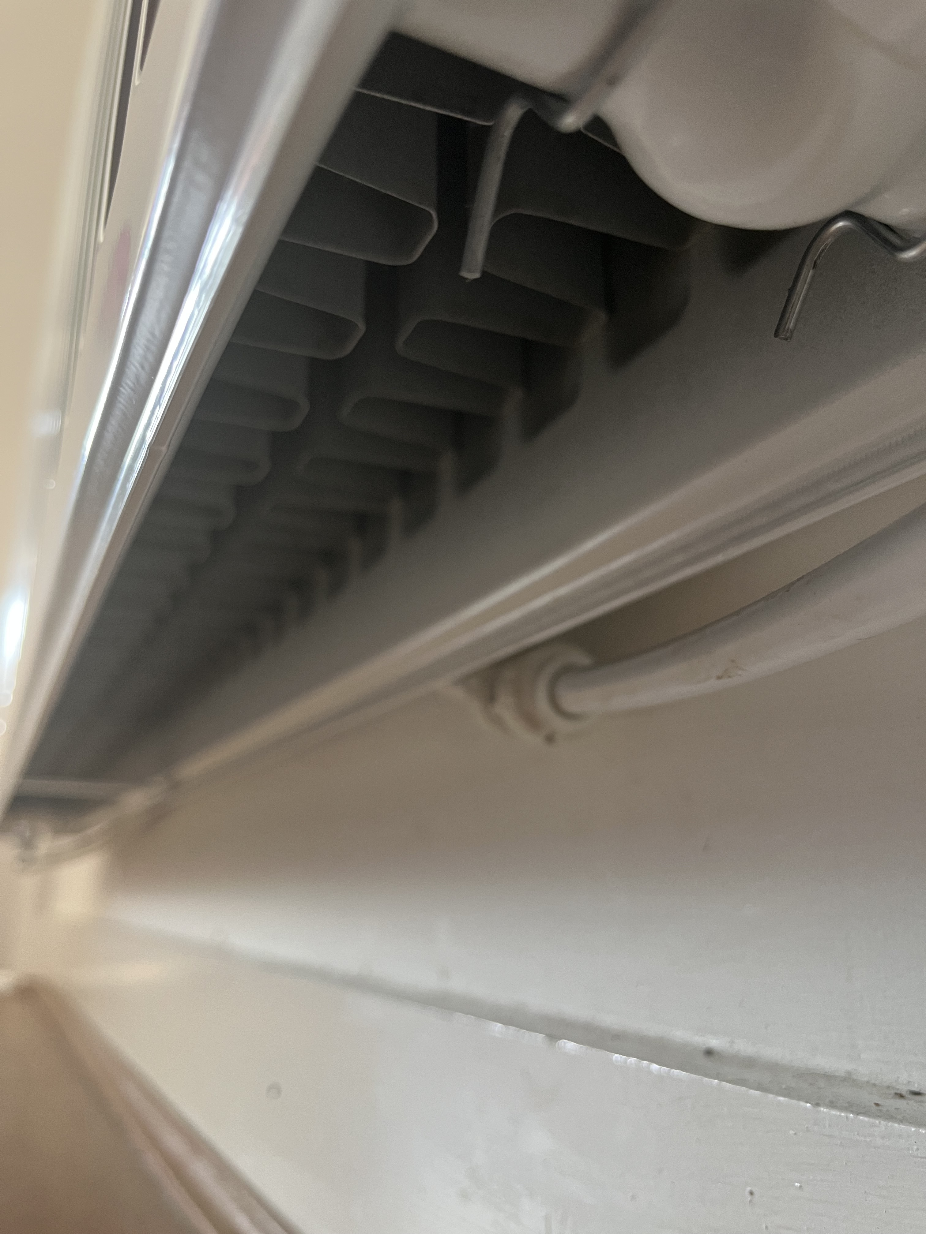

That is worrying if that’s the case in ours. I took some pictures of the hallway radiators and it indeed looks like there is a single pipe that takes in and lets out the flow?
I can see the pipe from either end goes towards the middle of the radiator (presumably into the wall?) but I can’t see from the photos that they are connected.

I can see now that your pipes are plastic so less good for feeling. Instead use the silver bits between the radiator and the pipe.
I have compared it with the living room radiator and now I can see the kitchen radiator warming up similarly (post lock shield adjustments). I do not know though what the entry exit temperature is. So it is all just subjective for the moment.
