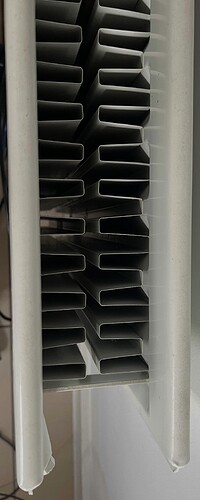

The issue is we are finding our kitchen unusually cold (measuring temperatures at 16-17). Thermostat in hallway set to 18-19. Installer is claiming this is by design and we need to run it as the highest designed temperature (21-22) to get the kitchen to 18.
The kitchen radiators were not replaced as part of our install as they were deemed adequate. They certainly don’t seem to be and this is causing significant discomfort. The kitchen is adjacent to living room and we find it to be a cold pocket. Question is how do I calculate the radiator requirements if I want the kitchen to be at 20?

Does the kitchen have a radiator with two panels, with fins on both panels, that is 1100mm wide and 530mm high?
If both those things are true then the heat loss survey is probably correct and the issue is with the radiator itself / plumbing.

For 2. this is how our radiators look like
How do I know if this type is suitable for a heat pump install which runs at a lower flow temperature compared to boilers?
How do you know if they are suitable? Basically, if their heat output at the mean flow temperature is equal to or greater than the heat loss of the space. So if the rad is a K2 or Type 22, like that one you show, and it’s 1200x600mm

The radiator is a double panel with fins on both panels, commonly referred to as a K2 radiator. This is what the radiator schedule says you have.
That is suitable for a heat pump and from everything you have said the radiator you have should be more than adequate.
