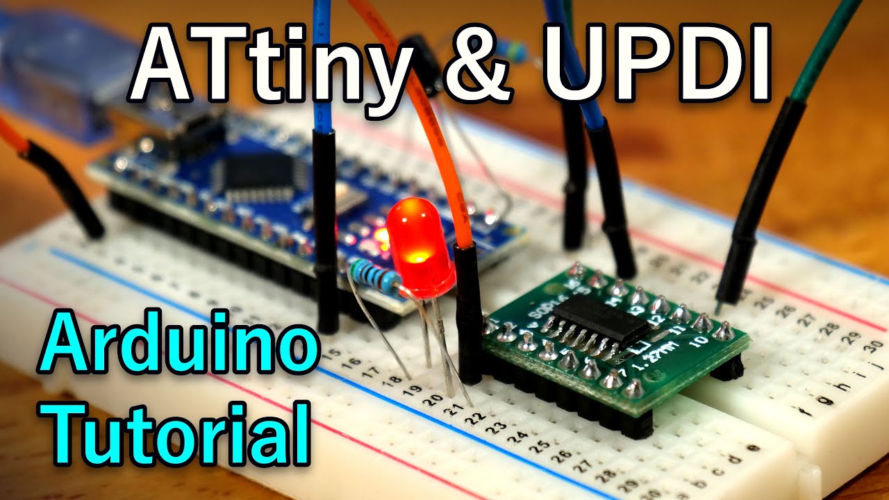

Hi @shampeon
The ATTINY1614 on the shunt uses UPDI programming rather than the usual Arduino style.
Therefore, you need a device in the middle to translate AVRDUDE commands into UPDI programming “speak”.
I use an old Arduino Uno I have lying about, you program some code onto that, then AVRDUDE works as normal (this Uno replaces the USBTiny)
These links may help…
[Create Your Own UPDI Programmer - Arduino Project Hub]
[Programming the new ATtiny from Arduino using UPDI [Beginner Tutorial] - YouTube]
