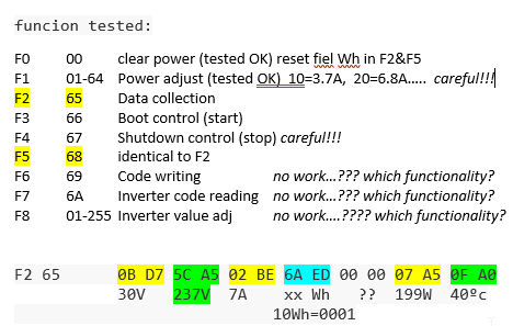

Inverter command summary:
Inverter power is cleared--F0 FF FF FF FF FF FF 00 00 80 01 FF FF 00  The same return value
Power adjustment-----F1 FF FF FF FF FF FF 00 00 03 00 FF FF 01---64 The same return value
Data collection------F2 FF FF FF FF FF FF 00 00 03 00 FF FF 65 According to the above example
Boot control-----------F3 FF FF FF FF FF FF 00 00 03 00 FF FF 66 The same return value
Shutdown control-------F4 FF FF FF FF FF FF 00 00 03 00 FF FF 67 **The same return value
 Chart data-----------F5 FF FF FF FF FF FF 00 00 03 00 FF FF 68 Same as F2 Inverter
code writing-----F6 FF FF FF FF FF FF 00 00 03 00 FF FF 69 The same return value
Inverter code reading-----F7 FF FF FF FF FF FF 00 00 03 00 FF FF 6A The same return value
Inverter value adjustment-----F8 FF FF FF FF FF FF 00 00 03 00 FF FF 01---255 The same return value

I think that F0 to F5 are clear and work fine.
The more important is
F2 and F5 are similar. Data:
It’s very strange two function with identical functionality… something must be different… any idea?
I tested all field less one…
The energy (Wh counter) is express in 10Wh unit.
F0 reset this energy counter (tested OK)
After reset, I spend 12minutes with 100W load, the counter passed to 00 02. Then a count (00 01) is 10Wh.
F1 is adjustment of power. Work very fine. In my WVC600, 10 is about 3.5 A and 20 about 7.0 A.
64 is full power but I can’t test with my power supply lab (30V 10A).
F3 is switch on
F4 is switch off.
Be careful using this. If you send this command and later have communications problems… the inverter don’t produce energy… if you made master reset (Vdc and Vac disconnection) the inverter don’t back to produce energy. It’s necessary send the switch on command.
In other words, commands are memorized. you need to configurate the inverter properly to be functional. This is my concern about F6 and other commands. Please information to avoid to ā€œbrickā€ my inverter… Probably there are a command to know the status of configuration.

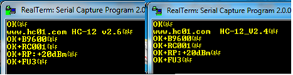

Now my experience with HC-12
I’m dealing with three units. One removed from WVC600 inverter, tested outside and later back to the inverter, this is V2.6. Others two by in Aliexpress V2.4.
All of then working in default mode: 9600, FU3…
I don’t know how update modules. I could read the code v2.6 and save it in the V2.4. Any idead how proceed?
The three modules work fine working together doing a kind of net or bus.
For this test (outside wvc600 inverter) I used helicoidal antennas.
After read parameters in configuration mode (attached screen) and test quality of link and communication, I back the v2.6 to the WVC600 inverter. I thought radio link was OK.
