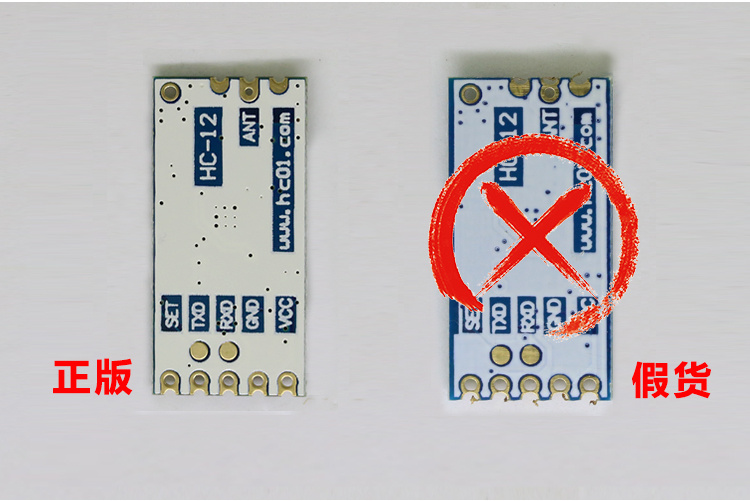

The only one I would describe as original is that oh my WVC300. The problem is that there are counterfeits as seen on the site of HC01 the manufacturer of HC-12
look at the “white-egg” color of the Original !
for more authenticity informations : HC服务中心
Concretely: the modules are bad or defective or only communicate between the two modules you just bought on Aliexpress like the last ones I took! :frowning_face:
The originals are several hundred meters, the others are no more than a few meters!

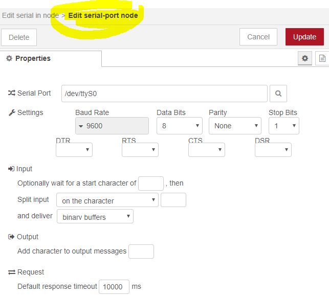

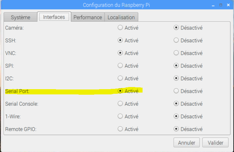

I have been using my RPI to run node-red with the HC12 directly connected to the UART pins of the GPIO for 1 year. I had no disconnection .(Only change 5v power supply : god save China lol)
I configured the RPI like this:
in RPI
in node-red actually working
BE CAREFUL of the connection! From my memories, you must use 3v3 to power the HC12 because the logic levels of the UART are between 0v and 3v.

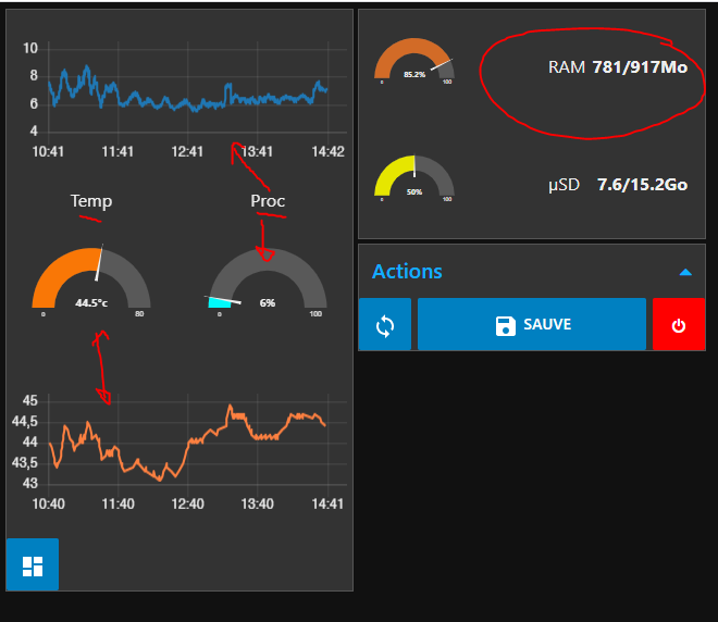

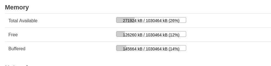

I consume a lot of RAM because it does a lot of things other than a photovoltaic monitor.
I do not use red-node dash for that reason - it can be very hungry-- my memory is quite low at
and with running zigbee@mqtt, influxdb, cronograf ( my dashbord), kapacitor, domoticz, collectd all while acting as router on openwrt os using a 2 core Banana pi -R1 with gig of memory

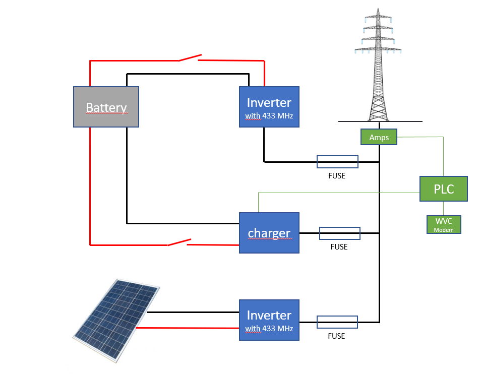

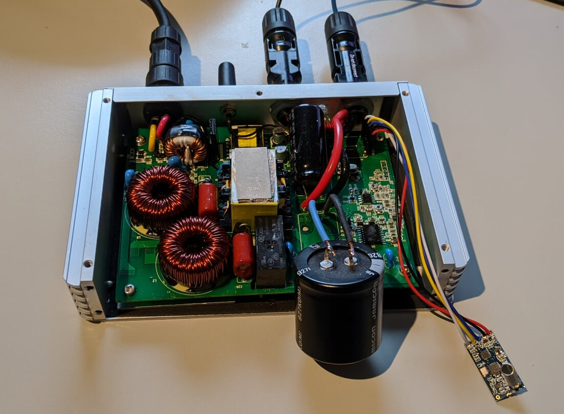

I build my own battery storage.
Normally the MPP Tracker isn´t good to use behinde a battaery.
@ Ducati

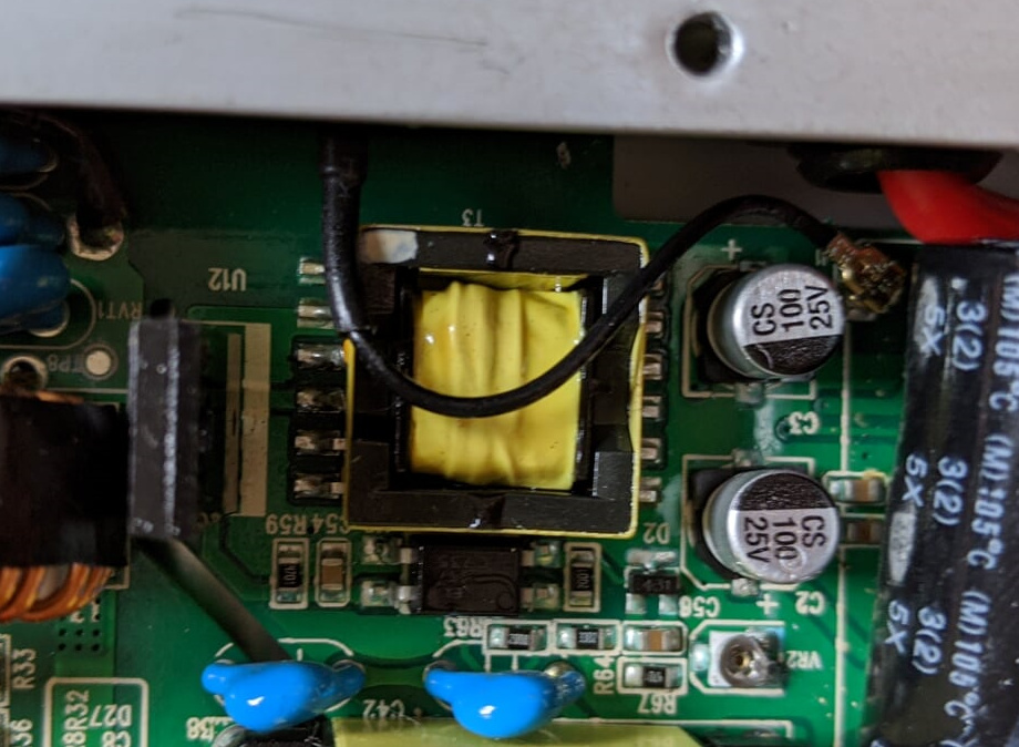

Inside the Inverter the antenna cabel is near by a lot of electronic components. And especially the coil cause a lot of magnatic fields → emc.
Maybe it could be a solution like that. I took the HC12 of the Inverter and it works very good.

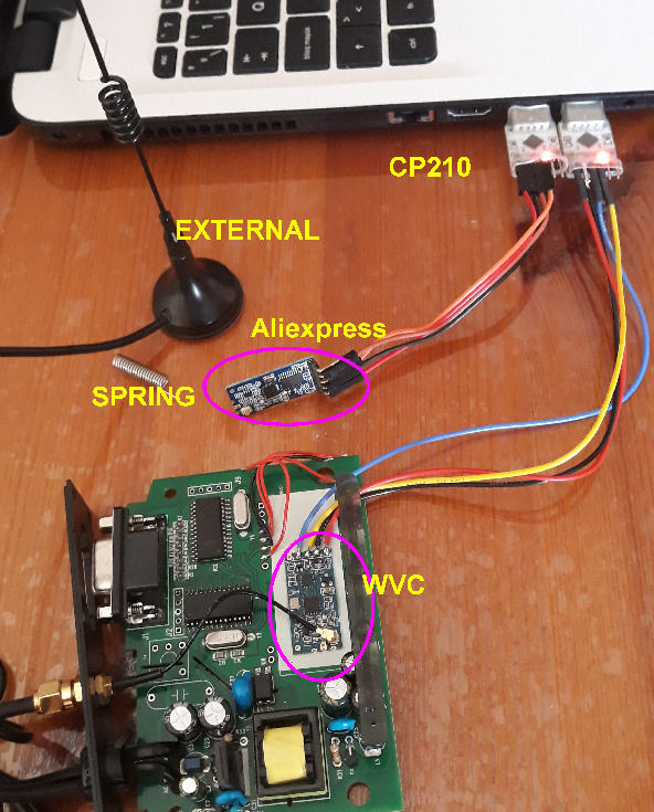

Following with HC-12 experiences
My setup Portable PC with HC-12… only work to 1 meter. Very weak radio link.
Then I removed from my modem R2 the HC-12 with an external antenna. And… voila, WORK!! fine several meters and walls…great!!!
In order to clarify I tested several options at the same time.Portable PC with:
  • CP210 + HC-12 from WVC + External antenna → work fine
  • CP210 + HC-12 from Aliextpres +spring antenna → not fine
  • CP210 + HC-12 from Aliextpres +Ext antenna +100uF → not fine
  • CP210 + HC-12 from Aliextpres +Ext antenna → not fine
    -CP210 + HC-12 from WVC + spring antenna → no tested
My conclusion. My HC-12 from Aliexpress is garbage, only works in short distances.
How to distinguish garbage or valuable?
One HC-12 is v2.4 and other V2.6. Enough reason?

see here : exist counterfeits HC-12

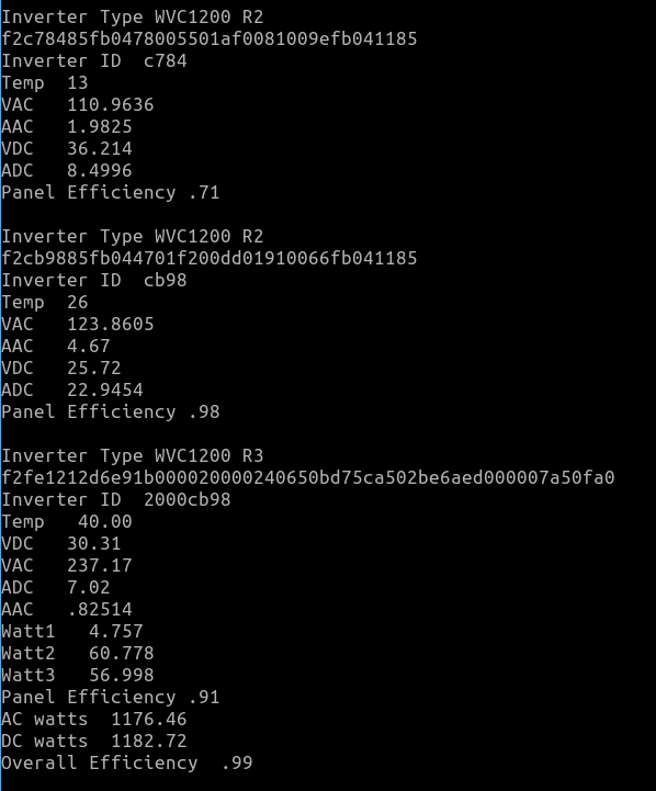

for any one who wants to try here my interceptty version
I am pretty sure it works +95% okay just not sure on the total wattage… would have to run a constant input for 1 hour and do a comparison to either test watt 1 2 or 3 ( in the r3 inverter display)
it publishes mqtt in the background ( to either influx database or to tft display screen) so adjust to your preference and has an output display for debugging purpose and can test against key file for the R3 ( how I debugged it for errors since I do not have my inverter yet)
command line: example (fb041185 is your modem id if using hc-12 can be anything 4 byte otherwise it should match your Modem ID )
./wvc /dev/ttyUSB0 /home/stephen/WCVF/wvc.ini fb041185 hc
I uploaded to Github currently as it is – as I believe my inverter will be probably at least a month before it shipped due to coronavirus – if anyone has issue let me know what error you get… if any and I will try resolve it for you…
