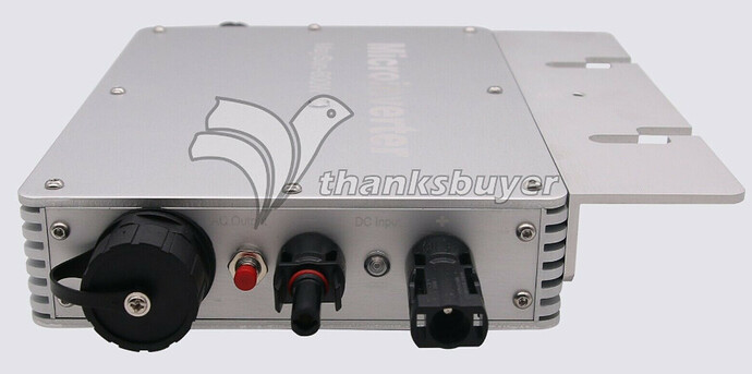

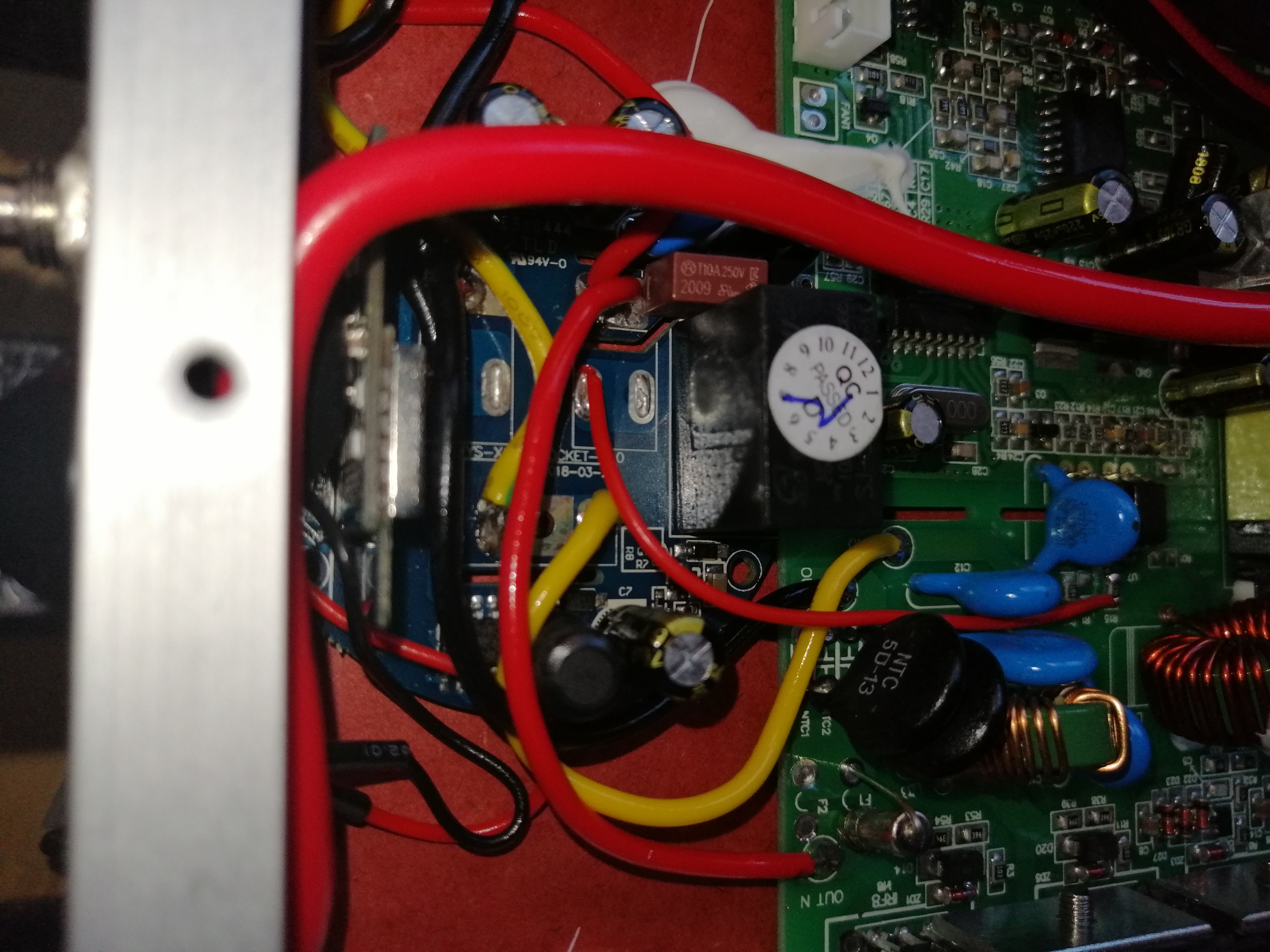

Hello WVC owners!
I purchased an WVC600 last year and only just got around to using it at the weekend. My inverter works fine, but looks nothing like the pictures you show here. For instance it has an external button!
I’ve no idea what the button does…
The unit seems more like the GTB-600 (like this https://www.amazon.co.uk/Elikliv-GTB-600W-Inverter-Converter-Communication/dp/B088GQMKJ2)
Inside, there isn’t any sign of an HC12 device. The ebay seller describes this unit as WIFI ready and you can connect directly with an app - although I don’t have the APP and I don’t see any WIFI hotspot.
maybe it powerline Ethernet version as this description says it is
https://www.amazon.com/Elikliv-Inverter-Converter-System-Communication/dp/B088YP55TR
though this one suggest it is you can get it hc12
https://canada.desertcart.com/products/206799708-elikliv-gtb-600-w-wi-fi-micro-inverter-grid-tie-converter-ip-65-mppt-for-solar-panel-system-w-communication
what the name of the blue circuit board it almost looks like it has an esp8266 attached upright on the outside edge to it but hard to tell
I’ve done some more research. It looks like there is an Android app from this site
http://e.tuya.com/smartlife
which you install (if you dare!). Then you power off the inverter and power back on and press the external button to enable installation mode.
The app should then find the inverter and it then ask to connect to your home wifi network (again if you dare disclose the password to a Chinese app).
Think I’ll need to get back on the roof and take the thing apart again!
Just to add, got it all working and it is using the TUYA protocol/cloud service.
Theres a lot of code on the web for talking to these devices and you can also reflash them with GitHub - ct-Open-Source/tuya-convert: A collection of scripts to flash Tuya IoT devices to alternative firmwares
