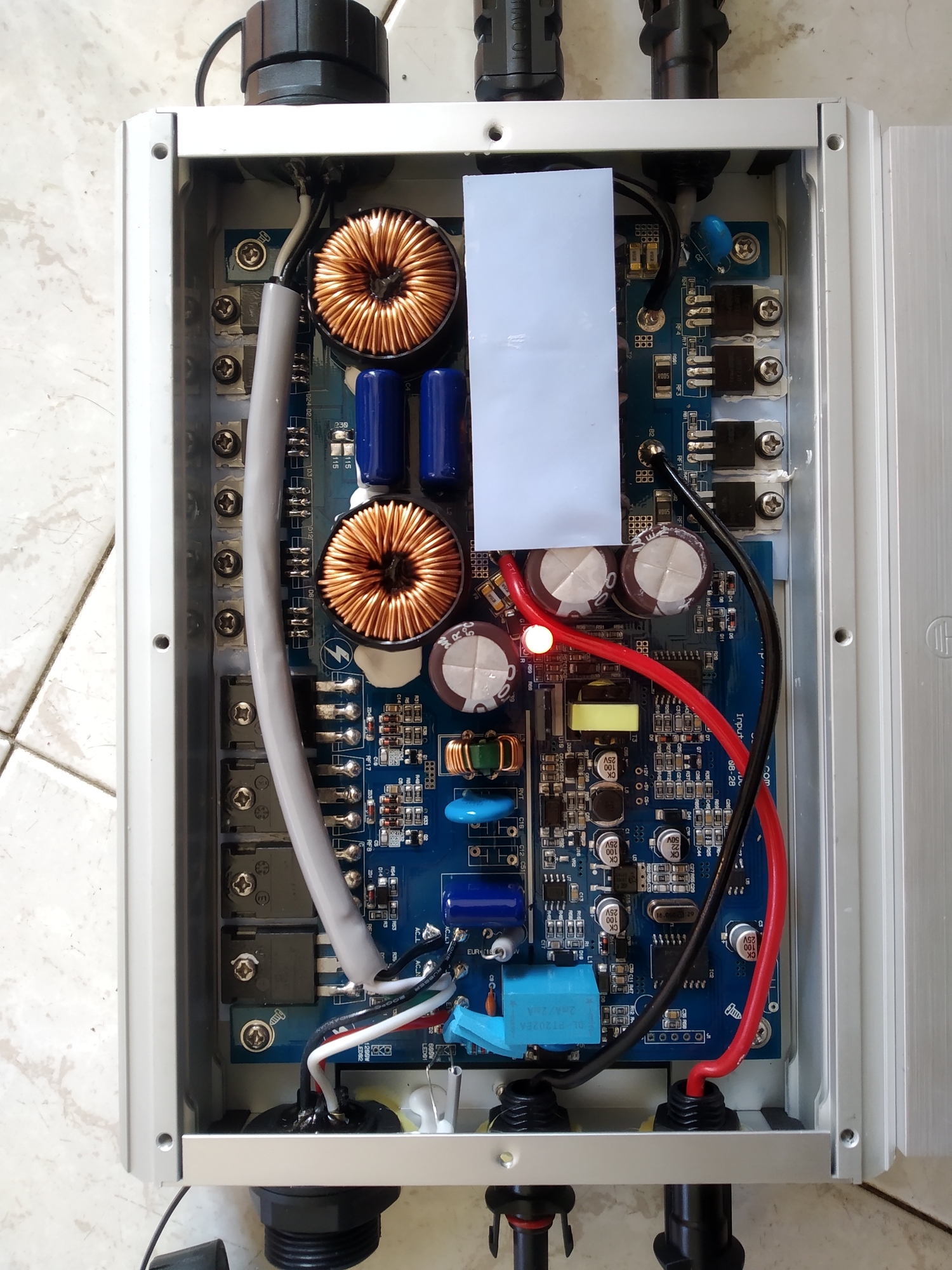

Hi everyone, I am really pleased to find this discussion. I have bought a standard WVC600 without the 433 MHz transmitter but only with Powerline transmission. Since I don’t want to deal with mains, I opened my inverter and found an UART header. To implement your work I would like to add an ESP8266 to control the inverter. The main issue is that my inverter has no ID printed anywhere… Is there a command to look up the inverters connected?
I would also ask you if you can kindly provide a pinout for this UART.
since it all built on the board, and I added esp to powerline devices before to devices ( TED1000) you need to look up your powerline IC then determine which one are its RX/TX
then follow the trace to its endpoint as the UART you found might be only for programing the PIC – you need to be careful

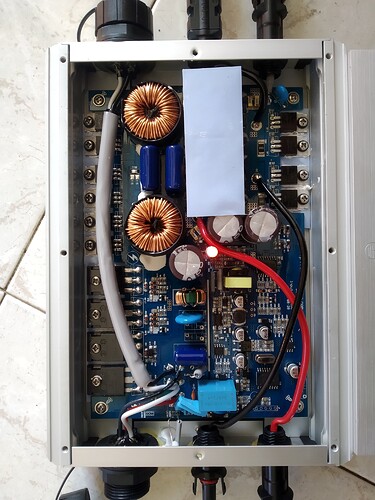

take a full picture of the inverter board layout

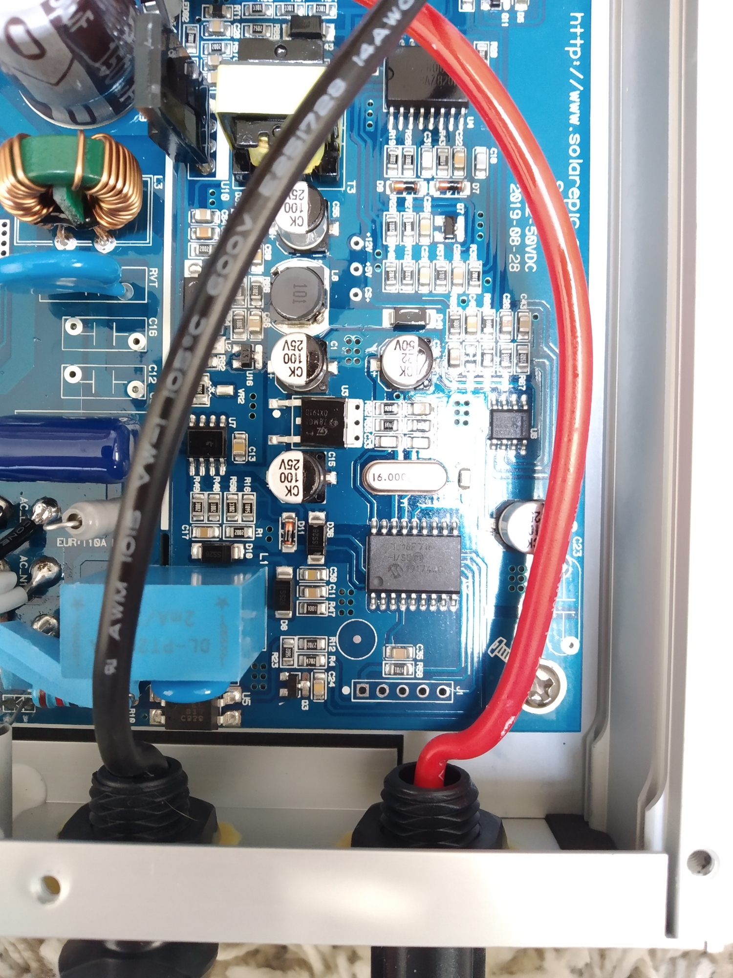

On the manual it is specified that has power line communication @300bps and TTL serial @9600bps. The board is made by solarepic.
well what are the the name and numbers on the two largest chips
The one near the header is PIC16F716, the other one is ucc2806dw from TI.
The pinout of the header port is (referred to pin of pic MCU):
PIN4 (pull up)
5V
GND
PIN13
PIN12

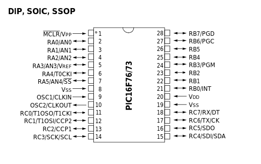

nope the pic the little micro controller the other voltage regulator and the blue thing is precision transformer-- what else doses it have - what are the the smaller chips with – i think if it does you must have the transceiver
is PIC16F716 correct as that one does not seam programmable are you sure it not PIC16F76 like what is on my inverters and modems chip
