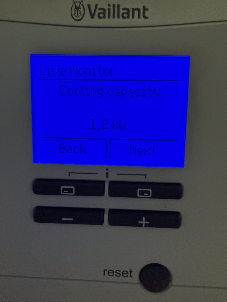

On my 5KW Arotherm, the return temp sensor is reading 0.6 deg C higher than the flow temp when the compressor has stopped and the pump is running at the reduced speed.
When the compressor is running at 25% modulation, the maximum “Cooling capacity (Heat output?)” I see in the Live monitor is 1.2KW and the DT between flow and return reported in the wall unit confirms the same around 1.2 deg DT.
I’d expect to see the minimum rated output around 2.2KW and a similar 2.2 DT between flow and return temps.

I dont have MID meters. Would anyone with a 5KW Arotherm and metering be willing to check their Vaillant wall unit Live monitor “Cooling capacity” when stablised at 25% modulation and compare with their metered output.
Any thoughts or comments are welcome. I’m trying to understand the low COP, also if the erratic stabilising behaviour at minimum modulation is normal?

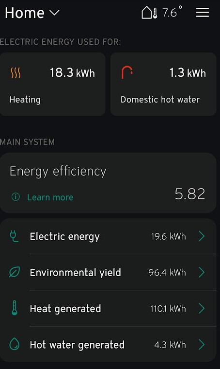

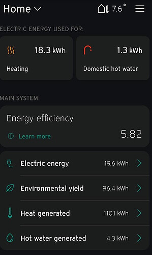

Someone burst my COP bubble this morning and said my COP is highly likely incorrect, and far too high.
The below screenshot is for November 19th, lowest temperature was 3c.
This is for a 170m2 house, mostly built in the seventies, Arotherm 7kW Plus, 0.45 WC, Active room modulation set at 20.5c, no set back.
I have Shelly power monitoring, that reports 18.96 kWh for the day, I also have some Shelly temperature probes attached (paste, tin foil and stainless steel tie wraps all under insulation) to the flow and return pipes. These sensors are about 5 meters from the heat pump, flow currently shows 30.4c whilst Valliant shows 31c, but where can I find the return temperature in the Vaillant system, as I can’t seem to find that??
