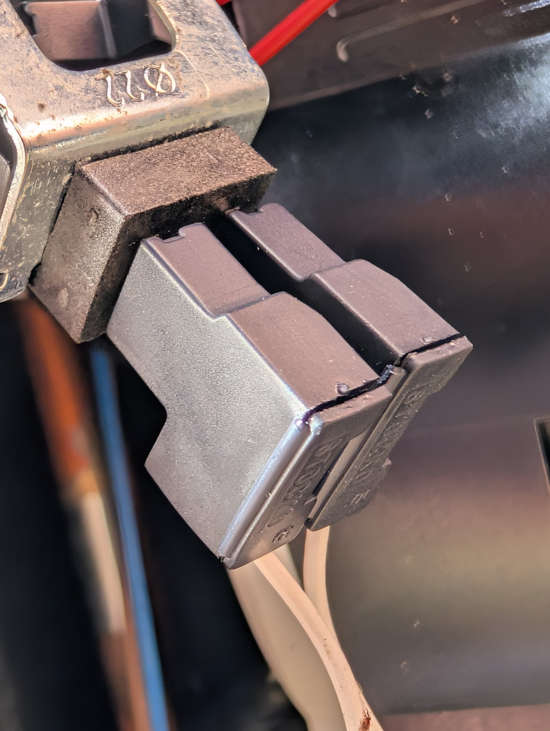

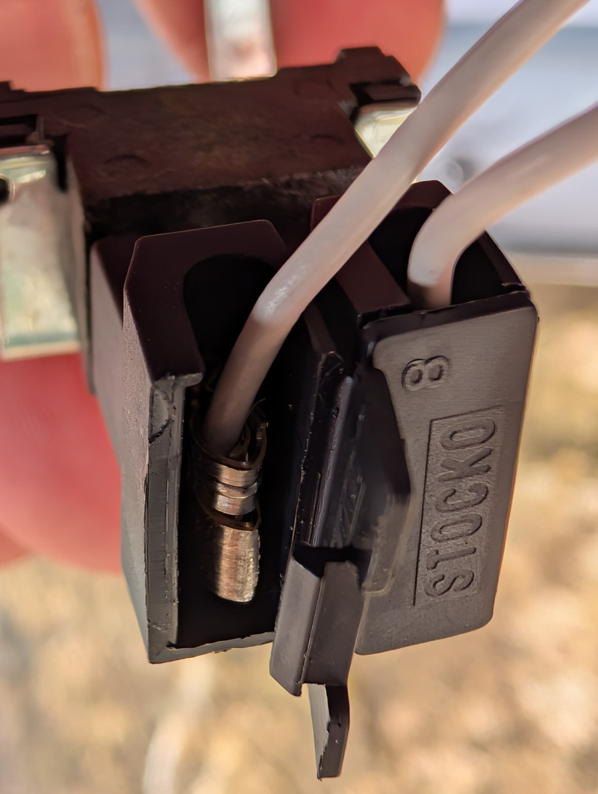

Andre, you changed your temperature sensors didn’t you? How do you remove the wires from the sensors? I’d like to swap mine around, but can’t get the connectors undone. I don’t want to break anything through force…
Photos of said connectors in case anyone else knows:
I did - as far as I remember there is a simple 2-pin contact at the sensor that plugs into a socket on the cable. I just pulled them off - I don’t remember having any issues there but they might require some force.

I’ve now swapped them around (levered the connectors off with a flat-blade screwdriver) and will now watch my COP plummet :grinning_face_with_smiling_eyes:
Edit: I should have powered the outdoor unit off before swapping the sensors (I’m not sure how to do that though; just turn the rotary isolator? Throw the circuit breaker?) because the compressor didn’t want to start up afterwards. There were two sensor faults in the fault list in the installer menu on the VWZ AI; deleting them cleared the problem.
